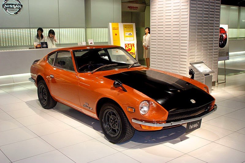

Any specifications on the rims that were used on the various Works cars?
In both dirt and tarmac events?
Pictures of the various types?
Above pic looks to be a alloy type rim, with an amount of negative offsett
What tyre sizes were used?
Gav mentioned a brand/style of a rim recently?

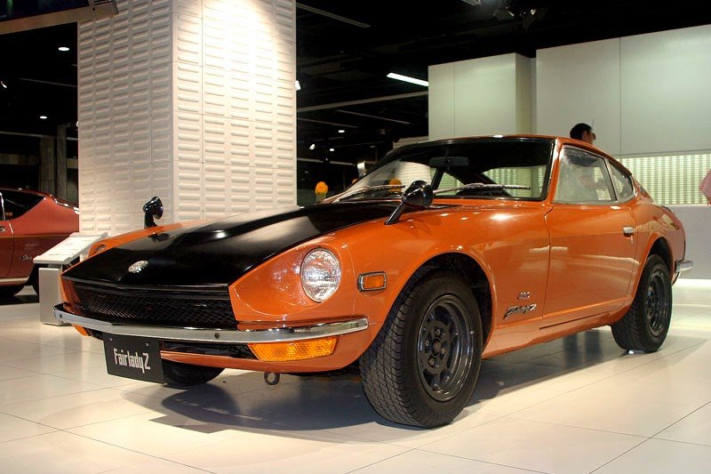

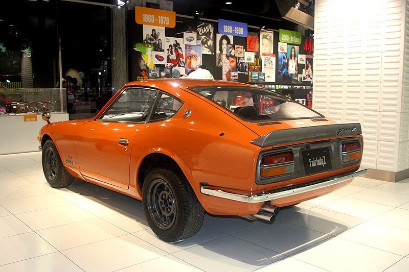

Well.... maybe not. I believe the 432-Rs (PS30-SB) cars were fitted with Kobe Seiko wheels or at least had the option? As to what sizes I don't know? But... I'm lead to believe from what I have researched that the 432-R was not available to the public directly, rather it was available to privateers? Not joe public..
I don't know if that is where the rules get rubbery or not? A few reference photos of PS30-SBs (not sure if Genuine) but look legit.

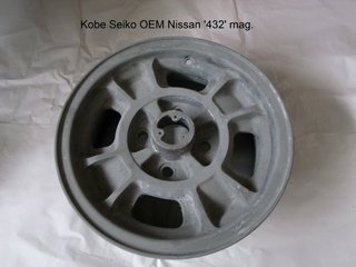

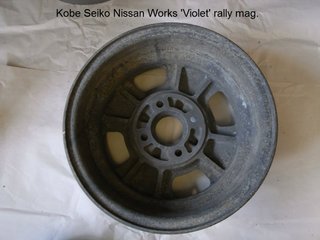

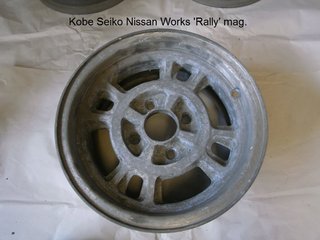

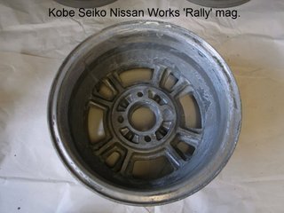

This thread is turning too busy for me. It's going to be like herding cats before this page is out I fear. We are already discussing the different shades of upholstery fabric used on Ikeda Bussan seats (for the record Gav, there were at least four different shades ranging from light blue-grey, mid blue-grey, dark blue-grey through to dark grey...).

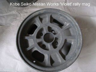

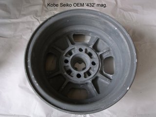

I went up into the loft and pulled some wheels out to photograph and measure. Not that it'll do any good, because this data "has to come from Nissan" (and I am back to square one wondering why the people who need the data "from Nissan" aren't in contact with Nissan and asking for it from Nissan...) but what the hell, eh?
Hopefully the captions will be self-explanatory:
Gav,
Look, it's really simple. I'll try to explain it for you as succinctly as I can:
Standard wheel fitment on the 'PS30' Fairlady Z432 was the 5.5j x 14" Kobe Seiko '432' magnesium wheel. It's easy to spot them as they had a raised centre casting which carried a cap secured by two screws. See photos above.
Standard wheel fitment on the 'PS30-SB' Fairlady Z432-R was the 4.5j x 14" TOPY steel wheel. The cars were supplied with these because customers were expected to fit race wheels (and - more importantly - race tyres) of their choice. You'll see pictures of Nissan's most famous works 432-R (the no.68 race numbered car which was the first S30-series Z to take part in competition anywhere in the world) running on the 7j x 14" Kobe Seiko Nissan works 'Rally' mag wheels. They used these for a couple of races before they switched to the 8j and 10j x 14" Kobe Seiko 8-spoke mags as seen in the Sports Options lists, to be combined with the just-homologated works and Sports Option 432-R overfenders.
If you see photos of 432-Rs running on the KS works Rally mags then they are - like me - just copying that no.68 race car and the couple of cars that also raced on the Rally mags in period. The Rally mags were not standard or Option equipment for the 432 or 432-R....
Kobe Seiko made - at Nissan's request - a version of the '432' mag to be used on the works Violet rally cars. It's similar in casting design to the '432' mag, but it didn't have the raised centre for the wheel trim cap. These were never sold to the general public. See above photos.
Nissan also asked Kobe Seiko to make a special wheel for the works 240Z rally cars. Size was 7j x 14" (with some super rare early ones in 6j x 14" for use in snow). It was similar looking to the '432' mag, but actually a fundamentally different casting design. Compare the photos above, paying close attention to the shapes of the 'spokes'. It's not just that the 'spokes' are open on the rally mag and closed on the 432 mag. It's much more than that. They are completely different patterns. These wheels were never sold to the general public.
Lastly, when all the fuss had died down in the early 1980s, Kobe Seiko revived the '432' wheel design and re-jigged it slightly. They called them the 'Maglloy' (note the double L) and sold them to the general public. They can still be found used. Nice wheels, super light and excellent quality.
If there's anything I haven't explained properly, please ask again and I'll try to clarify...
