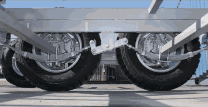

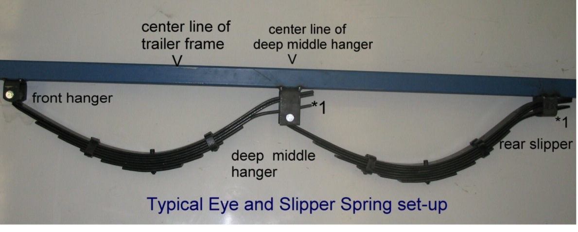

Big difference between slipper leaf non load share, and rocker load share, on a tandem axle trailer.
The slipper type, when, say, you get it up over a driveway, at an angle, can lift a wheel, or a whole axle, thus putting maximum loading onto re,aing axle, ie overload, and these can bend/break.
The load share ( centre rocker arm pivot ) type, will keep all wheels in contact, this sharing load more evenly.

Gidday
The rocker (or loadshare) is a pivot between front and rear axles that pushes one up when the other other goes down. Where as in a slipper set up if one goes up the entire trailer lifts resulting in a lift in the other wheel. This results in uneven load share.

Thanks PB, those pics really help explain it. I had incorrectly assumed it was referring to the way the arm was connected to the car, and that the weight was neutral with a tandem trailer.
No worries, happy to help.
If set up well, towing doesn't need to be a chore.
