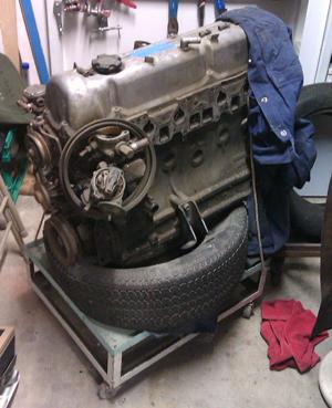

Pics 1&2 Got motor out from its "temporary" hiding spot.

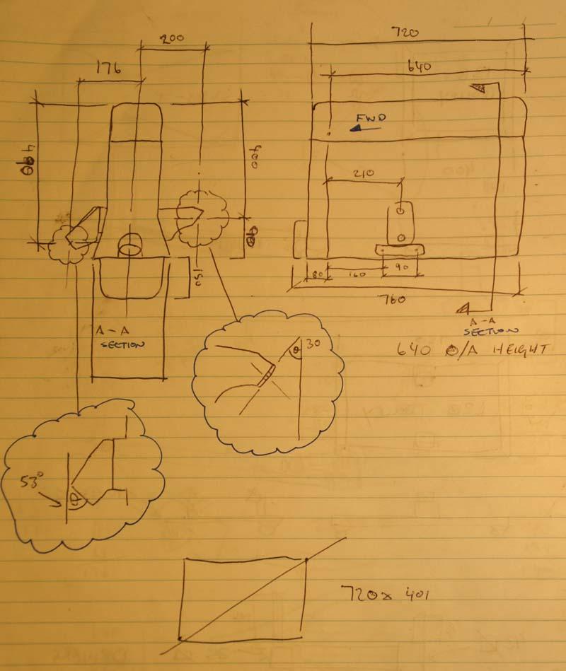

Pics 3 Spent a couple of hours drawing up dimensions of, width, height, length, mounting bolt centres, mount angles and most overall dimensions from the block.
Researched weight of long block...160-180kg?
Pics 4 Found scrap tube, bought castors to suit weight, and drew up base frame to suit desired sump to floor clearance, and the irregular offcuts that was going to be used.

Looks good but I would recommend larger dia castors for easier movement.
These cradles can be used to hold the engine/gearbox while an S30 body is lifted off.
