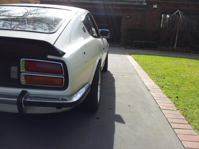

I run 15x8 -3 on 225/50 on my car with stock guards and beside from the occasional scrape they fit fine:
Posted Image
Posted Image
Not the best photos sorry, if I get a chance over the weekend I'll duck down to the garage and snap some more side on photos

You can fit a 9 +/-0 on the rear of a zed, with some bodywork it won't fit all that bad either
Posted Image
