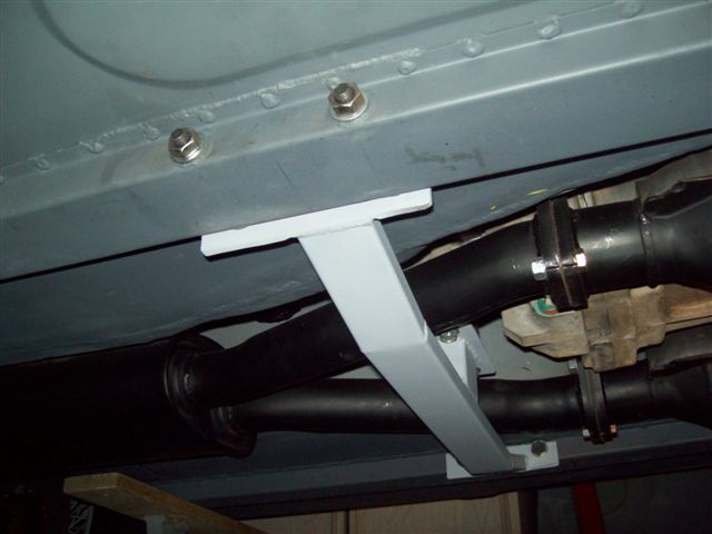

I agree with Lachlan that the structural integrity is highly dependent on the sills rather than the rails. However, every bit helps and one advantage of full length rails is that you can create fixing points to tie them together at the rear (and the front), i.e. create a ladder structure, rather than use the standard Datsun bolt-on rear control arms cross-brace. It also gives you more options for alternative diffs.
I regret I didn't do it, but, I did create fixing points for a new gearbox mount which will give you some idea of the sleeve type fixing points I'm suggesting. I also ran an extra bit of weld securing the rails to the floor in that area.

Agree about the importance of the sills, when my 260Z was built nearly 20 years ago the sills were reinforced right along and then tied into the engine bay mmenbers. As far as the rails go, the 280ZX was built by the factory with them going right through to the back, probably one of the reasons why the S130 chassis was stiffer than that of the S30. A stiffer body is a quieter body too, less noise from drumming etc.
