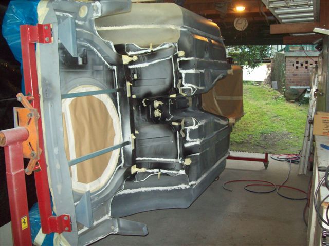

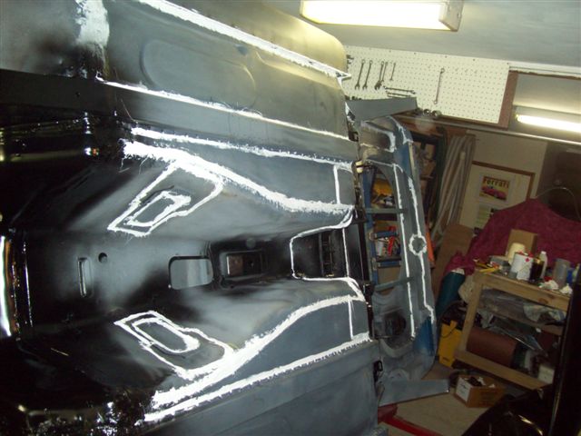

I bought the last set of full rails from Nat0 (I'm lead to believe) and am having them fitted by Andrew from Trackart.
He has posted a series of photos showing the work in progress.
For anyone interested you can find it here...
https://www.facebook...6695933?sk=wall
cheers,
Sinisha

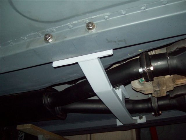

#57 nat0_240_chevZ
nat0_240_chevZ
  • 834 posts
  • Location:Adelaide
Posted 13 September 2013 - 04:13 PM
Thanks Sinisha,
yes the last set, Well available set anyways, as the LAST set is going on mine....
Please pass on my thanks for the pix, to Andrew from Trackart.
I look forward to the final pics of the job.
so far so good, let me know if you require any more, or need engine bay rails.
Are you also getting the Gearbox crossmember mounts reo'd similar to gordon?
cheers Nathan

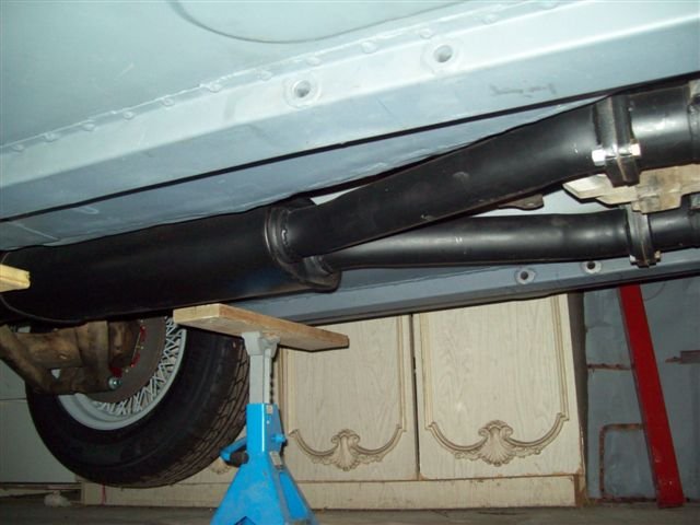

#58 redrbzed
redrbzed
  • Donating Members
  • 246 posts
  • Location:Melbourne
Posted 19 September 2013 - 10:32 PM
Hi Nathan,
The job is done, along with a few other bits.
No I didn't get the gear box mount done, I don't have vibration issues with my car, although I did have floor flexing above the diff issues under full power in the first 3 gears.
To fix this Andrew tied the floor to the roll cage above the diff. I also had a proper race seat mounting setup made. he tied the castor rod brackets to the outer chassis rails as well.
You can see all the bits at the following link.
cheers,
Sinisha
