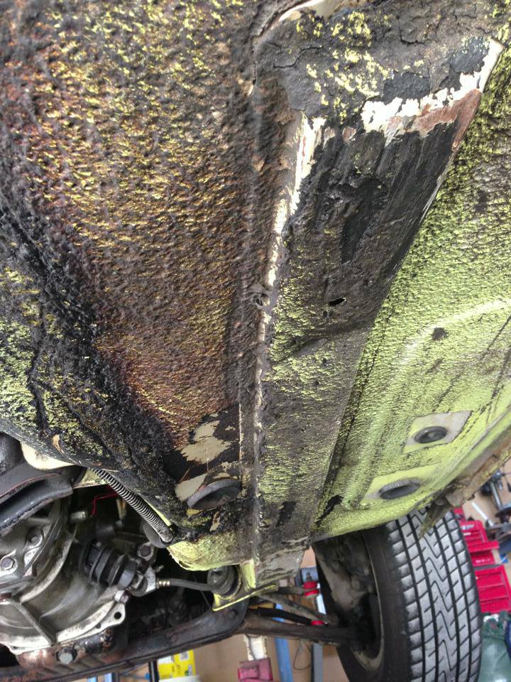

Good stuff, i'll be after a set for sure. Will the ID of your rails allow welding over the existing rails or will the originals need to be removed?
Hi bud, currently they are to suit total replacement(remove and replace)
however I can widen the rail to facilitate a 'CAP' type install, although you are just creating a safe haveven for rust to tear through the new ones,
OK yes you will probably get another 5-15 or so years out of these ones, possibly more depending on moisture and exposure,
My recommendation is replace completely, old rails are usually squashed an bashed about a bit anyway so fitment would not be an IDEAL slip on/over the old ones. A BFH will be req'd
Youd be suprised what lurks inside your existing rails or box sections, thats if there is anything left.
260z rails are different and alot taller / deeper, although ultimately would be another Type/model ill have to finish developing for sale, not a massive problem but valuble time none the less.

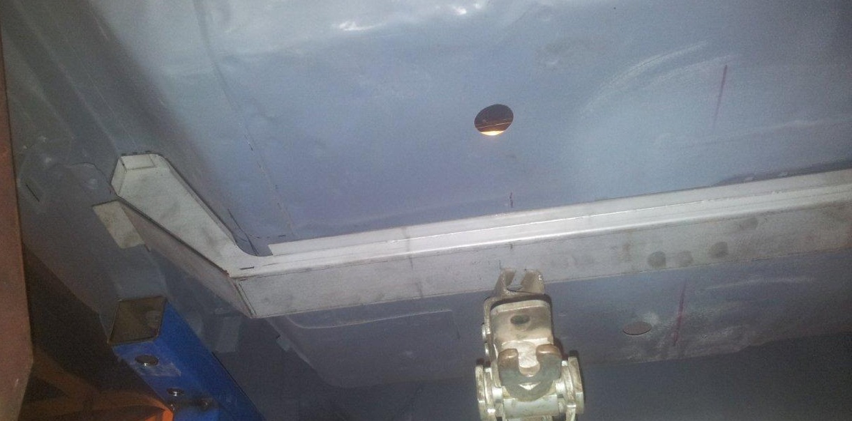

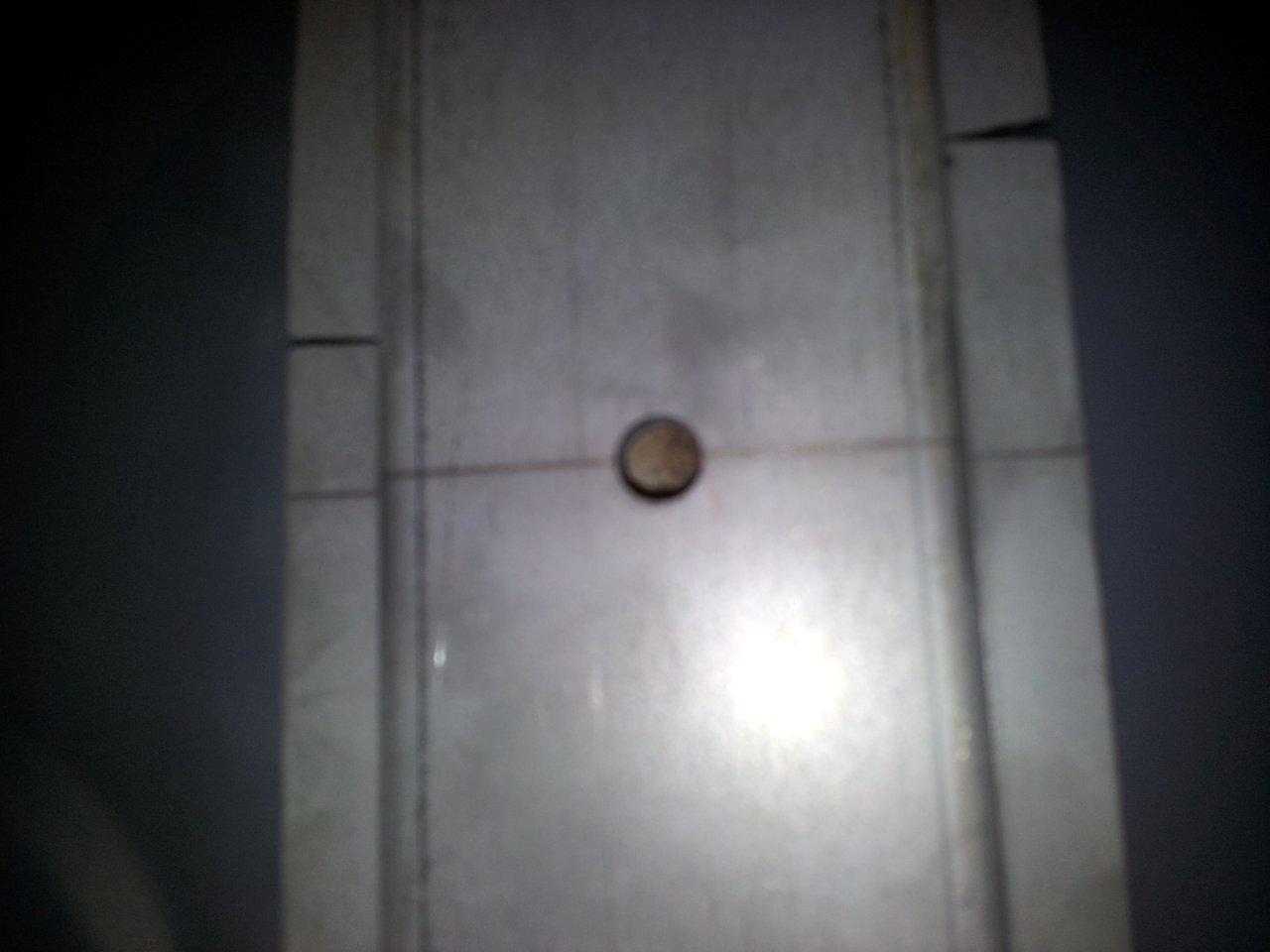

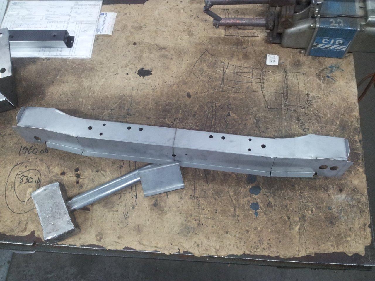

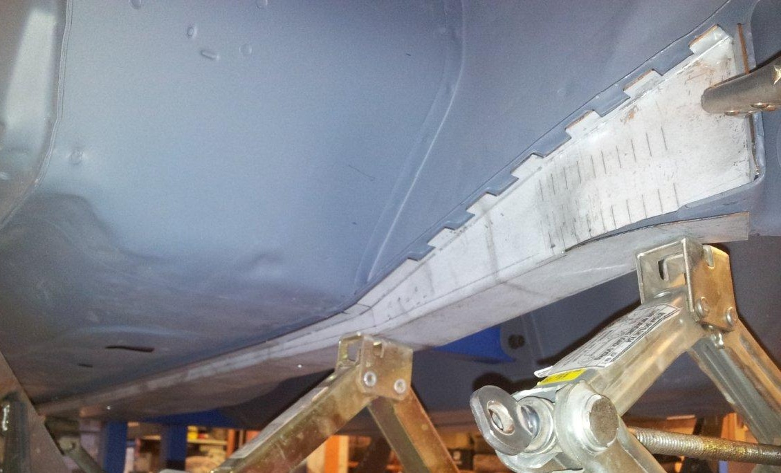

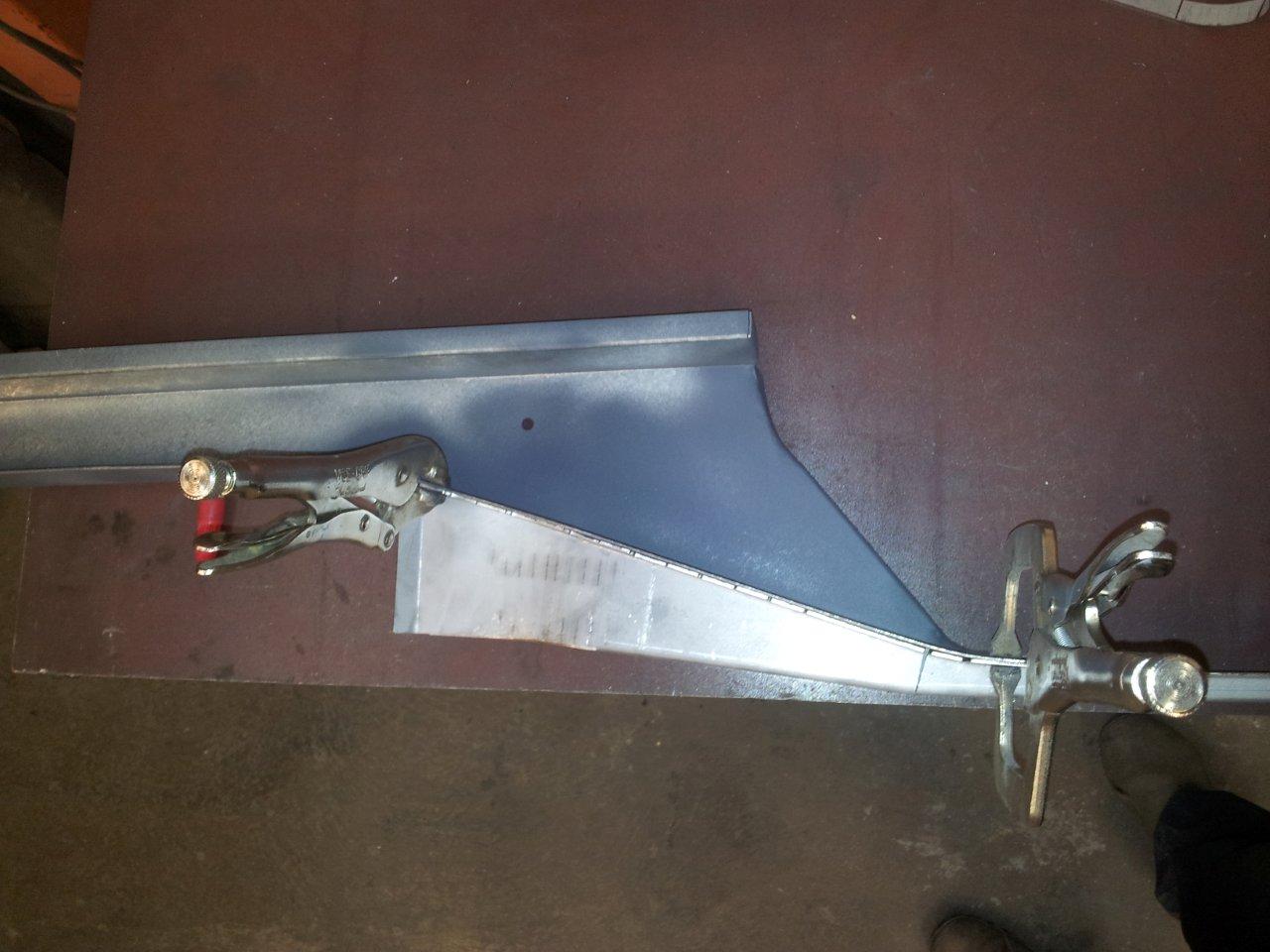

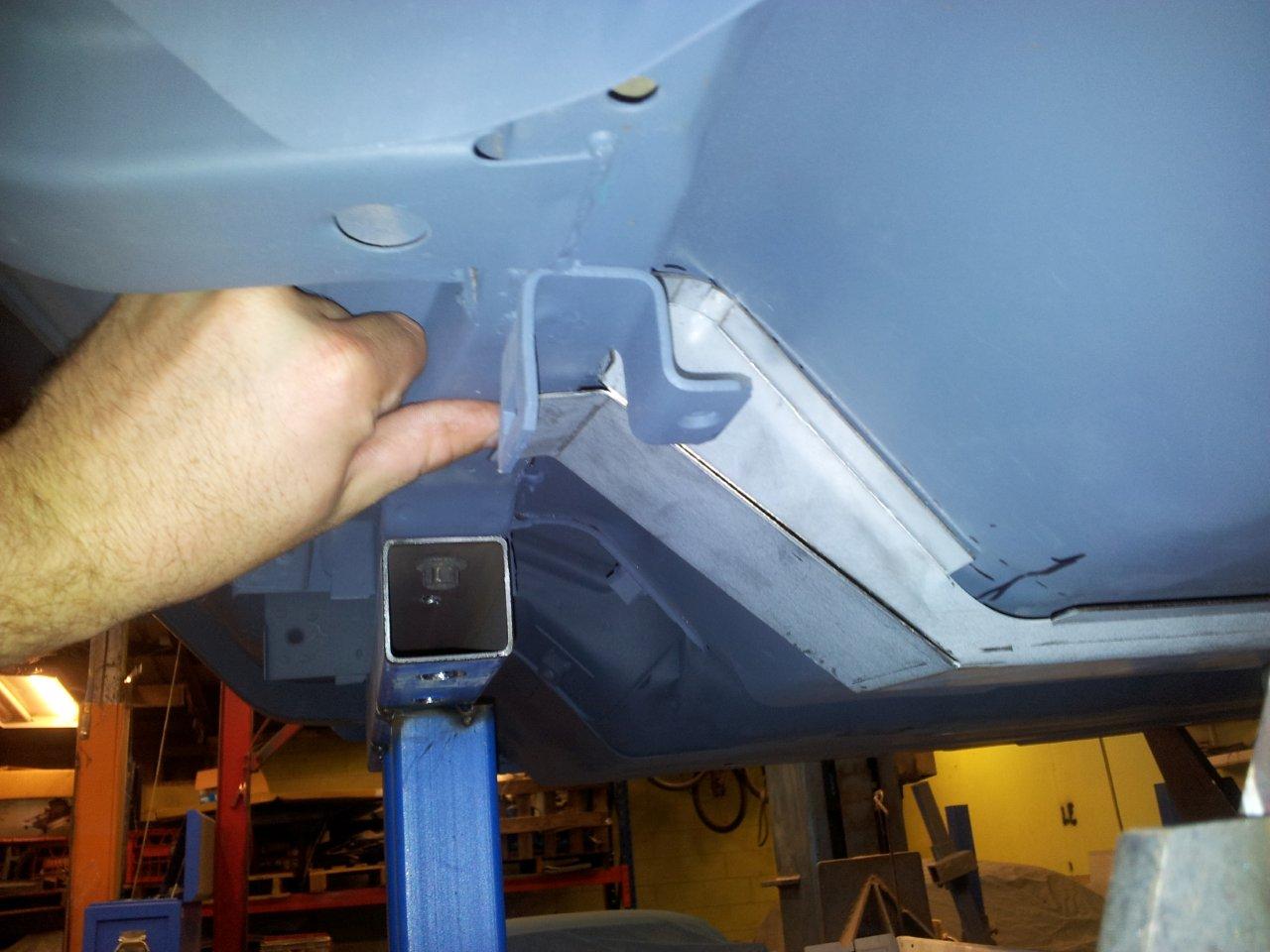

some teaser pics of the rear floor rail -> rear subframe connectors,
still have 1 or 2 more tweaks, but what you see will ultimately be what they will finish up like.
the area around the radius on the floor will be filled in and main joint/edge visible will be welded and finished to look like a bend.
no holes will be added, i would suggest to mig stitchweld these on for ease of installation.
This is ONLY the rear section shown, my floor rails will have this included on the rear part of the 'Full length' floor rails,
from what you see->the back of the TC rod mount.
any q's let me know.
nat0

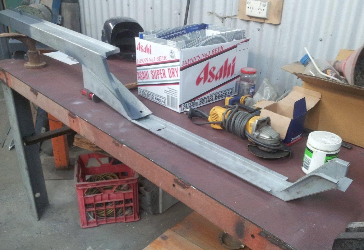

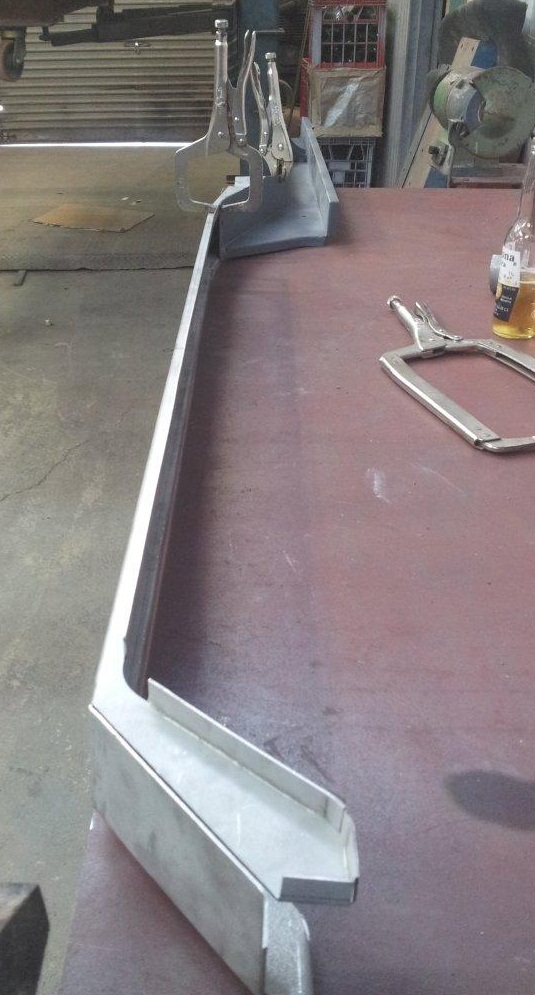

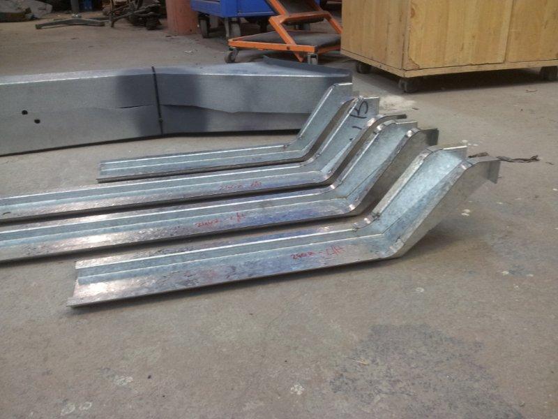

floor rail update.....
lookingood, just 1 last change.
PS dont worry bout the red circle, missed the bendline on this mockup item.
nat0

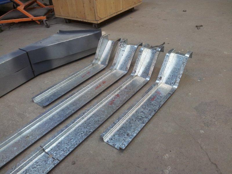

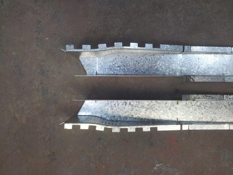

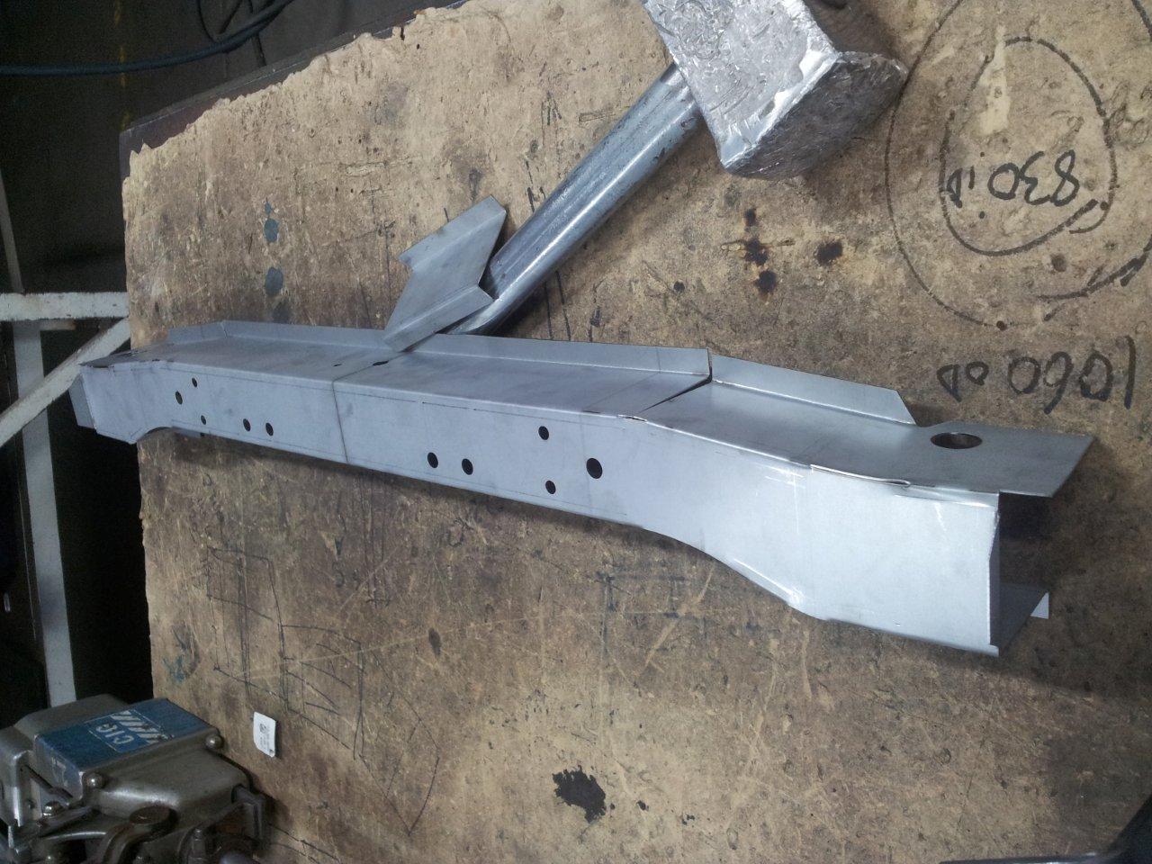

ok, an update for those interested.
Full length floor rails including rear connectors are NOW completely developed,
first pair came up great.
see pics below. but i will/ should probly start another new thread...
ANY Questions probly best to PM me,  as to try and keep this thread clean. (-er)
have plenty of pics on and off the car and mocked up on the bench with my Front engine bay rails.
for those that have asked about capping rails( although im not a supporter), these ones pictured are infact a slip over just so
I could get confirmation of the shapes, profiles and agles, actual one that will be available will not be.
Like Peter has said before the rear connector area is a pain to developan that it was, with the front of the floor rails coming in a close 2nd.
Those of you, that want more pics shoot me your email.
I know some of you have been patiently waiting.
cheers for the supt til now.
Nat0

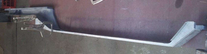

more pics of same mock-up / trial fit.....

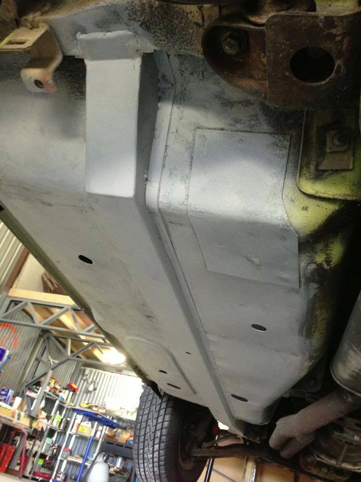

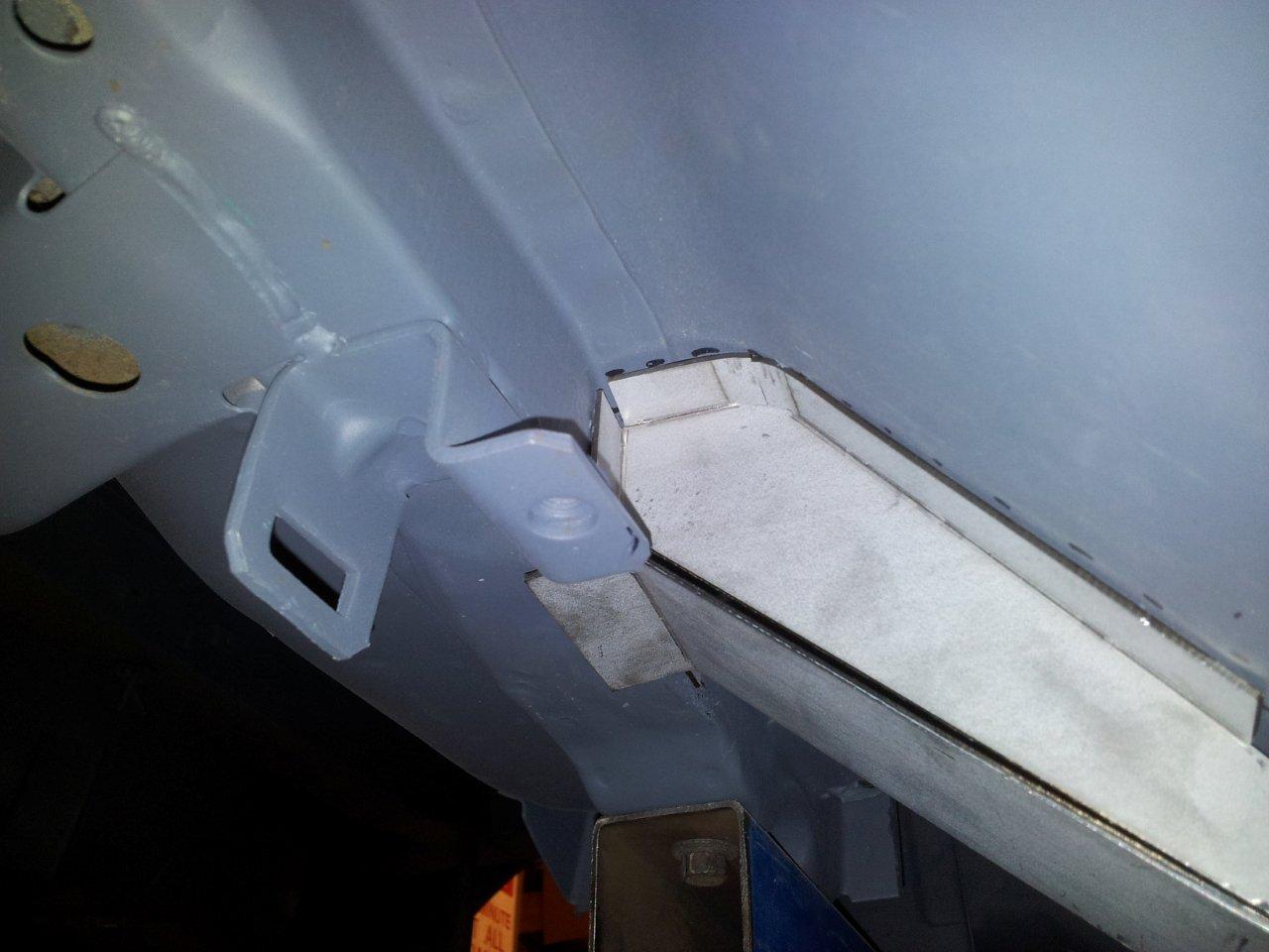

c'mon how factory do they actually look?
Please Note!!!! all factory tooling and jigging holes as seen on your stock mangled/rusty rails,
all come out in the exact spots / factory positions as original ones do.
these replacement rails can be installed by any competent general panel shops with car jigs and aligners etc. or make a pro-restorers job a bit easier and save some time.
No welding will be done on these obviously some-welding of the missing corner flanges, as the installer will need to hammer/clamp flat and close up gaps before welding,
to suit your floor and whatever shape you're car is in, as they have been beaten and battered of many years.
If you're changing or thinking about changing your floor pans, this is what you will also need,
want the full length and extra strength of the rear connectors, running big torque engines.
Now onto the lower radiator supports and then maybe long &/or short nose diff cradles to suit s30'Z
