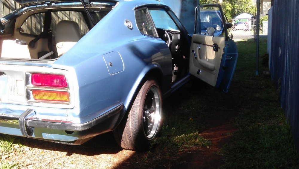

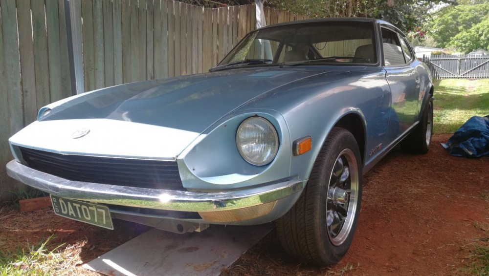

Hi All,
I bought this off a young bloke in the local Datsun community a few months ago, as he had (for want of a better term) fallen out of love with it after a minor front end accident.
I bought it sight unseen for a reasonable price, but when I picked it up I found a few more issues with it than I anticipated... ::)
Anyway,  Plans are to:
- Repair all the visible rust - mostly concentrated around the rear of the vehicle. Strangely the boot floor needs repair - probably because of a stuffed hatch seal.
- Repair the front end - it has pushed the 'noses' back & downwards & shifted the radiator support panel. However I have access to a Chassis puller, so it won't be much of an issue.
I also have spare guards, sugar scoops, bonnet & bumper for it.
- Respray in the original factory light blue & clean up the black interior.
- Convert it to manual transmission as it's a factory Auto car. I have a spare 260Z box that I'll rebuild with new bearings & convert it to brass syncro's.
- Give it a tune up & get it into RW condition.
I've already have a newer member of this forum come & inspect it, who has shown an interest in purchasing it - they can make themselves known if they wish.
As such I probably won't get much of a chance to drive it!
Annnnnnnd on with the photos!:

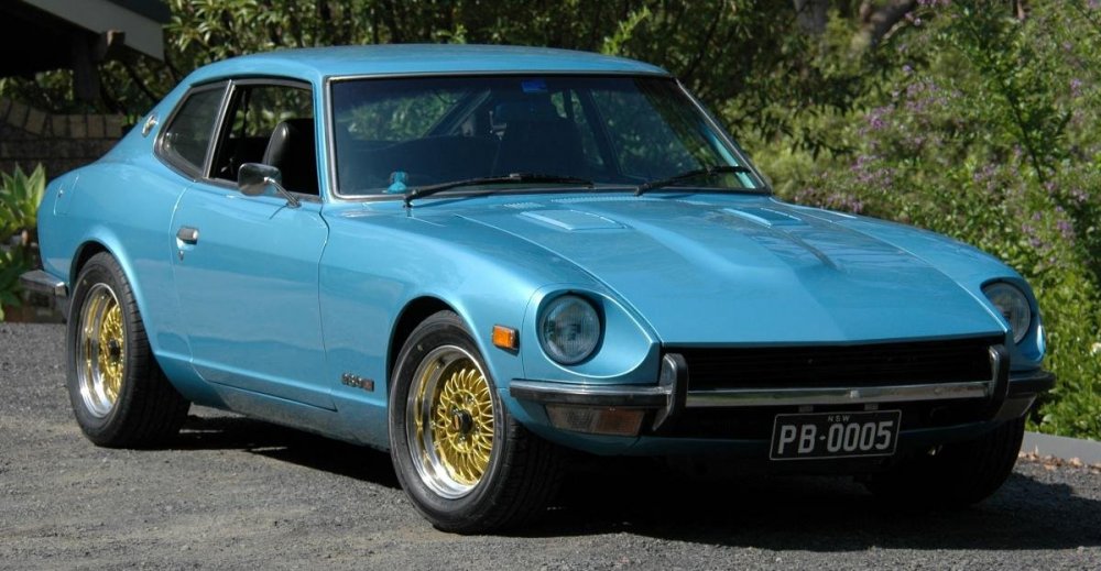

#10 Brabham
Brabham
  • 1,041 posts
Posted 21 September 2012 - 11:32 AM
Hi Lurch,
looks nice, mine is the same color and is a 77. What is the chassis no.? I would be interested to see if it is close to mine. Cheers
