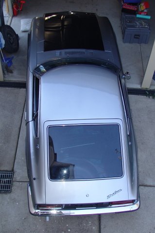

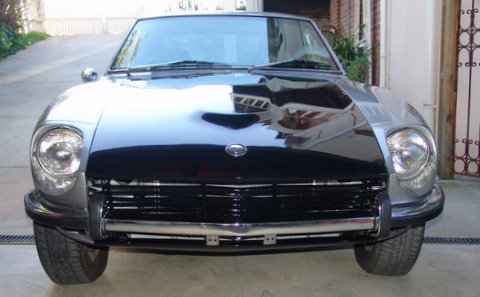

Here are some shots of the wheels and the fit in the front wheel well.
As for living in Gundagai, we are known as 'blow-ins', as we have only lived here the past six years.  Nice country lifestyle though - drop a  note if you are passing along the Hume Highway (usually at 125 KPH).  Cheers, Paul

I just want to say your car looks absolutely drop dead gorgeous. A front air damn may be a suitable alternative if you are adverse to cutting the front valance for wheel clearance (I know I would be).
