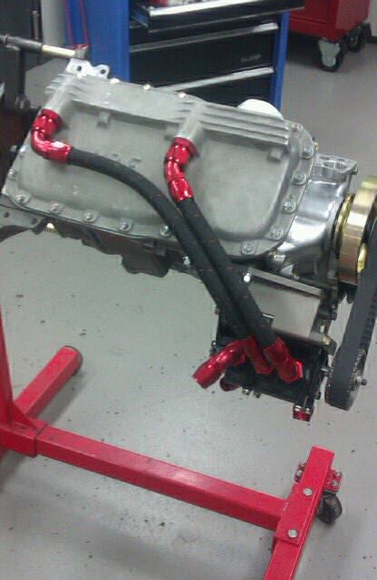

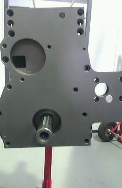

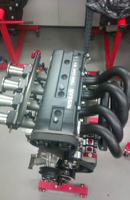

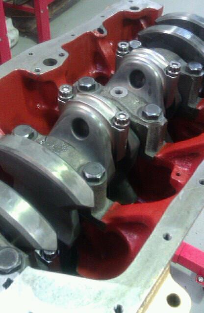

#45 peter mc
peter mc
  • 1,573 posts
Posted 11 February 2013 - 09:00 PM

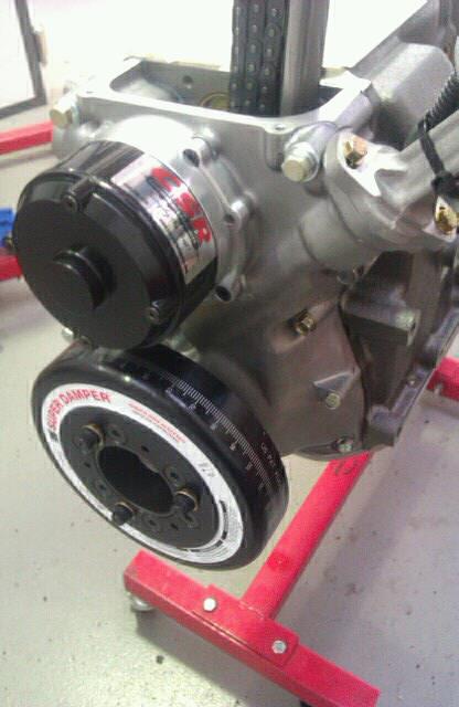

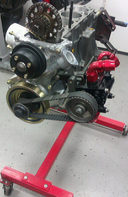

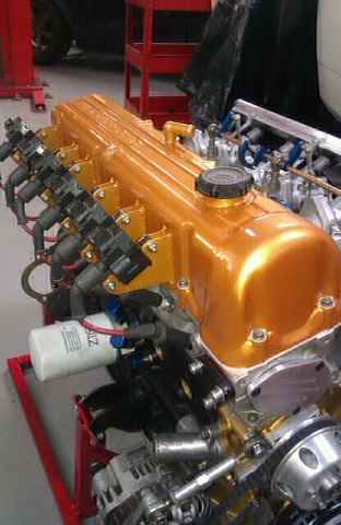

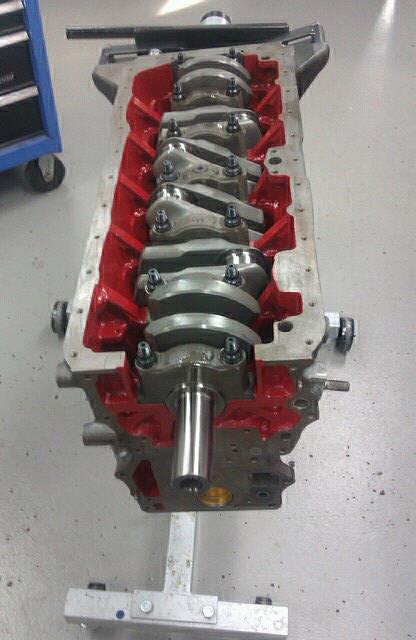

some pics off L motors from the shop in the last 2 month's

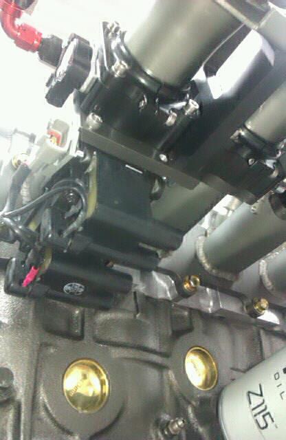

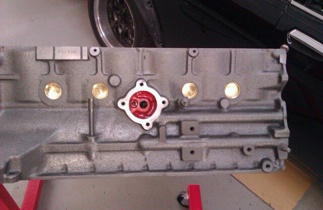

#46 peter mc
peter mc
  • 1,573 posts
Posted 11 February 2013 - 09:05 PM
I have 9 engines on the go so its been hard to get on the forum , been working 7 days a week since Christmas

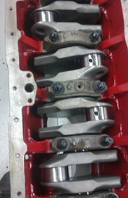

Hope you didnt use the rods in the top pic, the bottoms appear to have broken off!  :o

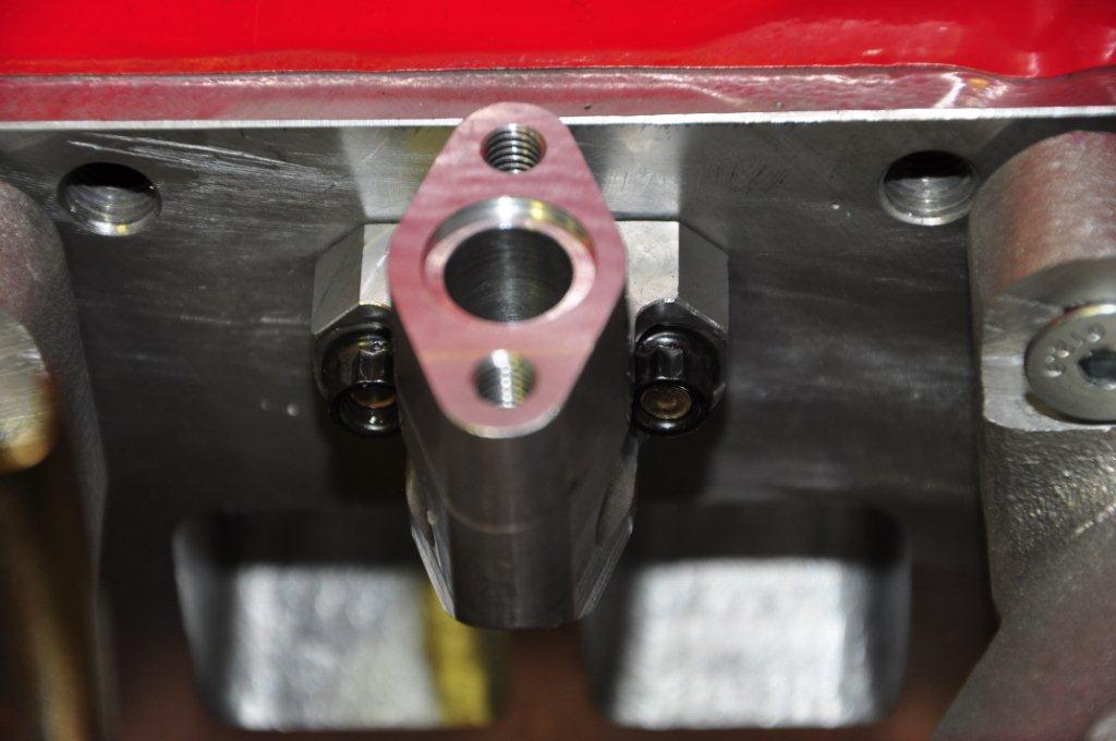

Posted 04 June 2013 - 03:45 PM
I like the external water pipe, years ago I talked a mate into doing that setup on his turbo motor because the previous engine had lots of damage to the head from excessive temps around the chambers. We modelled it off the pictures from the crossflow L head (or was it an FIA head... can't remember).  As an example of how bad the head had been corrorded, the return feed to the water pump near No.1 spark plug had about 1mm of metal left.  Probably a combination of pump cavitation and nucleate boiling around the exhaust valves.
