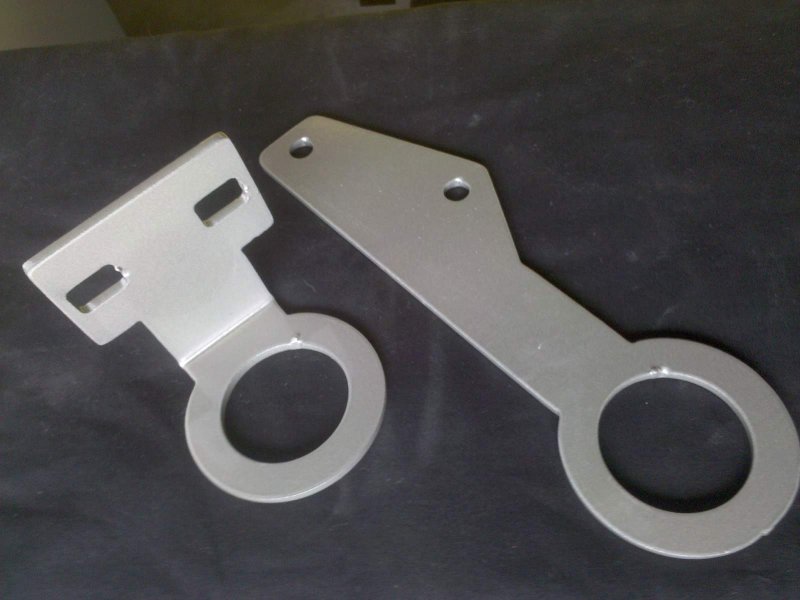

#33 Lurch ™
Lurch ™
  • 5,691 posts
  • Location:Victoria
Posted 30 April 2013 - 09:17 PM
I know I'm dragging up a bit of an old thread, but would anyone be interested in buying a set of tow points from ZCCJDM?
I emailed Brian and postage was going to cost more than the tow hooks are worth, so if I can split the postage with a few people that would be grouse!
Posted Image
Those would be SOOOO simple to have lazer cut & bent locally...
#34 Agno
Agno
  • 1,334 posts
  • Location:Melbourne
Posted 30 April 2013 - 09:31 PM
Yeah I know. I could ask plenty of mates to do it for me, it's more the amount of effort I wish to expend to make it happen. Much easier to wave a credit card and get something in the mail sometimes :P
