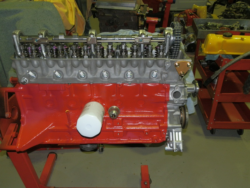

Gordo Posted May 7, 2012 Share Posted May 7, 2012 Looks good Peter. My hands are getting sweaty just looking at the pictures. Quote Link to comment Share on other sites More sharing options...
peter mc Posted May 7, 2012 Author Share Posted May 7, 2012 its coming up real nice gordo iv taken great care to make all clearances exact it will be a dam good thing when its finished Quote Link to comment Share on other sites More sharing options...

Riceburner Posted May 8, 2012 Share Posted May 8, 2012 Looks the goods Gordo! What sort of power are you anticipating, is it 2.9L? Quote Link to comment Share on other sites More sharing options...
peter mc Posted May 8, 2012 Author Share Posted May 8, 2012 yes Gareth its 2.9 and comp is set up for 98 fuel power we will find out soon .... Quote Link to comment Share on other sites More sharing options...
luvemfast Posted May 8, 2012 Share Posted May 8, 2012 yes Gareth its 2.9 Would 89mm bore be closer to 3.0? I though 88mm was roughly 2.9 Quote Link to comment Share on other sites More sharing options...
d3c0y Posted May 8, 2012 Share Posted May 8, 2012 You're rounding up and PMC is rounding down - 2.94L Be interesting to see the dyno numbers vs mine. Well be a very good indication on what the stroker kit gives you. Quote Link to comment Share on other sites More sharing options...
peter mc Posted May 8, 2012 Author Share Posted May 8, 2012 we will find out next week wensday both engines will be on the dyno Quote Link to comment Share on other sites More sharing options...

Riceburner Posted May 8, 2012 Share Posted May 8, 2012 Whats the reason for the spray bar and solid cam? Quote Link to comment Share on other sites More sharing options...
peter mc Posted May 8, 2012 Author Share Posted May 8, 2012 N42 head and gordo wonted it like that ... id not go this way normally , internal is the way to go for shore Quote Link to comment Share on other sites More sharing options...
d3c0y Posted May 8, 2012 Share Posted May 8, 2012 Yeah we went over the same thing with my engine because that's what i read but decided to heed the advice lol. Quote Link to comment Share on other sites More sharing options...
620Z Posted May 8, 2012 Share Posted May 8, 2012 Looking nice Peter. Gordon will be chomping at the bit to take this for a drive down at the Island. For us lay people or V8 munga people. Can you explain the solid cam vs internal set up. Are we talking vs a roller cam? Quote Link to comment Share on other sites More sharing options...
d3c0y Posted May 8, 2012 Share Posted May 8, 2012 One is lubricated by an external spray bar on the cam towers and the other has internal oil galleries (in the cam itself) and lubricates through a hole in the cam lobe. Quote Link to comment Share on other sites More sharing options...
620Z Posted May 8, 2012 Share Posted May 8, 2012 OK thanks for the clarrification. I understand now. Quote Link to comment Share on other sites More sharing options...
luvemfast Posted May 9, 2012 Share Posted May 9, 2012 Spray bars should be strengthened to avoid failure from vibration. Are you taking proper precautions Peter? Quote Link to comment Share on other sites More sharing options...
peter mc Posted May 9, 2012 Author Share Posted May 9, 2012 ahhah i always use protection Simon and its a new oil spray bar Quote Link to comment Share on other sites More sharing options...
PZG302 Posted May 9, 2012 Share Posted May 9, 2012 Peter, is there any advantage/disadvantage to using both the spray bar and the internal oiling of the cam? Quote Link to comment Share on other sites More sharing options...
luvemfast Posted May 9, 2012 Share Posted May 9, 2012 Peter, is there any advantage/disadvantage to using both the spray bar and the internal oiling of the cam? Would it be possible to run both? The oil galleries come up the towers to go either - - through cam - to spray bar If you used both, wouldn't you need to use an oil pump with nearly twice the volume? Even then, could one be detrimental to the other? What gains can be had? If it has a good oil flow. Is more the merrier? Would a better question be. Which is better, spray bar or internally oiled cam? Quote Link to comment Share on other sites More sharing options...
peter mc Posted May 9, 2012 Author Share Posted May 9, 2012 there is no comp ,,, the internal cam is the best way to go .. the oil comes out on the lobe so the oil is on the cam at all times , the spray bar at idle hardly gets the cam wet most of the oil just leaks out and leaves the cam dry and its even worse in the summer with thin oil Quote Link to comment Share on other sites More sharing options...

peter mc Posted May 9, 2012 Author Share Posted May 9, 2012 yep that's why i did it, on a street car with this cam it would die a horrible death Quote Link to comment Share on other sites More sharing options...
