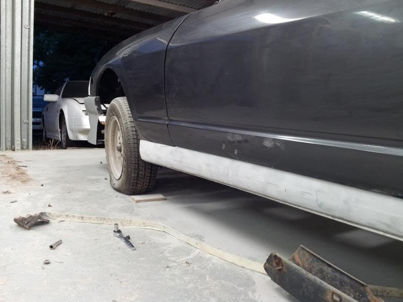

Well I'll start with the side skirts, their 'done', just need to be sanded all over (I'll get Michael to do that) then paint and mount them to the car
Posted Image

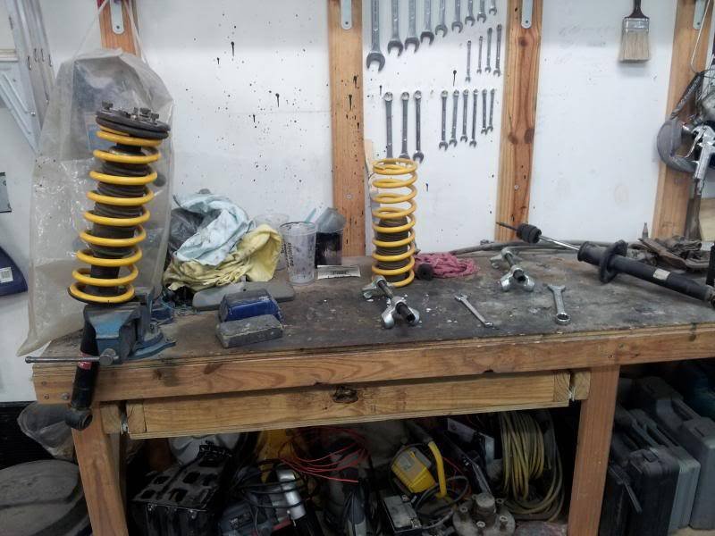

So anyway today I started to disassemble both the front struts
Posted Image
And I ended up with a bench looking like this. The front shocks look like the originals and are shot.
Posted Image
After a few minutes with the media blaster, both sides are done.
Posted Image

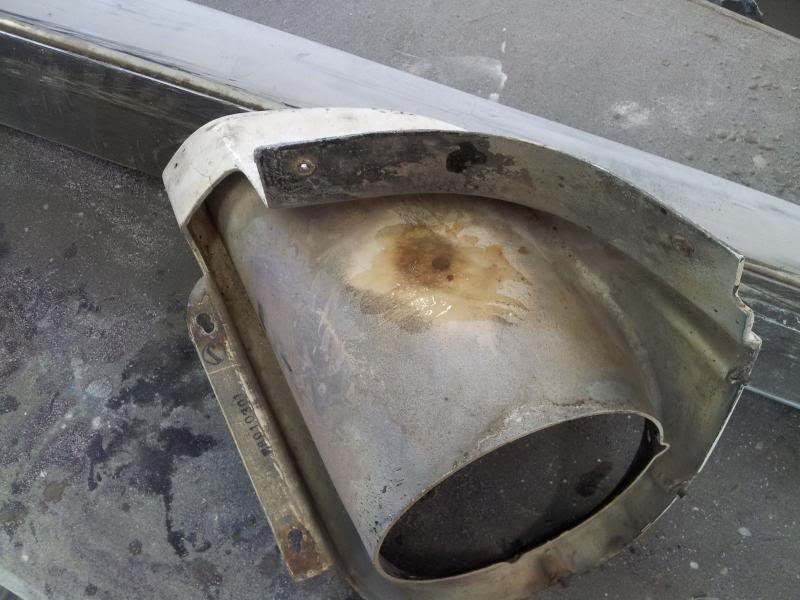

One cover painted, there is some pitting on the cover from rust but that doesn't matter.
Posted Image

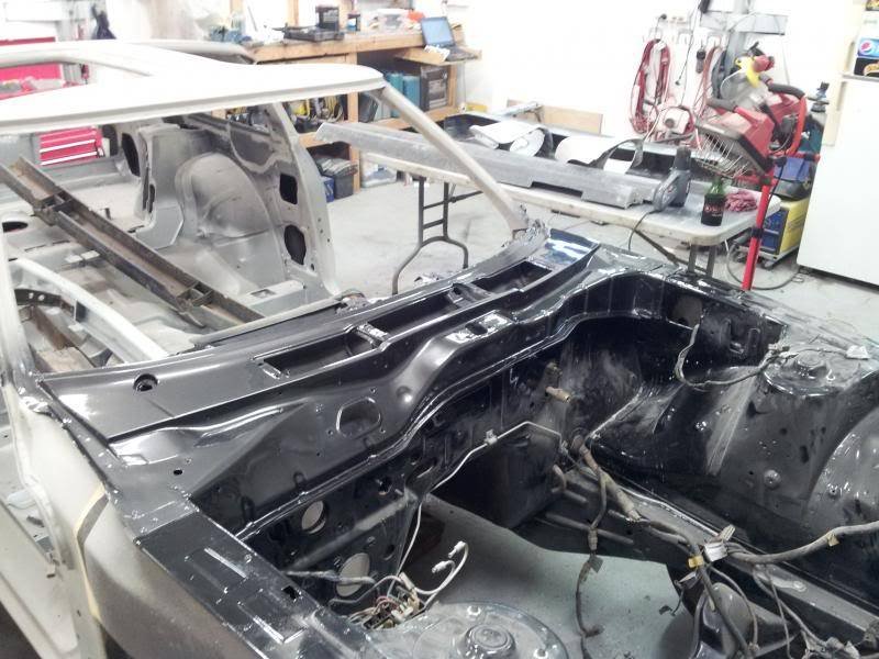

Media blasted and painted the inside of the car, I found one small rust hole so that got cut out and new steel welded in. This is the inside just in primer. I have put a top coat down just haven't taken any pic yet
Posted Image

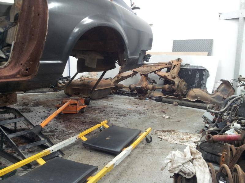

Other things that have been done include removing the whole rear end to be inspected, cleaned, repair where necessary then reinstalled.
And that's about it for now. Mike is going overseas for 18 months so I'm going to get stuck into it while he's away and I plan on picking him up from the airport in it when he returns (don't know why but I seem to get more work done when he's away).

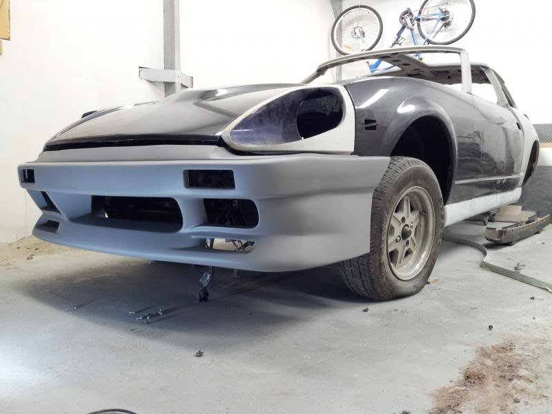

So to start with I've been working on the front end. I lined up the front spoiler with the side skirts and found I needed to take another 3cm off the top of the spoiler so it wouldn't hang lower then the bottom of the skirts.
Posted Image
So now the front's inline I need to clean up the cut a bit
Posted Image
Just with more of the front end mocked up so I can take some more measurements
Posted Image
And marking out how much of the rear has to be cut off
Posted Image
Looking better
Posted Image

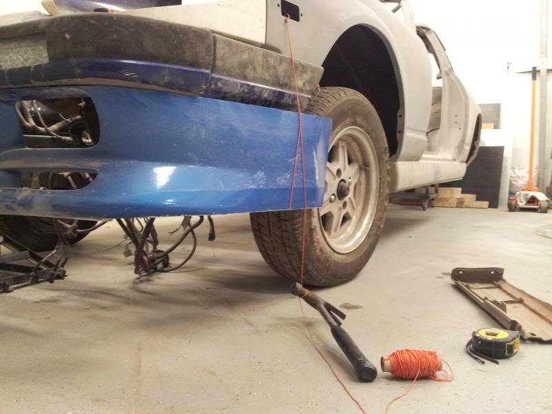

Posted 31 August 2013 - 01:35 PM
Just about spot on with the height, the hammer was the closest thing I had to weigh down the string while I was lining things up
Posted Image

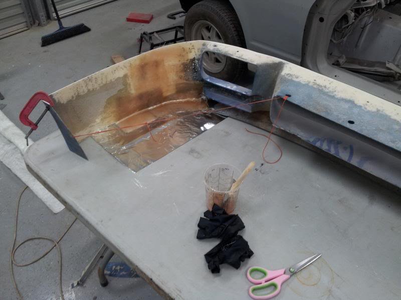

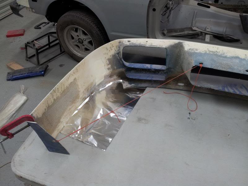

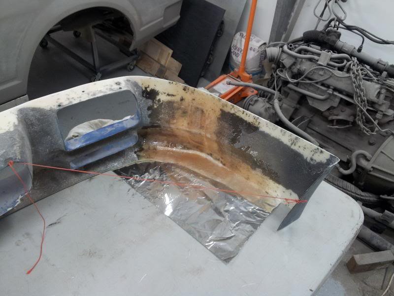

Now as the sides of the spoiler are too wide I had to cut out some material in the corners and grind down some of the fiberglass so I could bend the sides in easily
Posted Image
Big ass hole with masking tape over it and string to hold the side inplace while I work
Posted Image
Working away
Posted Image
Posted Image
And thats about where it's at at the moment. Lots of measuring twice and cutting once kind of thing going on so it's slow progress.

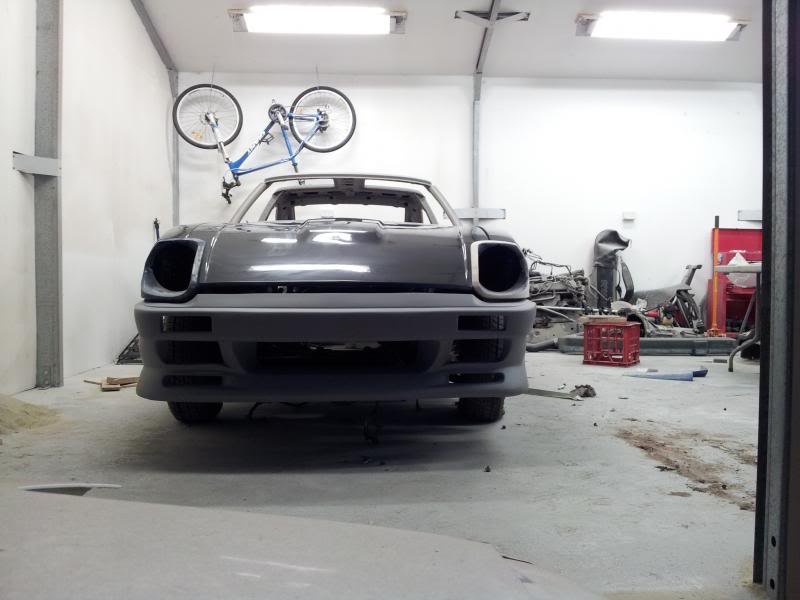

Posted 20 October 2013 - 10:20 PM
Posted Image

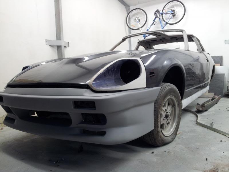

Posted 29 November 2013 - 06:56 PM
Typing isn't a option for me at the moment so I'll just show you all a bunch of photos
Posted Image
Posted Image
Posted Image
Posted Image
Posted Image
Posted Image
Posted Image
Posted Image
Posted Image
Posted Image

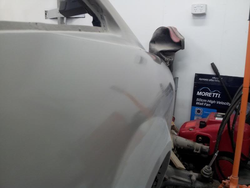

Posted 25 March 2014 - 11:10 PM
Ok so where to start, or continue? If you don't already know work halted due to this . The first thing was for me to fix my bike when I could. No the wife was not happy with his. But after that the car followed. The front end is now ready to make a mould from, It's not perfect but it'll do for now. The car has been blocked ready for paint, the door jams still need to be sanded but I'll leave them till the day before I paint. The cowl panel has been painted as well so I can start on installing the motor out of the 'blue' car. I started the blue one after it's been sitting for three years for the first time the other day, video link below.
Touching up the last bits of the body before calling the 'body work done'

I've got the rear quarters ready
Posted Image

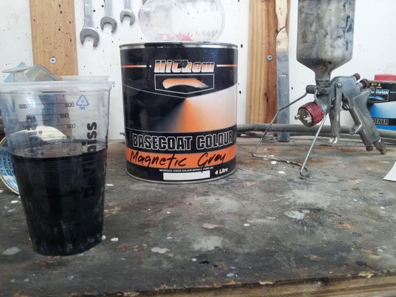

Then I played with some paint
Posted Image

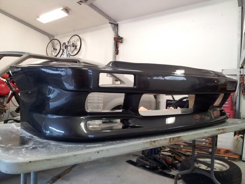

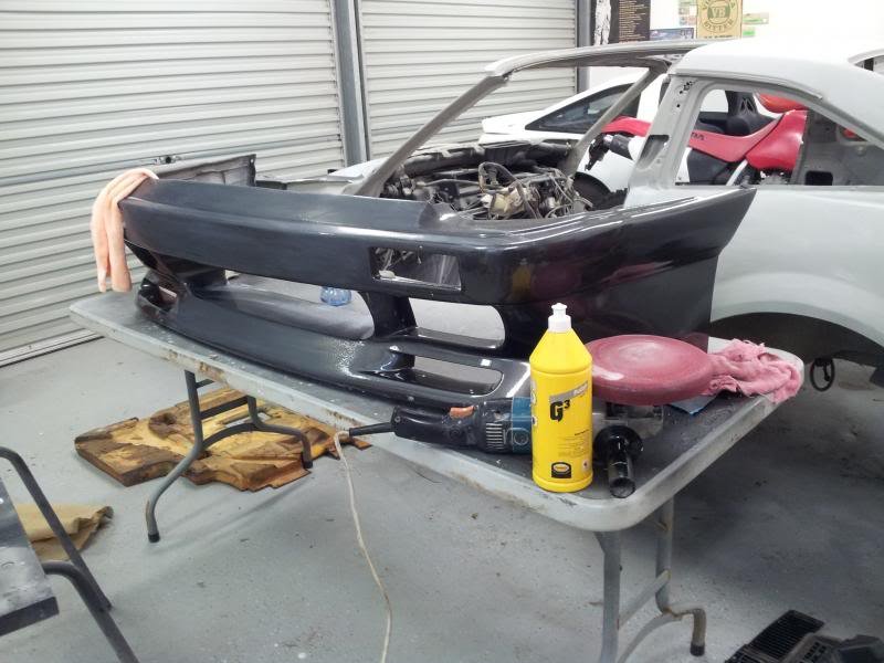

And I painted the front spoiler
Posted Image
Followed by a wet sand, cut and polish
Posted Image
Wet sanded, cut and polished
Posted Image

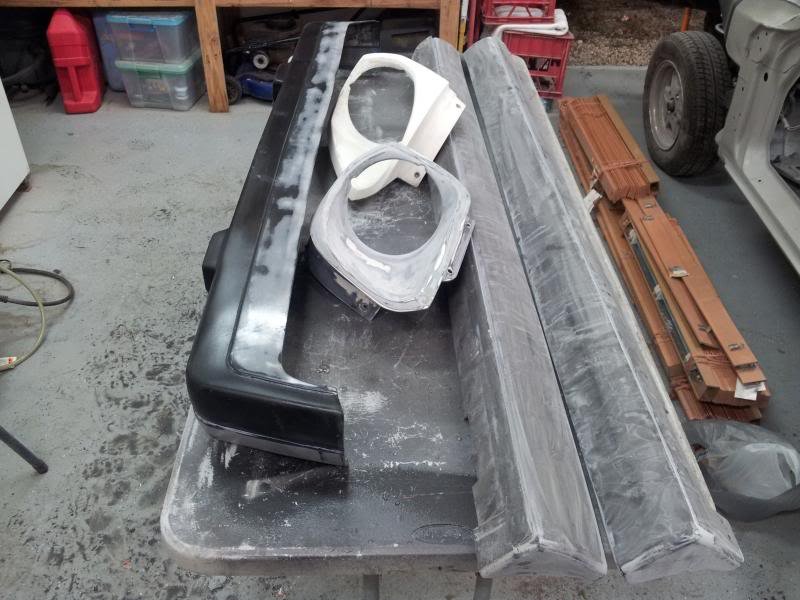

And now all the last parts are ready for some primer
Posted Image

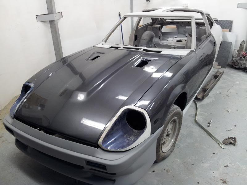

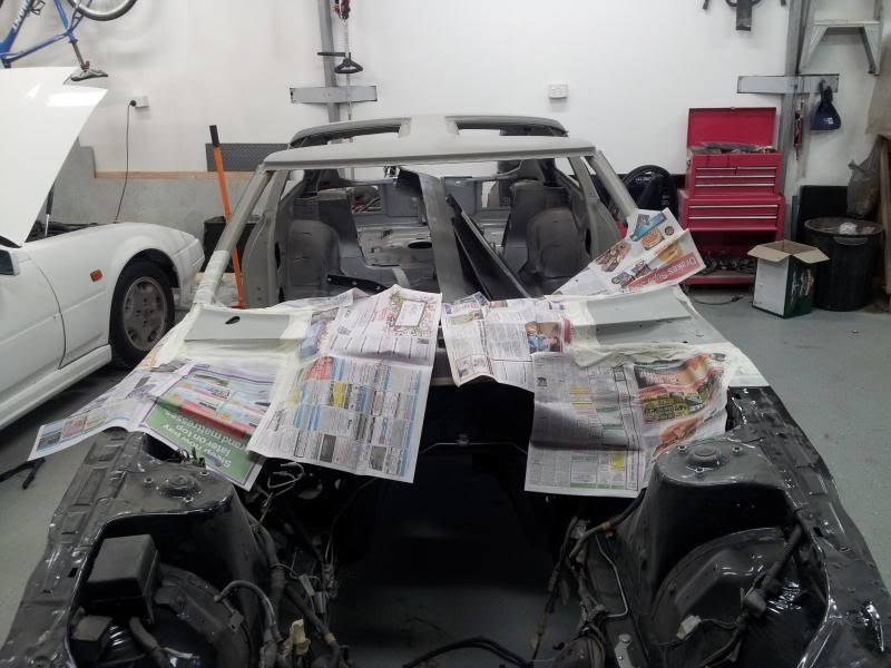

I painted the cowl so I can start installing the motor

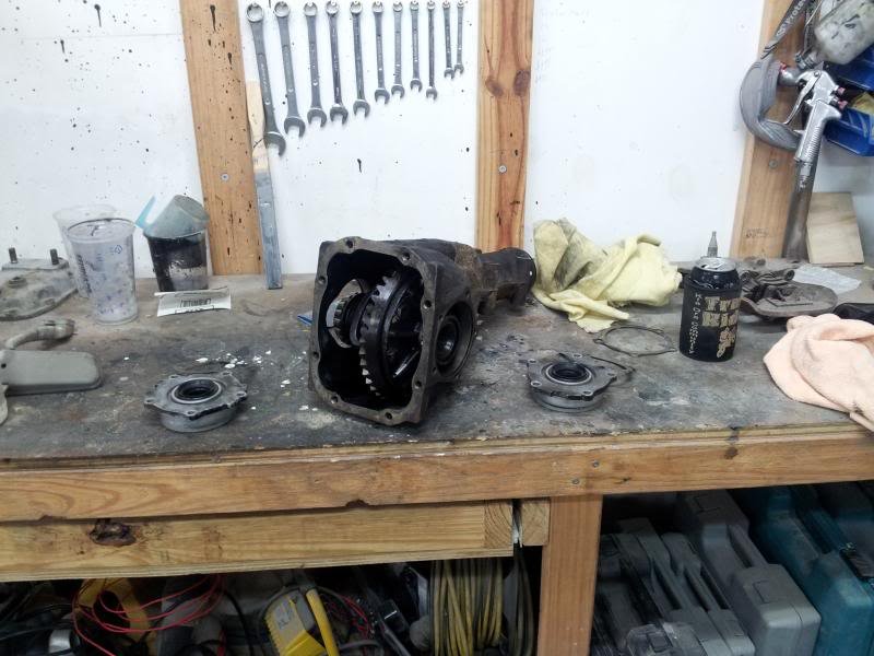

Posted Image
The rear suspension went back together as well
Posted Image

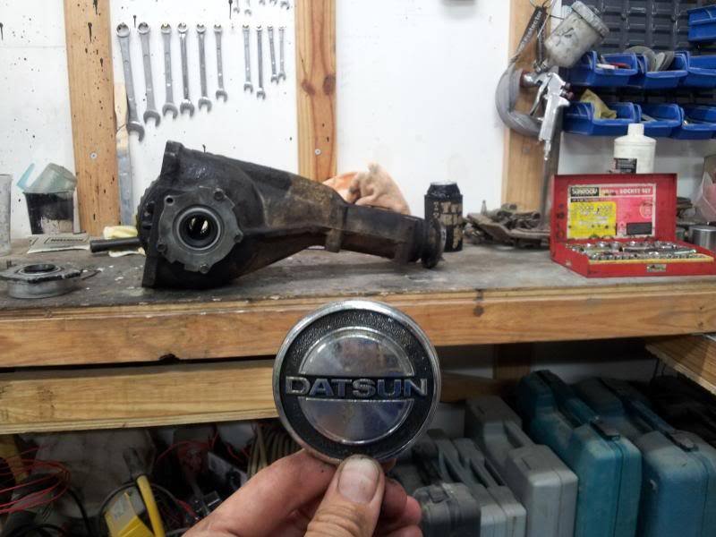

And the diff
Posted Image
Found a badge while working
Posted Image

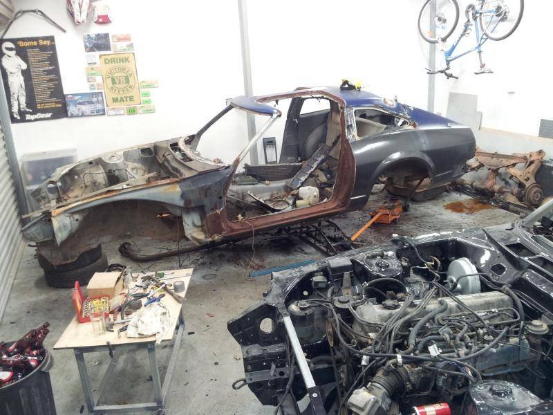

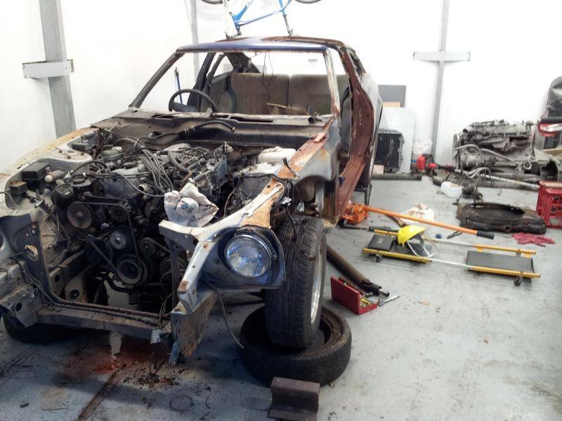

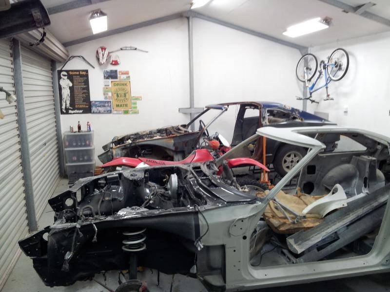

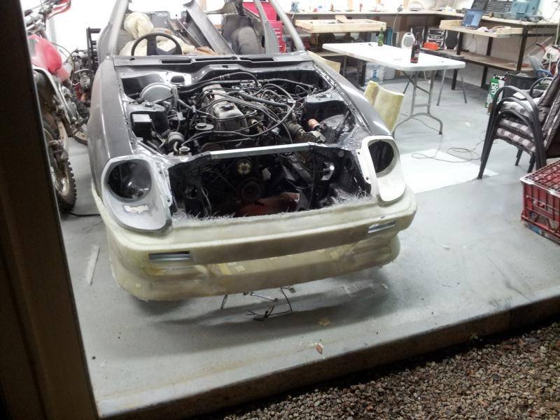

Alright here's a update, I've still been working on the car and taking photos I've just been lazy with uploading them.

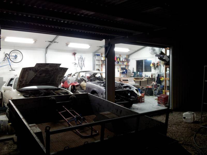

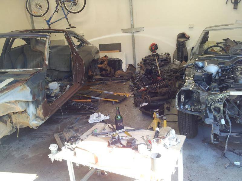

I put the blue car into the garage so I can pull the motor and strip the body before I take it to the scrap heap.
Posted Image
Just a random shot
Posted Image
I think it might need a aligment
Posted Image
Posted Image

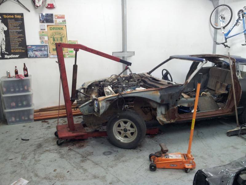

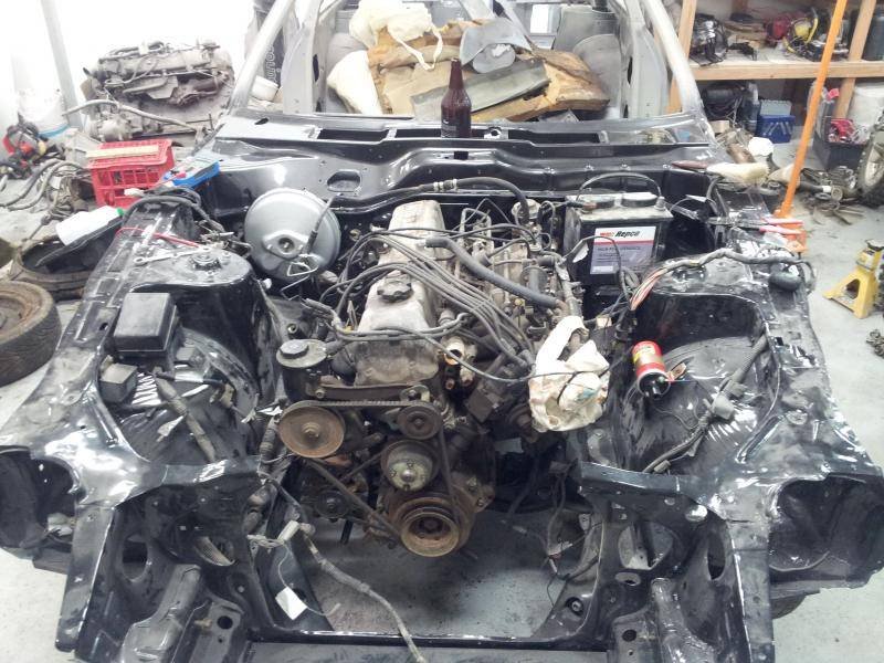

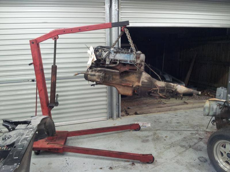

Transferring the heart into the grey car
Posted Image
And with a bit of fiddling around and a lot of cursing it's in. Note to self: It's a lot easier to line up the engine mounts when their attached to the motor and not the engine bay
Posted Image

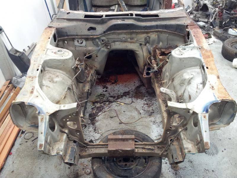

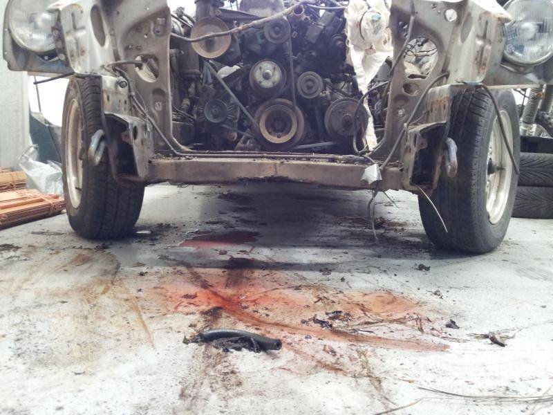

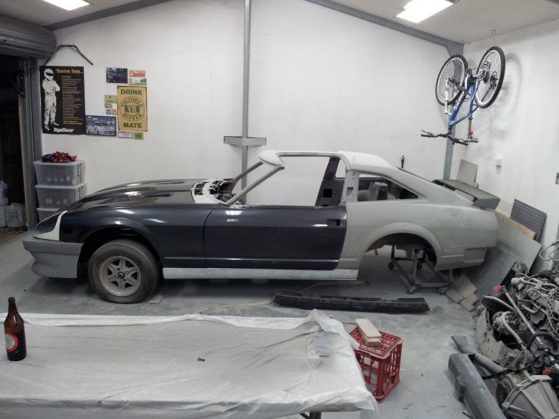

Just about finished stripping the blue car
Posted Image
Posted Image
Posted Image
Posted Image

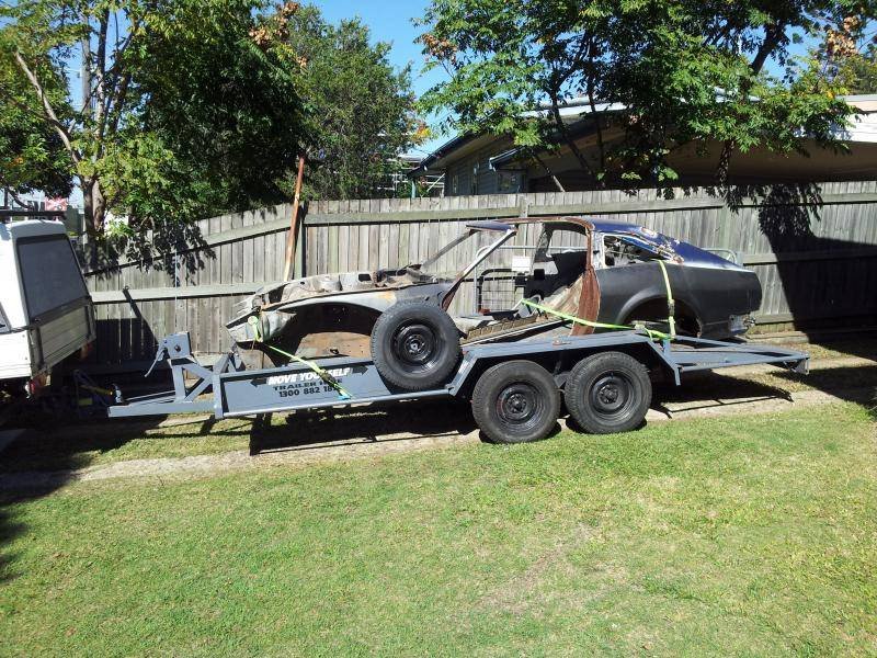

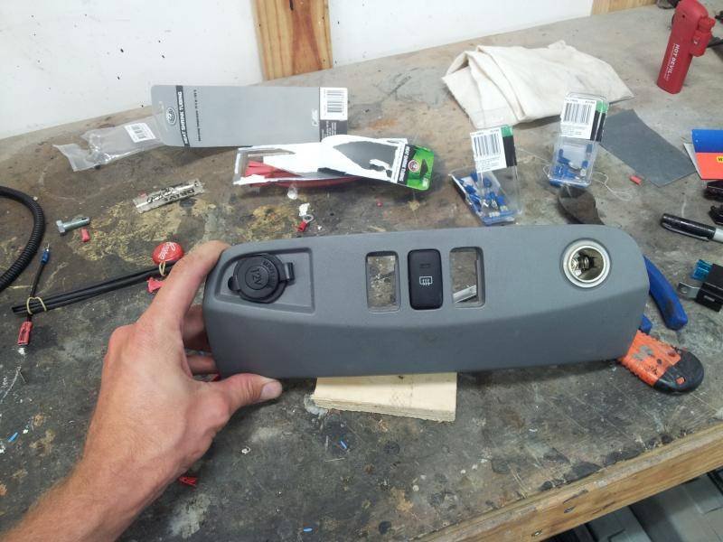

Amongst all that I installed a axillary power point in my Hilux
Posted Image
Bye bye blue car. Sims Metal gave me enough money to buy a carton

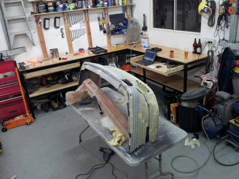

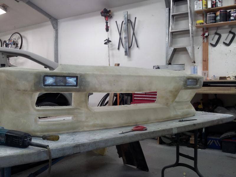

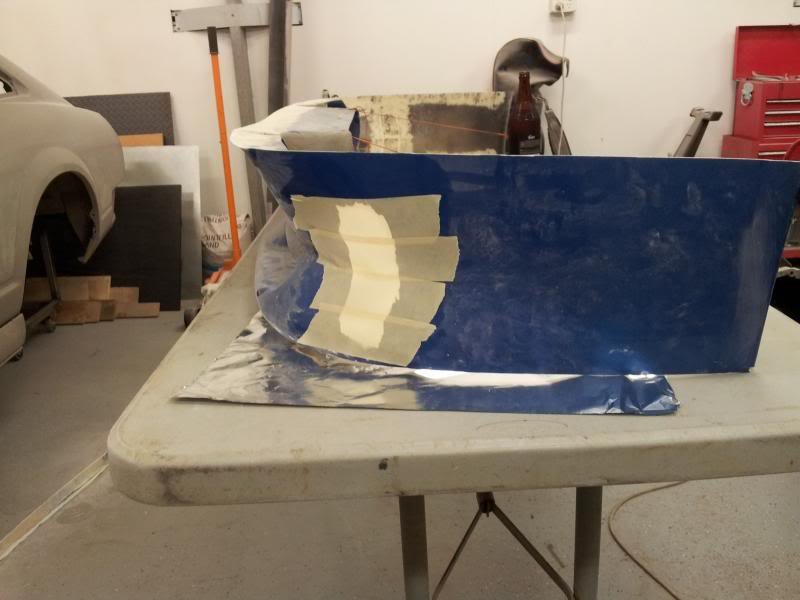

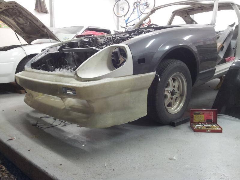

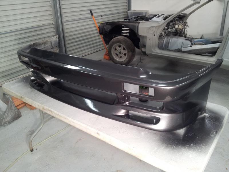

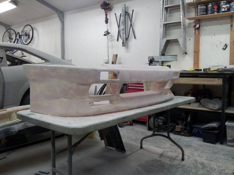

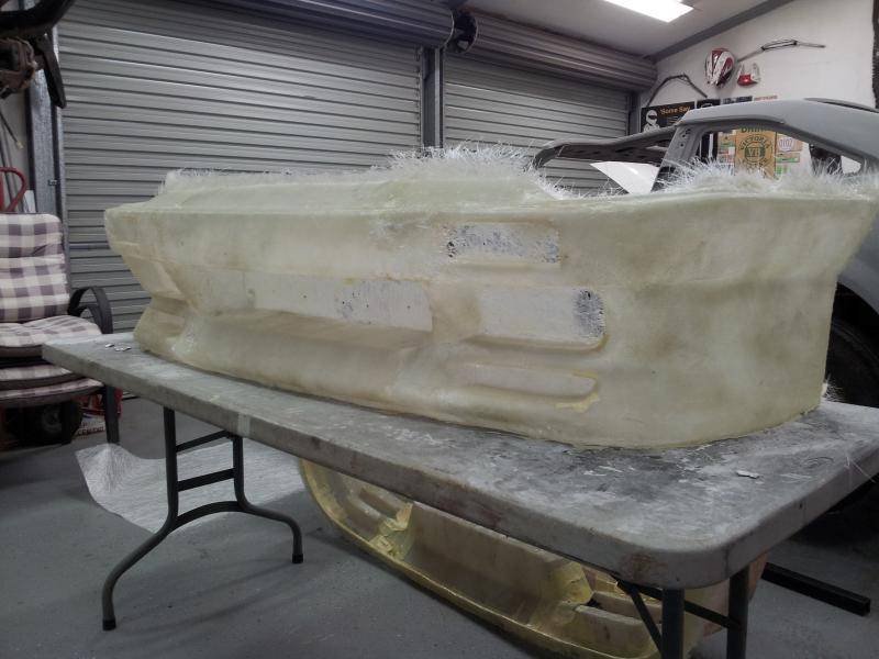

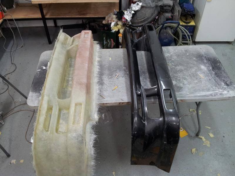

Making a mold of the front end, I've never done this before
Posted Image
It's done
Posted Image
The prototype and the mold
Posted Image

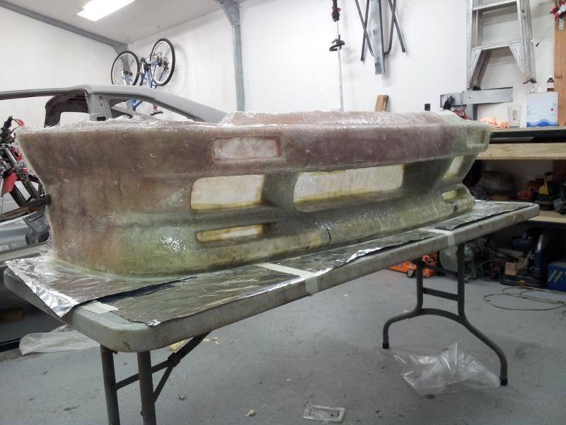

The piece I cast from the mold
Posted Image

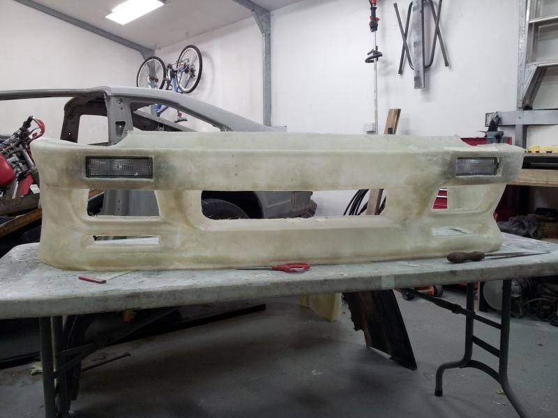

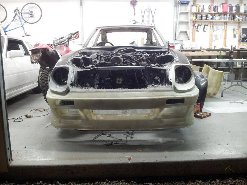

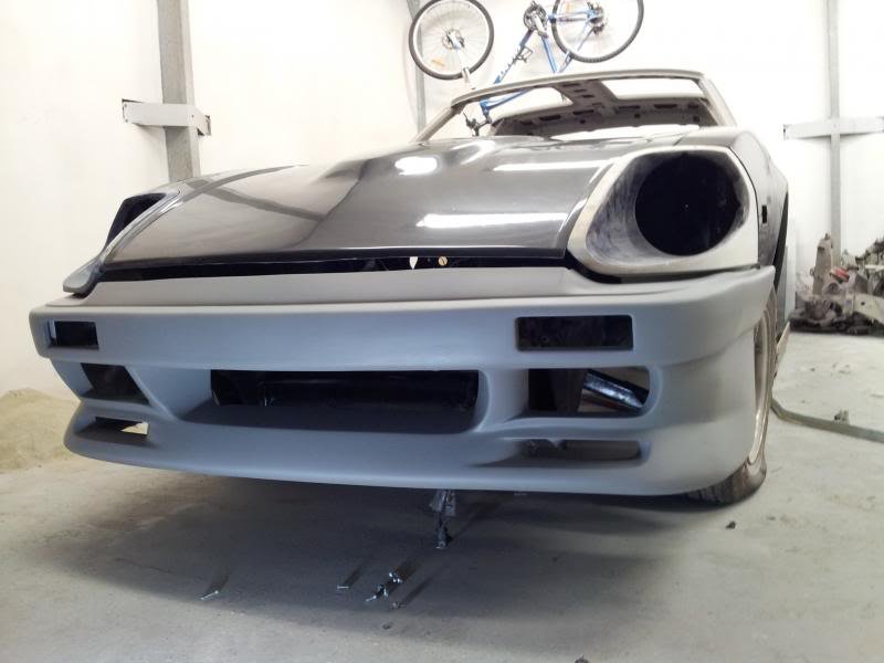

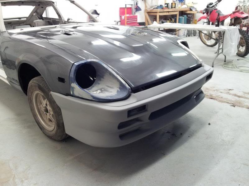

Doing some test fitting, some bits need to be trimmed/altered
Posted Image
Posted Image
Posted Image
I was trying to get the car running and it just wouldn't start. Apparently the injectors wont work without this relay. I had to go through EVERYTHING to find this f*cker, the car runns now by the way
Posted Image

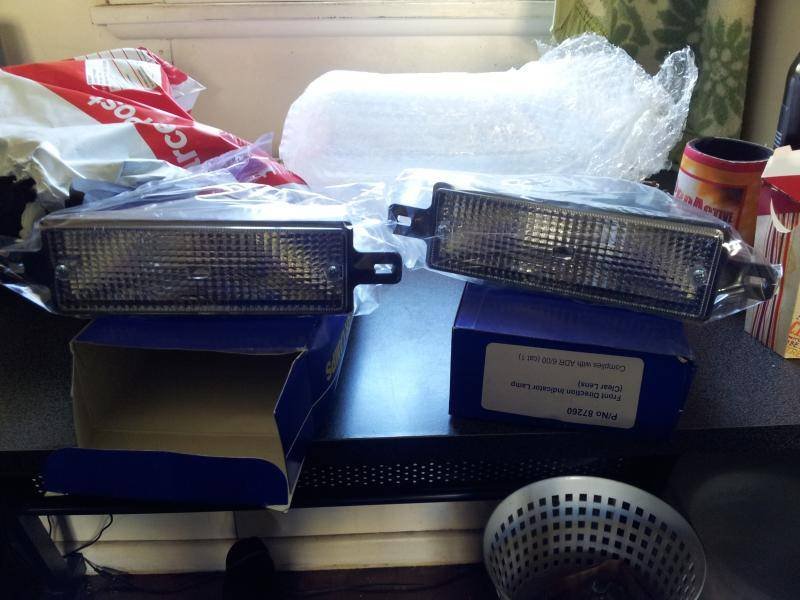

Picked up some aftermarket indicators, the park lights are going to go in the headlights.
Posted Image

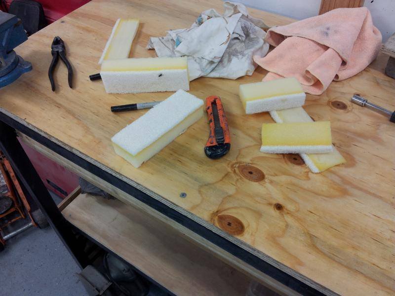

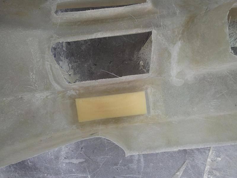

I had to modify the cutouts for the indicators so I used a sponge to make a template.
Posted Image
Posted Image
And that bit is done
Posted Image
Posted Image

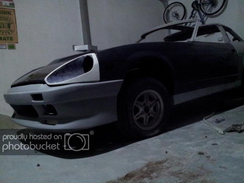

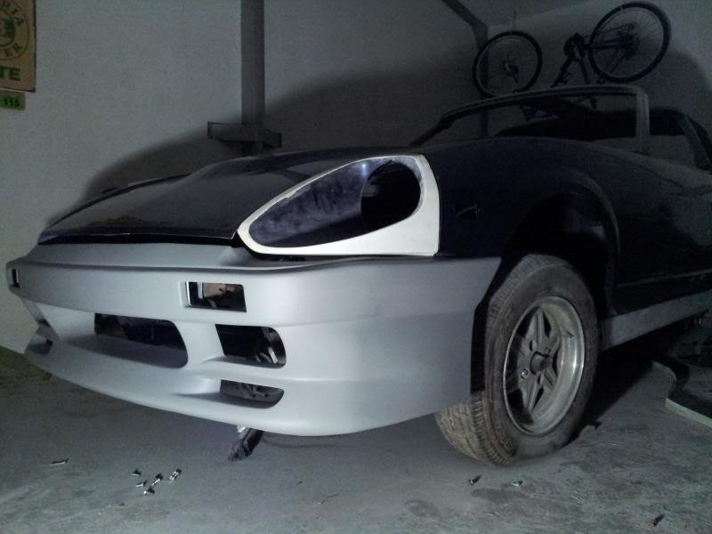

Finishing off the front end, it's not finished yet
Posted Image

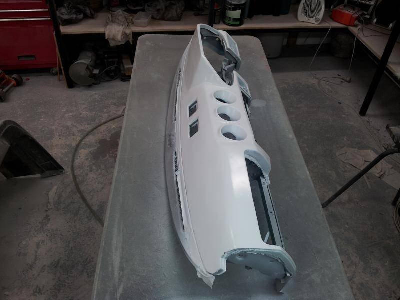

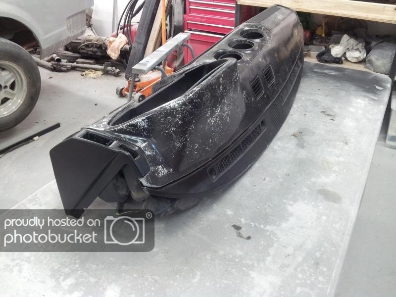

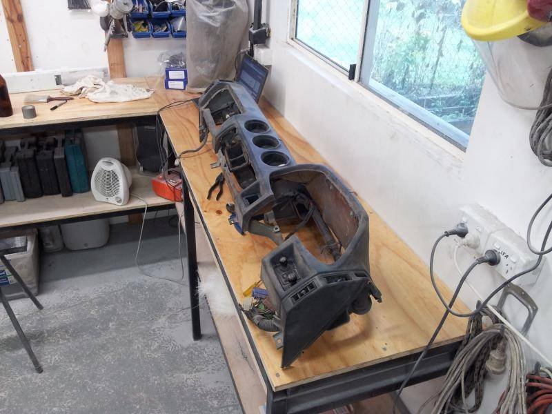

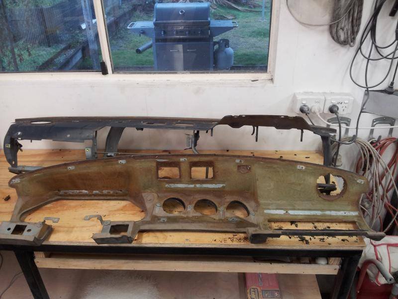

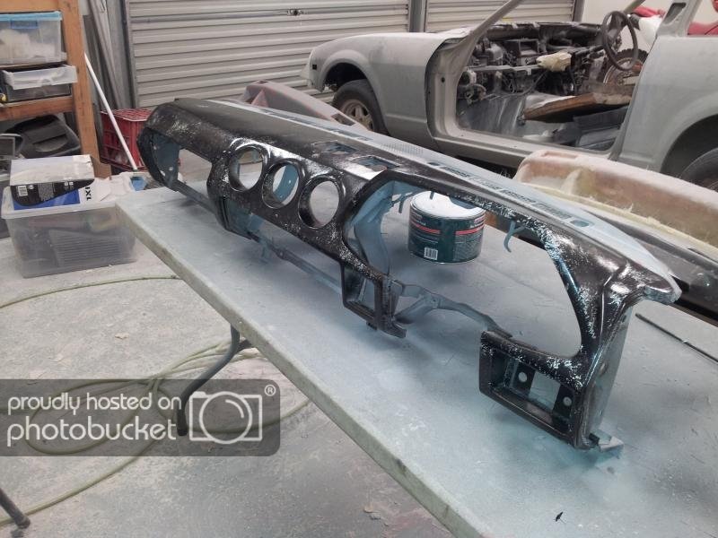

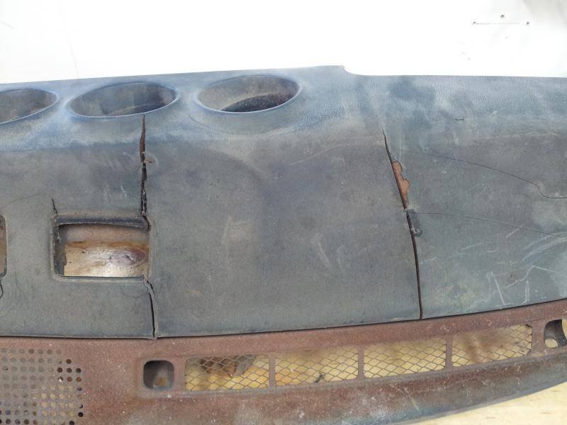

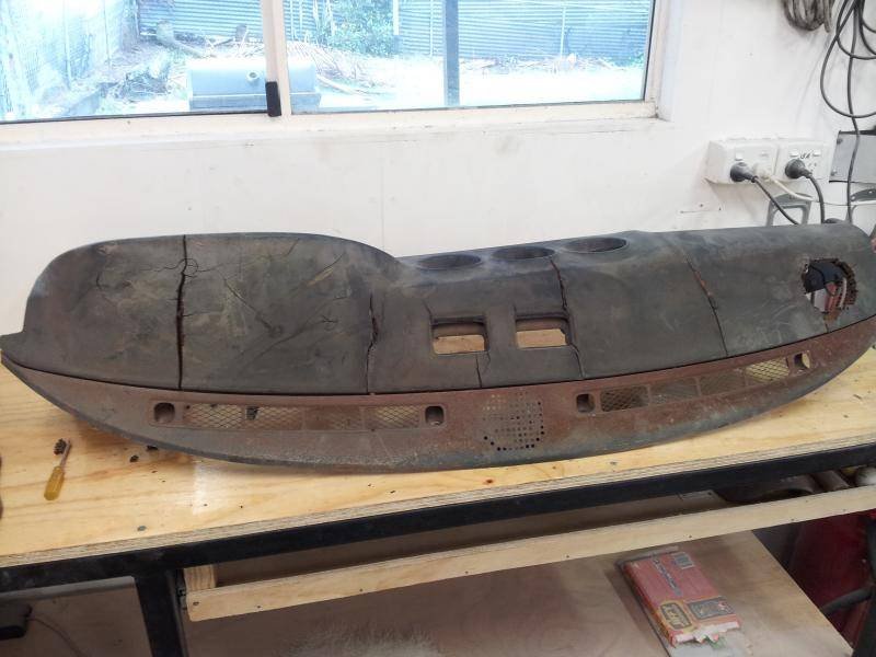

Decided to work on the dash for a little bit
Posted Image

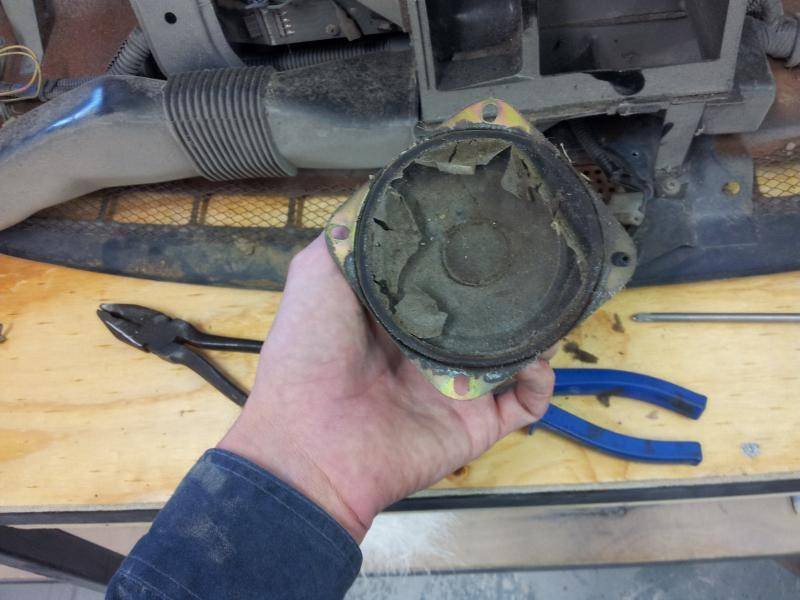

I think we're going to need new speakers
Posted Image

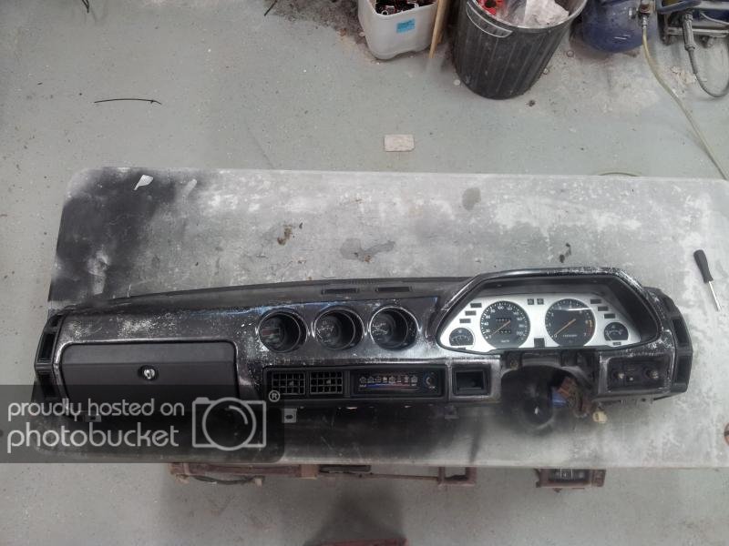

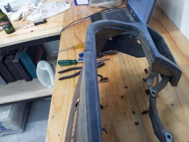

It's a bit ordinary
Posted Image
Posted Image
Posted Image
Posted Image

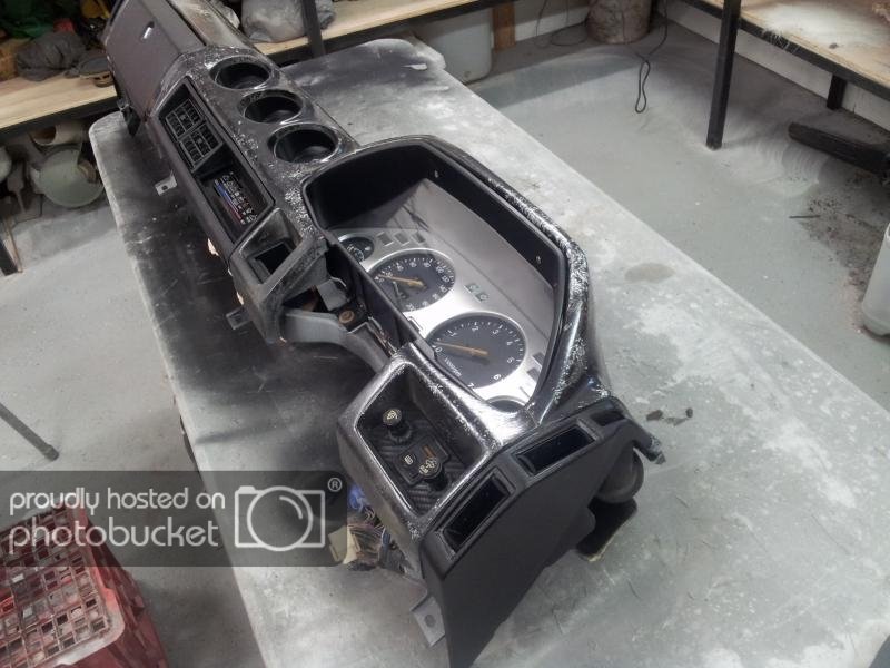

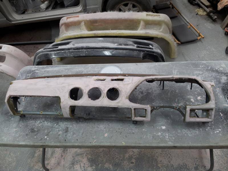

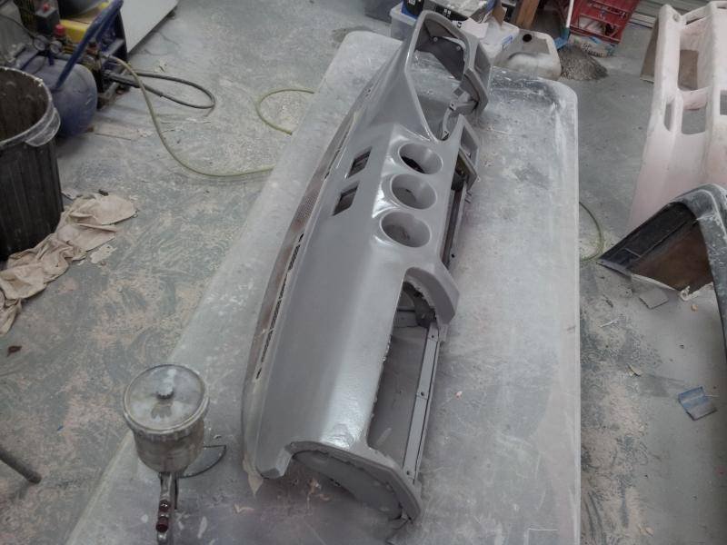

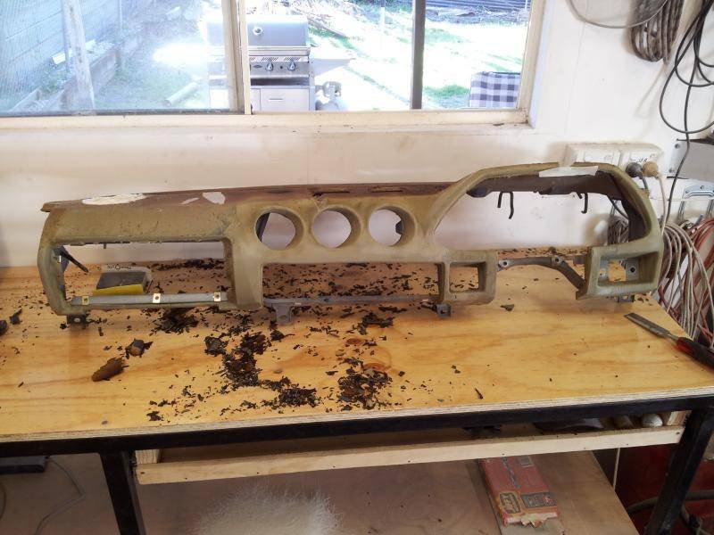

Stripped it down to nothing
Posted Image
Posted Image

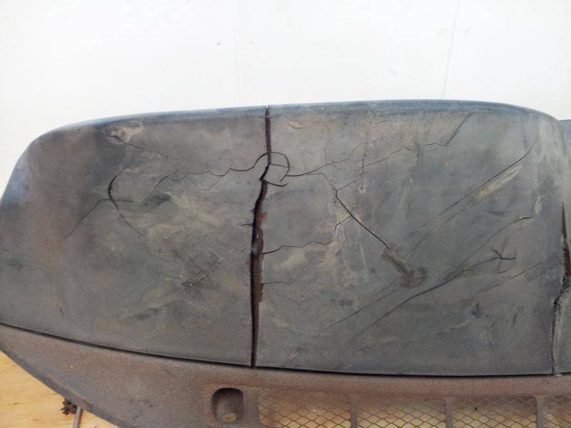

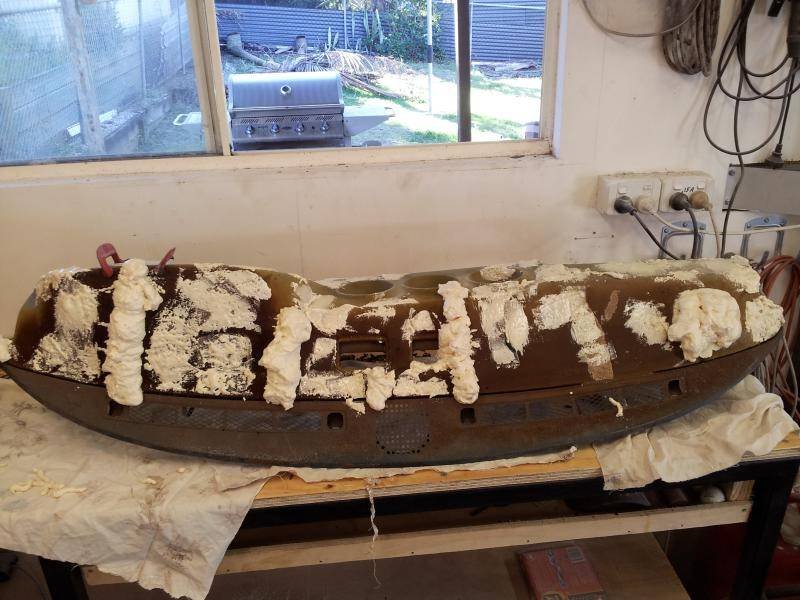

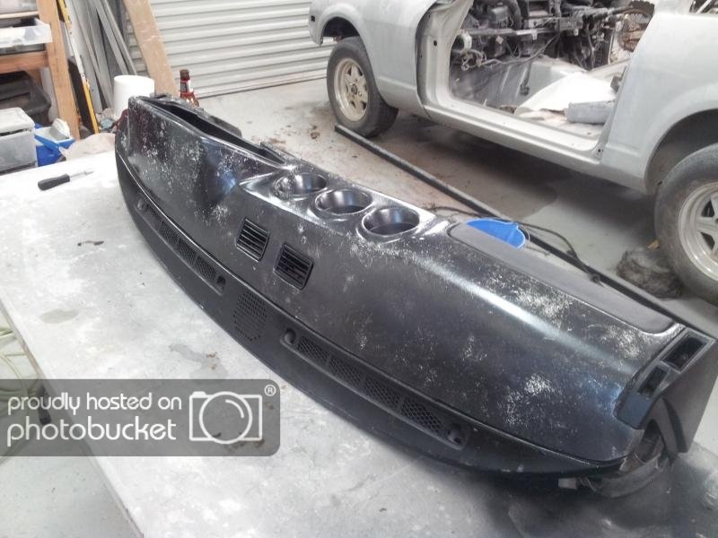

Fixing up the cracks and divots
Posted Image
Skimmed on some filler then sanded it smooth
Posted Image
Primed and ready for some colour
Posted Image

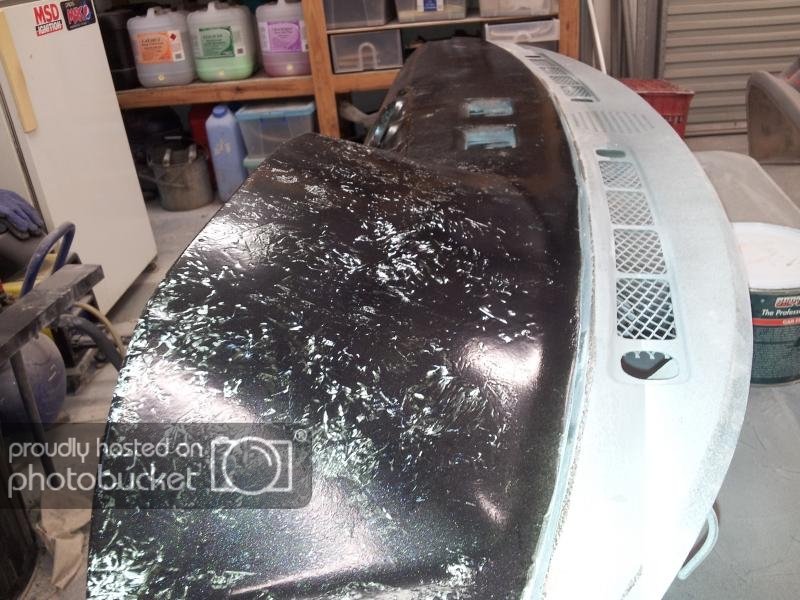

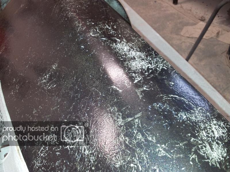

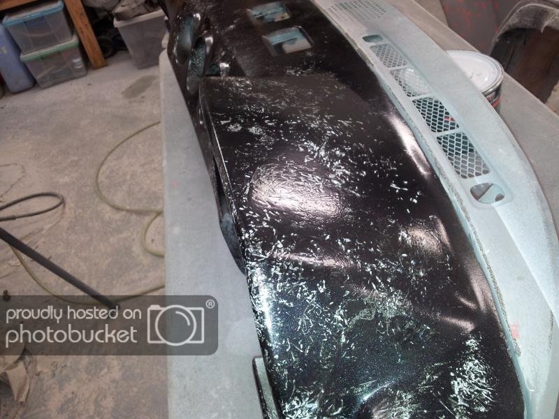

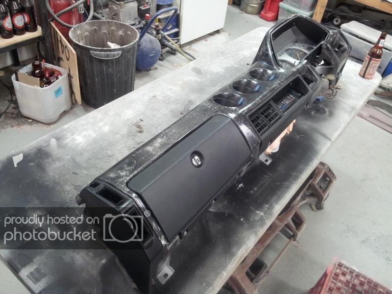

Had some leftover paint lying around so I thought I'd try something different
Posted Image
Done a base colour
Posted Image
And now the top colour, it's really hard to get a good photo of the finish but I like it
Posted Image
Posted Image
Posted Image
Posted Image
Posted Image
So that's about it for now, I'm currently finnishing off the front end then I can think about painting the rest of it.

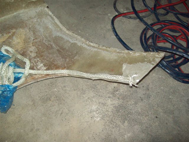

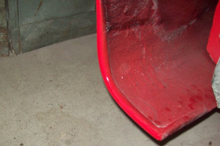

To improve the strength and durability of the fibreglass front you might consider using fibreglass rope to create a firm edge.
http://www.ebay.com....=item3a93cc5fda
After rubbing back the surface around the edge just soak the rope in resin (with hardener) and lay it around the edge.  You can later sand it and finish with either a bit of bog or Qcells mixed with resin.
Here is a photo of the rope in position to cut to length and another edge with the fibreglass set. The second photo shows the finished process on another bit of bodywork.
Thanks for the info and link. As I mentioned I haven't done this kind of work before and any tips are muchly appreciated

Wow, nice DIY there. I'm inspired by your fiberglass mould work. I recently got a couple of unique spoilers for the S30z I'd like to reproduce. Will have to give this a go at some stage, time permitting of course.
The dashboard top coat is interesting, is it the lighting or have you gone for a sort of patina effect with the paint? Can't tell if it's the texture or not?

Not to question your work, but is it too hard to re cover the dash with vinyl once it has been repaired?
#39 Rat1314
Rat1314
  • 108 posts
  • Location:Brisbane
  • Tagline:New Member
Posted 13 October 2014 - 09:54 PM
I'm not really sure what to call the finish on the dash. I put down a base coat and let that cure, then I put down a heavy color coat and pressed scrunched up plastic over it before it dried. It's not a patina finish but it does have some texture to it. Once the car is finished I'll have a friend do a photo/video shoot of the car and his camera should show the dash a lot better then my phone.
Yes it is, to cover the dash with vinyl would require a vacuum forming machine(some people out there might be able to do it without one). The finish on the dash was a experiment, took stuff all time, cost nothing(all the supplies were sitting on a shelf) and if I want I can re-coat it in the future

I've finished the dash
Posted Image
Posted Image
Posted Image
Posted Image
Posted Image
