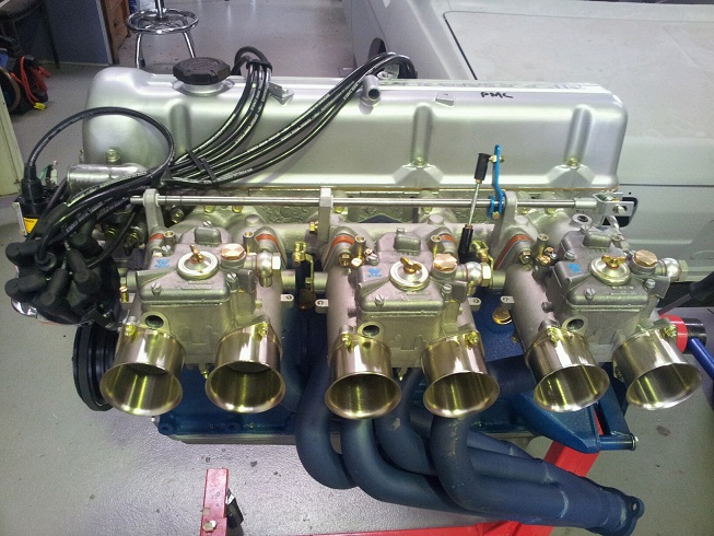

#47 peter mc
peter mc
  • 1,573 posts
Posted 24 February 2012 - 03:38 PM
more pics

That flywheel is beautiful

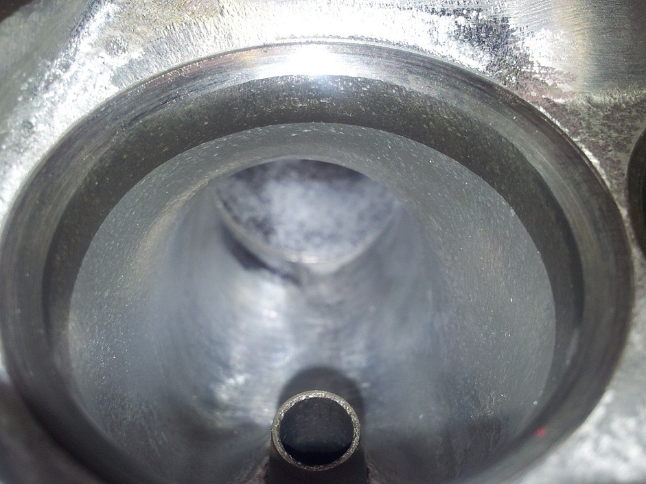

#56 peter mc
peter mc
  • 1,573 posts
Posted 08 March 2012 - 06:54 PM
some pics of the head for the stroker ,,,, lots off work to make all cylinders make the same hp  . all inlet ports flow 360hp at 600th

#58 luvemfast
luvemfast
  • 4,138 posts
  • Location:Melbourne
Posted 08 March 2012 - 08:06 PM
Look at those port walls!  8)
Nice work  ;)
