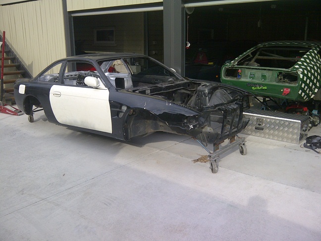

Well, I got the new toy home this afternoon and it's now tucked away in the garage until the Charger is finished.
Then it will be a concerted effort to get it built in around 6 months.
Whilst I'm waiting for the charger, I'll be able to source the bits and pieces needed, including a half cut, a set of coil overs, set of brakes and some plastic windows plus a glass screen.
It came complete with all hanging panels including some fancy wide body type guards that are supposedly worth some dollars, Q spec hubs and suspension, dash and sits on castors to get it around. It did have a RB crossmember which was taken off as I need to run and SR20 to comply with the 2B rules.

There is your colour scheme, US police style black and white!!
This is going to be interesting, there are already a couple of modest S chassis sprint cars doing Lakeside well into the 50's :)

Looking forward to the build.
Colour scheme will the reverse of the Zed, white with BRG Checks.
