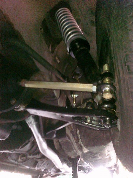

Other have fixed the issue with custom tie rod ends using rose joints (might not be road legal in Oz but here in NZ it is ok with an engineering cert) and relocating the steering arm via a threaded tapered thing - not sure what they are called but here is pic

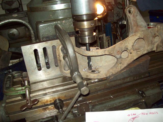

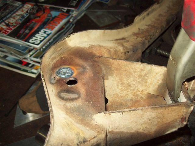

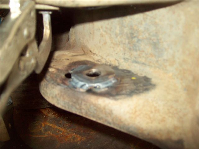

I drilled another cross-member today and took some photos of the process:
Mounted the cross-member on the mill.
Drilled new holes 19mm higher and 6mm outwards.
Made and fitted new spreader plates - the old ones were mangled when chiscelled off.
Filled the old holes with weld.
I still need to dress it all and have it media blasted prior to painting.

Thanks Peter, It's always nice to have some pictures for the simpletons(me) amongst us  :)
