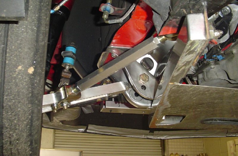

After moving the LCA on my car I installed rose joints & small spacers on the end of my steering arms per attached. Reasonably priced and my car has absolutely no bump steer. Drives like a normal car! The car is now safe to drive on those rough raods without running off into the bushes or gripping the wheel like my life depended on it. you know what i mean.   ;)
Yes you have removed the bumpsteer you can feel I can also tell you that looking at the pic of your result it will still be there :( it is just so high up in the suspension travel that you will never find it unless you run without springs. Again the same point don't move the problem fix it.
My mates race car has the same setup as you ie rose joint and special tapered bolt and we thought we had it when the setup looked like yours. However the end result was very different as we found with the setup like yours bumpsteer was still there in the upper part of the travel. Do a google on how to make a quick and dirty tool to measure the bumpsteer. Make the device, remove the springs from your car and using a jack while someone is in the car holding the steering wheel locked in the straight ahead position (this is key to a good reading from your home made device) and move the suspension through the travel and monitor the changes in toe both in and out aka bumpsteer. Now have a play with your rose joint location with a number of different size spacers etc moving the steering arm up and down and record your results - I think you will find some unexpected results like we did.
As stated we thought we had it when the setup looked like yours but it can be improved on :)

I re-read my suspension book and moving the LCA does have some benefits. This relates to the length of arm and how it changes as it move up and down ie appears to get longer thus changing the toe and camber settings and thus bumpsteer - the steering arm mod also as the same effect on the toe issue but no so much camber.
This all gets complex and ackerman is very complex. I recall one local zed racer told me he never had any bumpsteer issues on his car every with no mods at all. However he was running 600lb springs in the front = suspension was not moving much = never causing issues anyway. Not a road car I might add.
For a road car the LCA and spacers are the most affordable solution. Next step is the setup like ZZZ8 with a rose joint and new tie rod setup that allows you to move the point of the steering and tie rod join. The new steer arm is the most $$ and can get the same result as ZZZ8 solution. I have gone the arm method as the local road rules don't like rose joints on the steering - it can be done but there can be too much paper work and hoops to jump so I have gone this path for now. Who knows I might end up with the ZZZ8 mod depends if I change the purpose of the car from road part time track to track and part time road.
