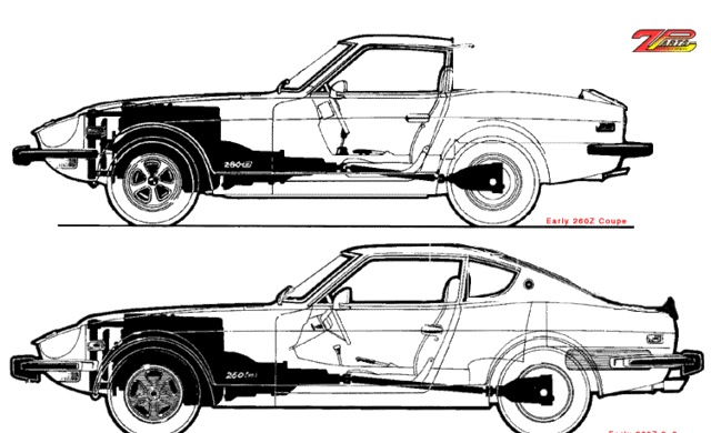

The front and bonnet are the same and would fit, the door is longer and so is the space from wheel arch to door frame, and I think the back is wider. The wheel base is longer with the 2+2 so proportionally would not look right as a copy of a 250 GTO, I would stick with your first answer and say no.
You could make it fit with work but don't think it will look right.

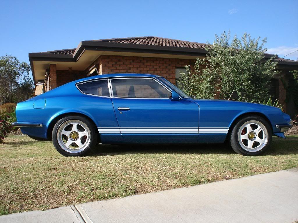

I tried to convert my 2+2 about a year ago aswell and the only way to properly do it is the way Sirpent said. (Unpicking the seam in footwell etc) in the end it was way too much money and labour so i sold it and got a 240z and haven't looked back.. i suggest you do the same as there are many cheap 2 seaters that pop up frequently, just have to be willing to jump on one when they come up.
If your still willing, here is a comparison pic of the 2 cars. ;)

If this is not big enogh size send me your email and can send bigger size.

Can someone please clarify for me?  Whilst I've always been told that firewall forward they are the same, it appears from these pictures that the rear of the front guards are wider on the 2+2.  Is this illusion or fact?
#27 benny
benny
  • 1,734 posts
Posted 30 November 2011 - 05:24 PM
illusion ;D

So if the 2-seat vs 2+2 windscreen posts lean back at differing angles, are the windscreens themselves (the glass) still the same? ie interchangeable?
In the words of the legend Murray Walker
"Unless I am very much mistaken"
There is no difference in rake period

John if you check the photo of the 2 chrome strips together you can see the difference in the angle of the roof line and the window posts. also check the photo of my T-top 240z  it has the 2+2 chrome strip clipped on to show the different angles, looking again  the roof line is higher.

Peter Allan asked if I could line the cars up with the front wheels as they were only lined up with the front bumpers, someone else may be interested as well.
