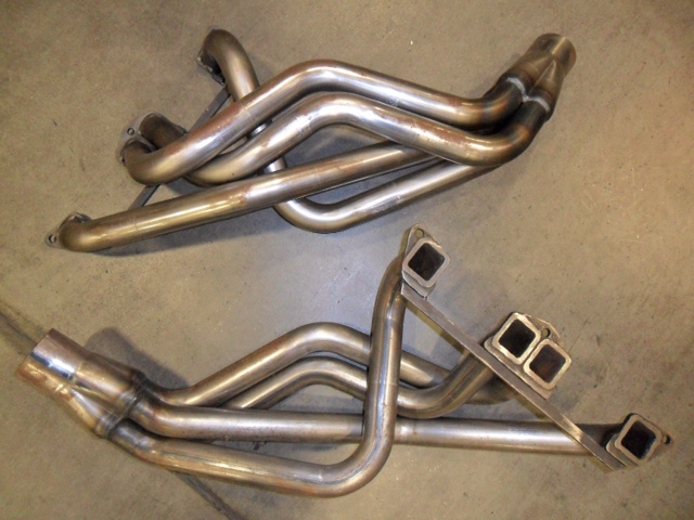

99996-E1143  -6 into 2 race header for L-Series 6-cylinder, 1.625" primary diameter, unplated
Communication is not a strong point with these guys in Tennessee  ::)

will this fit my stock l28 ?
#52 luvemfast
luvemfast
  • 4,124 posts
  • Location:Melbourne
Posted 21 November 2011 - 08:26 PM
Yes.
Ok, to save everyone wondering the same thing.
The real question is......
Will you see any performance gains?
No.
You will need to spend lots of money on engine mods to see the benefits.
Will it look da sh!t?
Yes.

the problem is even at 1 5/8 they are too big for a stock motor id be surprised if you gained 1HP infact from what I've read it will have a negative impact on the motor!!
Ben

I stand by my previous statement.
That you will not see gains with a stock L24, L26 or L28.
To make these headers work properly, you need to spend close to $10k on engine mods!!
But they are purtty  ;D

i have tested then and i dont like them .... as they dont make good torque in the mid rpm range
  I didnt want to say that so i just put dimensions and quoted big , but your bang on the money Pete , bog down mid range as the primary are too large in OD and length, might help using a 1. 7/8 inch exhaust pipe, sorta defeats the purpose a bit then, not a good street car or even a really good street car pipe, maybe those interested should do more homework on them its a lot of time setting them up properly
