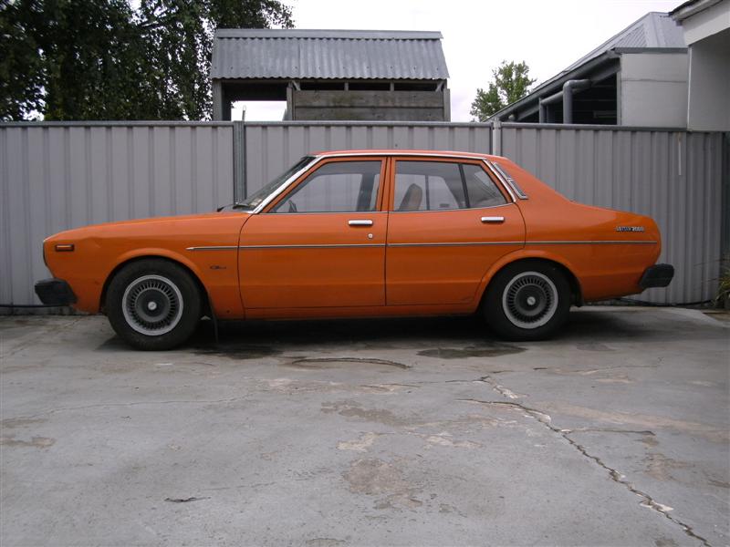

As the title says i'm fitting an SR20DET to a 1980 Datsun 200B.

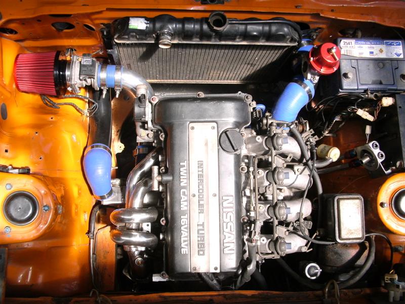

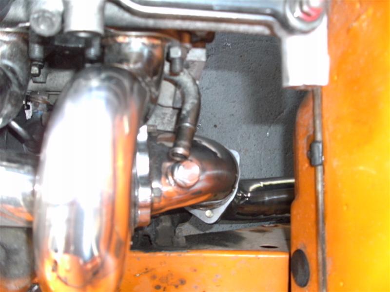

Check out engine test fit pics below. I also heard of people using R31 or S13 engine mounts but i tried it with the stock 200B items.

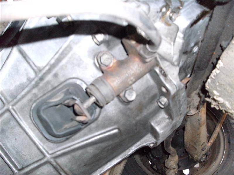

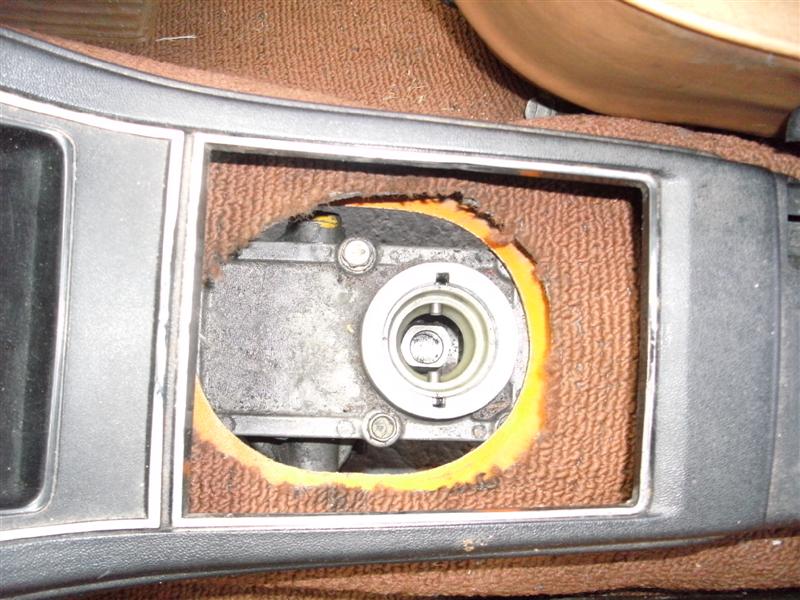

The engine, gearbox and 30mm shorter tailshaft are now fitted. The stock clutch slave cylinder bolts straight up and as you can see the shifter is not to far off from where the stock one protrudes.

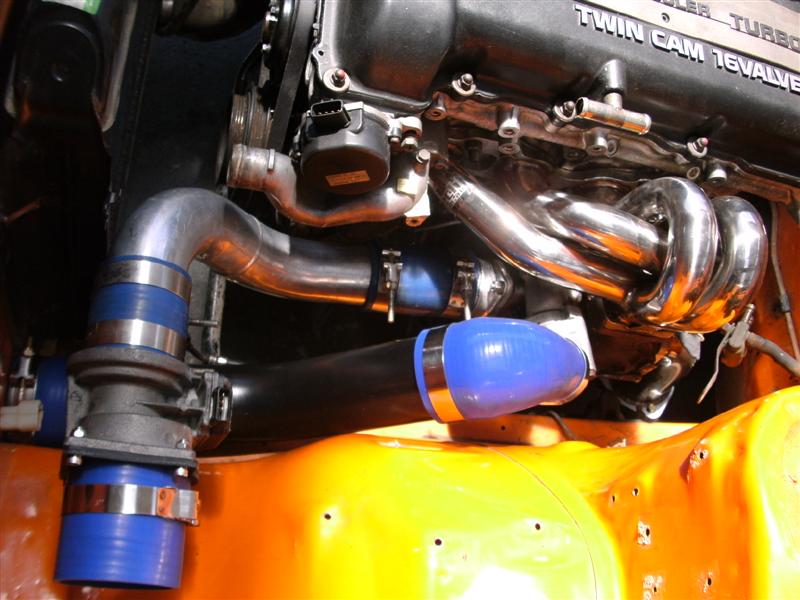

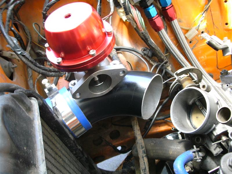

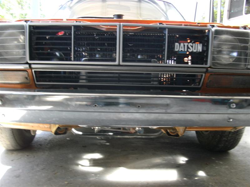

The intercooler, intake and and blow off valve only require two fittings (in transit) to be completed. Next stage will be the wiring and i hope to fire her at the end of this week.
