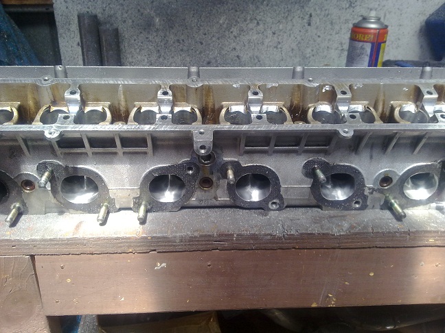

well work on the Rb28 this week ,,, more porting and more porting lol and i have modified the chambers so we can run more timing than a standard head this will let us make more power and the engine will run cooler ,work on the ports will be same as the GR A cars and the cams will be as well ...... this will be a hell of a fast car

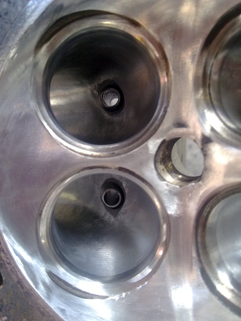

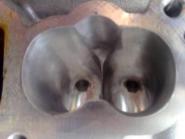

this is the mod on the chamber ......i will remove the steps on both sides of the camber

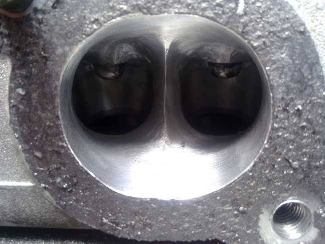

just a note that the chamber mods for mild motors 15psi you can do the inlet side and race motors do both sides for high boost 20 +psi  on 98 pr fuel this mod will let you run up to a extra 6deg timing....

Wow, looking good Peter and I like your style (you are not afraid to share your knowledge). That comes across as a man who is confident in the quality of his work and isn't afraid that he has to keep secrets from his competition. The chamber mod, is the first picture yours?is that larger valves or just the angle? Does this lower compression much?

hi garvice
first pic is a comp head with big valves and flows 310 cfm and will go on my NC28
as for the compression yes is lowers it, the step in the chamber helps turbulence at low rpm and boost ...but as things get going it can overheat the intake side of the piston and u will see det marks on all gtr pistons on that side, so this mod helps  remove det that you can not hear and you can run more timing and make more power for the same psi,,,,
if you wont you can buy pistons that will bring the comp up for race fuel with a 9.1 ratio with the mod to the chamber
with the stroke and bore and the piston i have ordered this motor will be 8.5 /1 and will take 20deg timing at 20psi  on pump 98 without the mods to the camber you can not get 14 degs timing

Thanks for the explanation Pete.  Makes sense that the sharp edge on the step would cause a hot spot.
So for a higher compression (9.5:1) and farily low boost engine (15psi or less) you would just do the inlet side?

yer only the inlet side and just role the exhaust side so it has on sharp edge ...9.5 and e85 and you will have a monster at 15 psi on 3L you can run so much timing makes for a engine that feels like it its 6L and high comp

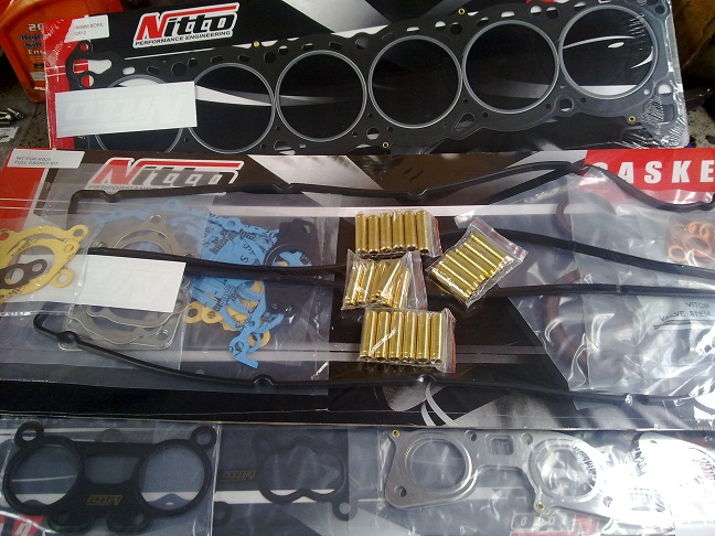

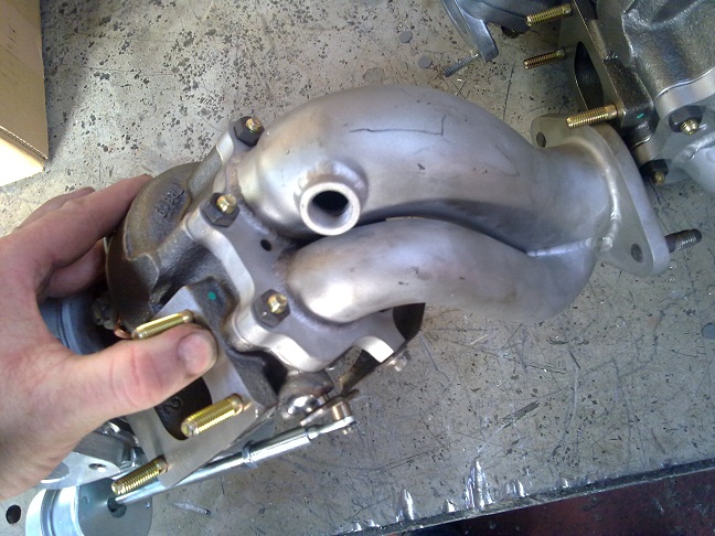

with this type of motor it so in portant to have the best gaskets you can get ,i love the nitto stuff all mls gaskets for the inlet and exhaust and a head gasket that i have never had fail up to 50psi and 1000hp on one i built a while back
