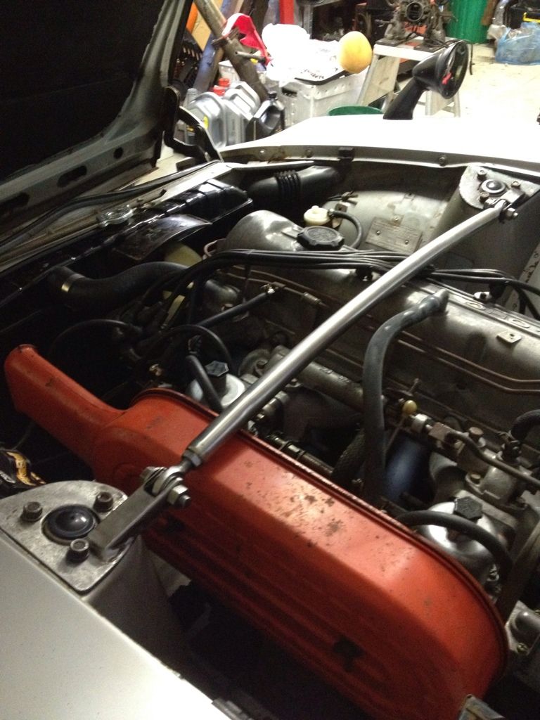

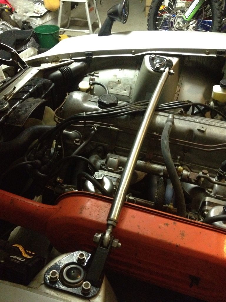

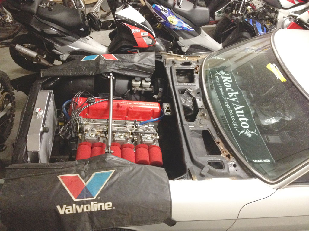

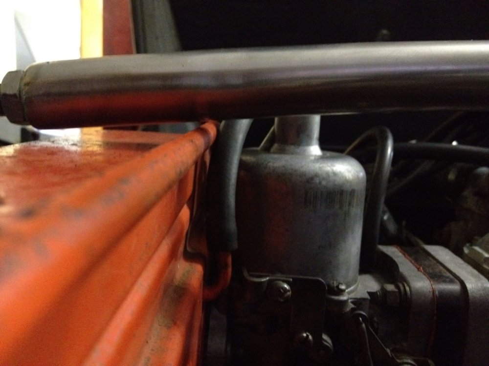

So here are the strut bars I refered to earlier. The front is courtesy of PGZ302, which I claimed from the wreck and had a mate bend me up a new piece of 3mm stainless tube. I wasn't stoked with the fit of the strut tops so i ground them down and painted them black. Fit on the stock airbox was a bit tight and i managed to get it to clear with a couple of washer underneath, but i knew i was going to triples in the near future so wasnt a big deal.
Posted Image
Posted Image
Posted Image

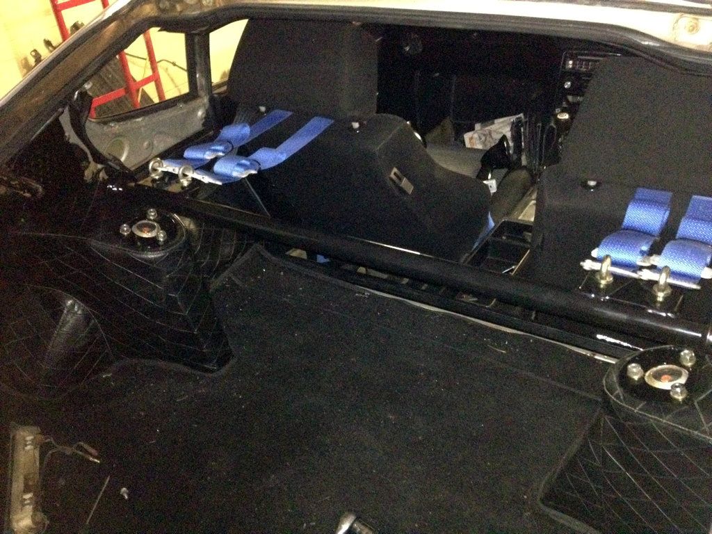

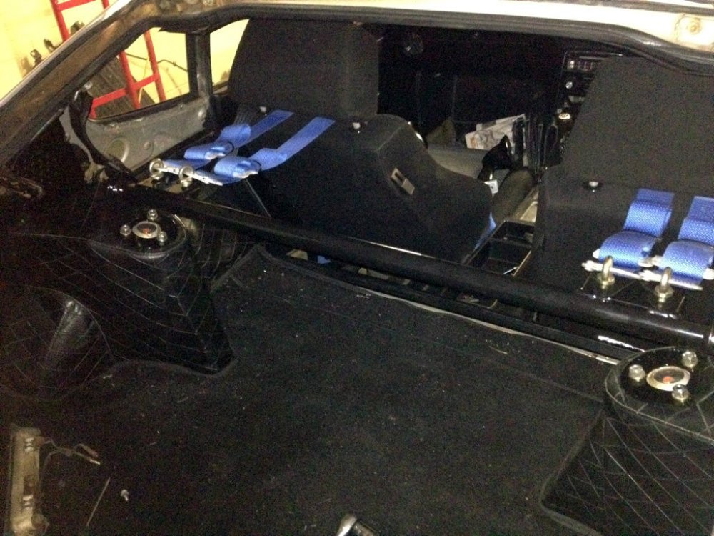

Rear strut bar came from Alan Steen at the Z Car Workshop. I had to paint it twice because i went against my rule of only using kill rust and grabbed some Dulux from Bunnings which on the second coat had a weird reactions resulting in me having to re-strip the bar. Nothing is ever easy is it?  ::)
Posted Image
I put masking tape all over the harness mount points because i couldnt bear the thought of scratching my new paint. I think some rubber piping on the leading edge should fix it up when i get a chance.

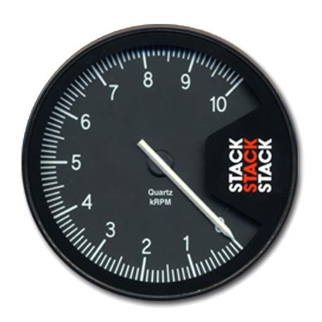

I installed an AutoMeter 5" Monster Tacho, as the stock tacho didnt work with the Crane CDI. These tachos are good because with a couple of layers of electrical tape around the outside of the tacho mean it is a nice and tight push fit in the dash. Scored this sucked off eBay for $50 posted bargain!
Posted Image
It's a temporary measure as when i come across one cheap enough, I will be replacing it with this:
Posted Image

Love the 'stack' tacho, looks hot  8)

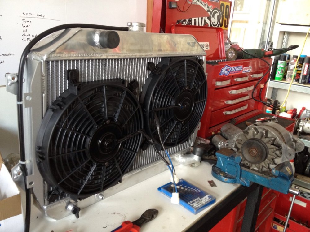

Posted 13 November 2012 - 09:09 AM

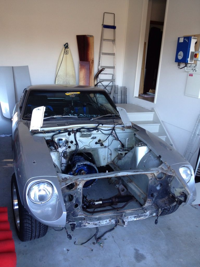

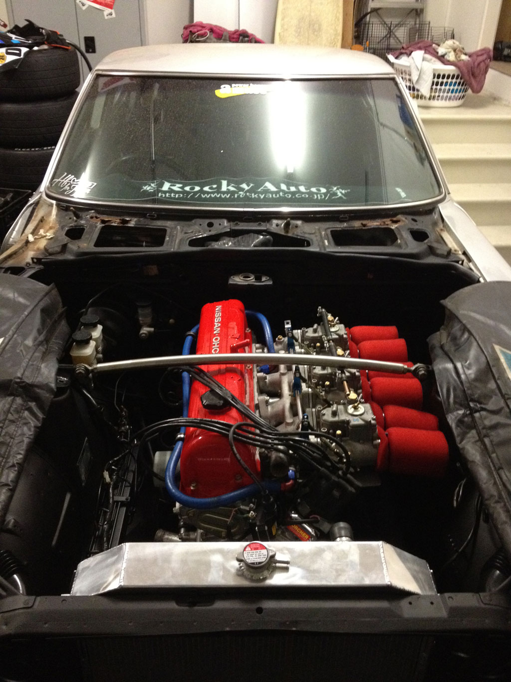

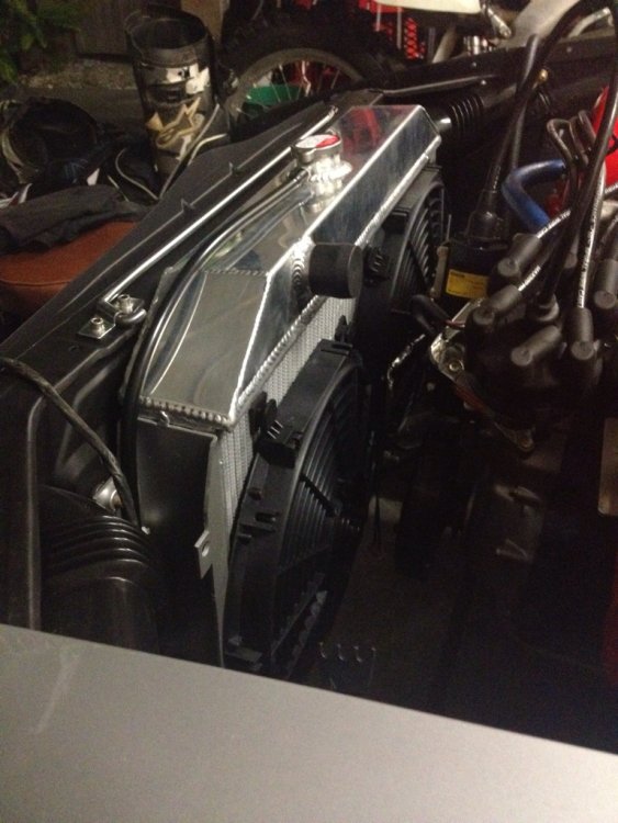

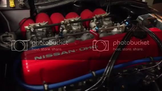

Shit just got real. The engine is in thanks to Doug helping me on Friday night. eBay alloy radiator that is the size of a large intercooler fits up well too. We test fit my two 12" thermos and there is a perfect amount of clearance to the waterpump, massive ATi underdriven pulley and all that stuff on the front of the motor.
Now all we need to do is install the new Carter 4070 fuel pump, some new... fuel hoses, mount the adjustable fuel reg, hook up the CDi box and the radiator hoses and she should start.
You can see the two nasty rust holes near the wiper stalks that I would like to address too, although they are not structural so maybe i just put the cowling pannel over the top and forget about them until the whole body redo.
All the removable brackets will be painted silver for a bit of contrast, as again i will save them for powder coating/zinc plating when the body is rotisseried in a few years.
Any ideas on whether to bother with the foam that sits on the guard supports and the sealing strip down the side?
