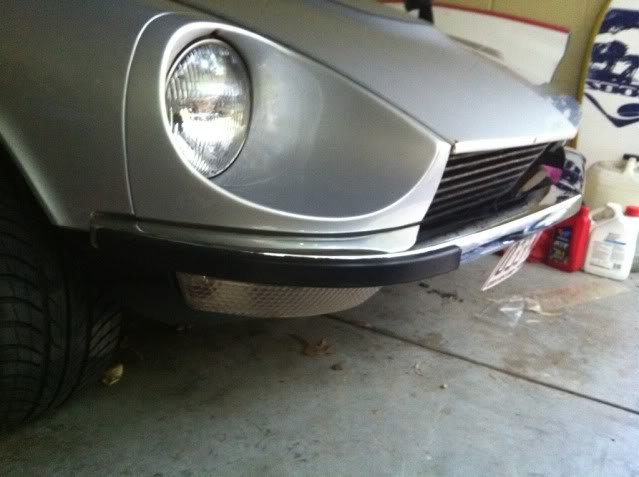

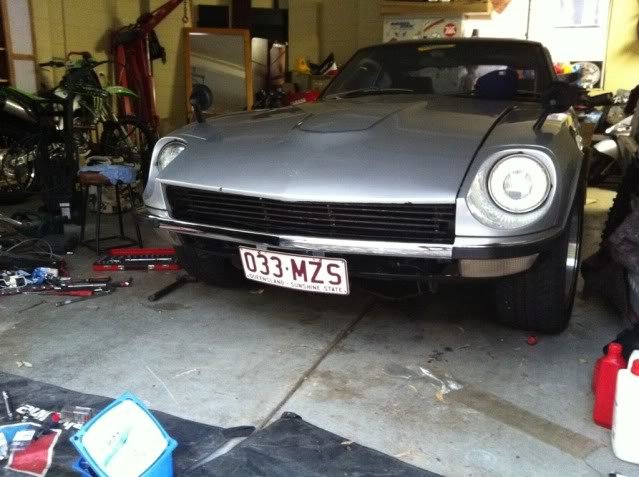

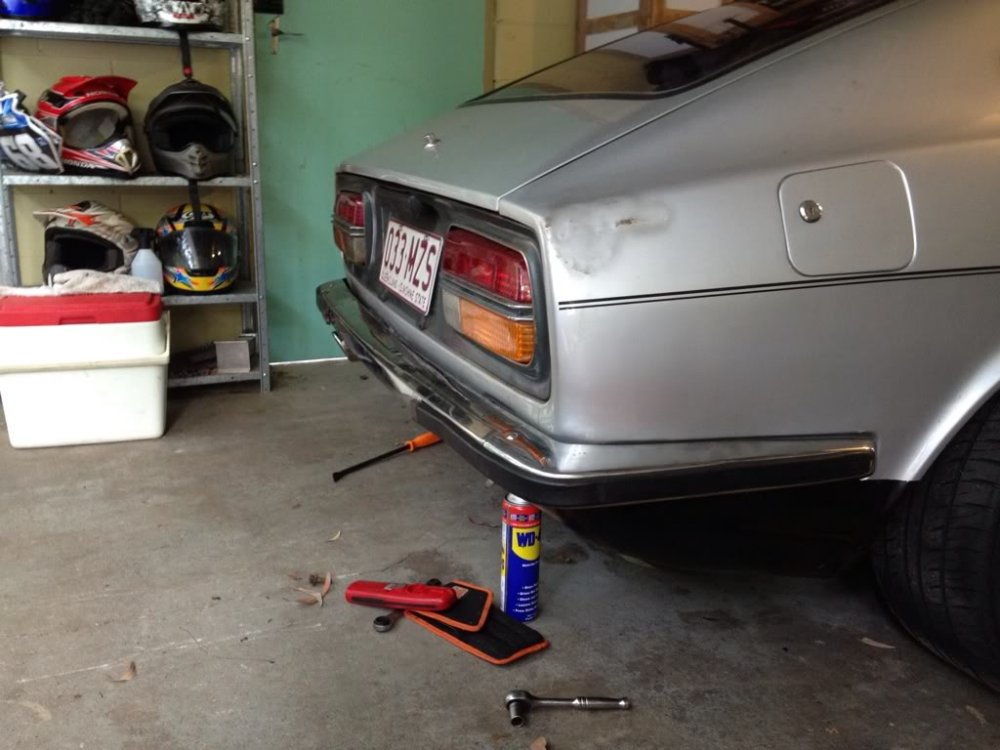

Got a new repro front bumper and rubbers off the New Old Car Company (aka Phil's Rotarys) on the Nth Side of Bris. Picked it up for $316 which was a steal + $62 for the rubbers. It's a neat bit of kit and is good quality for the money and really made the front end of my car look 100x better because i had the ugliest banged up front bumper out there.
Posted Image
I knew the front of the car had copped a bit of a nudge, didnt think it would take two hours to get it to fit the way i was happy with (i'm a bit of a perfectionist when it comes to silly things like that). Also managed to spend $30 on bolts down at supercheap, new high tensile everything for the bar and two boxes of stainless allen screws for the numberplate and the grill bolts.
Posted Image
Chrome is pretty hard to take a decent photo of especially in the shaddows of your garage. Funny thing is now i can see all the rust and crap under the front of the bonnet. Will have to break out the silver killrust when i get a spare minute on a weekend. Apparently they are going to have new rear bars in around two weeks and i will definitely be getting one of those to match the front!
Posted Image

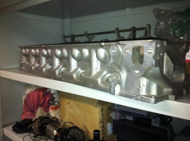

Whole reason for starting this thread was to show PMC what engine bits i have collected, so hold on to your 56kbps modem we're going in for a pic blitzkreig.
Posted Image

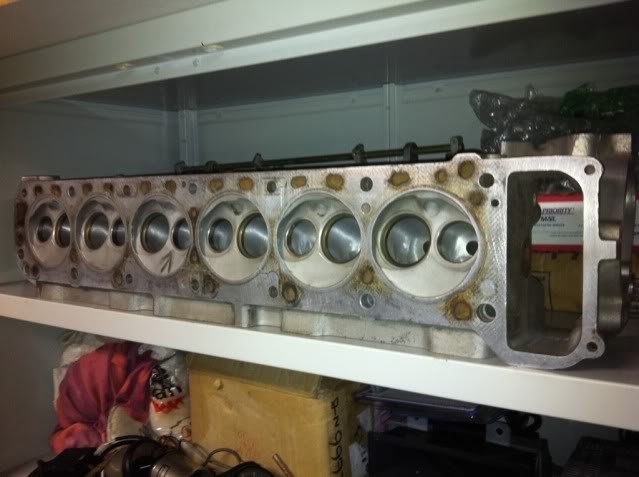

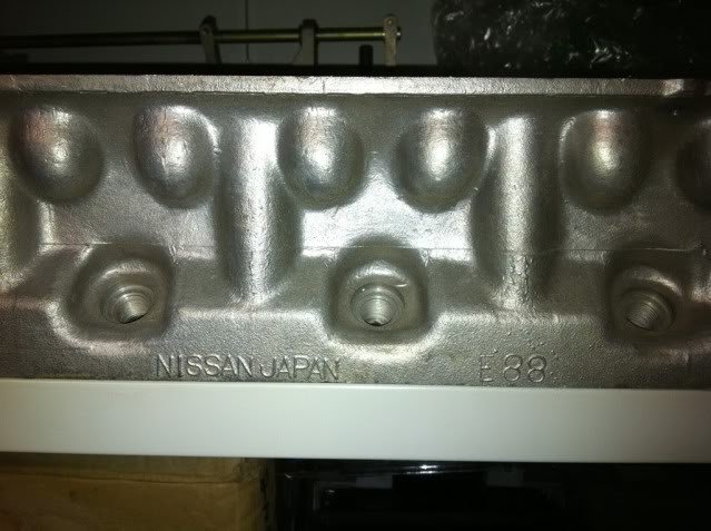

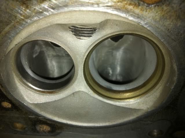

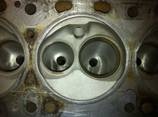

Virgin E88, original deck height (hasnt been planed) and no corrosion. Ported by DLPE (Don Potter) in the states. "Set up for 44mm Inlets 37.25 Exhaust, to run on engines 2.8L and over."
Posted Image
Posted Image
Posted Image
Posted Image
Posted Image
Posted Image

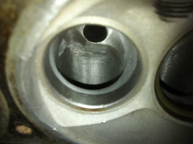

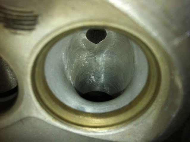

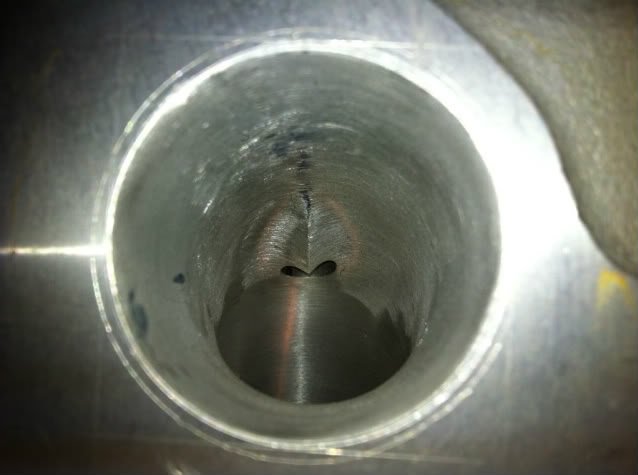

I'm guessing the porting isnt quite finished because the #3 and #4 exhaust ports are bigger than the others:
Posted Image
Posted Image

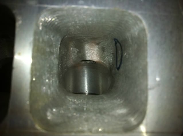

Black circle = pin hole coolant leak
Posted Image

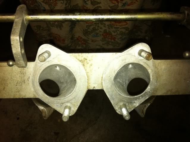

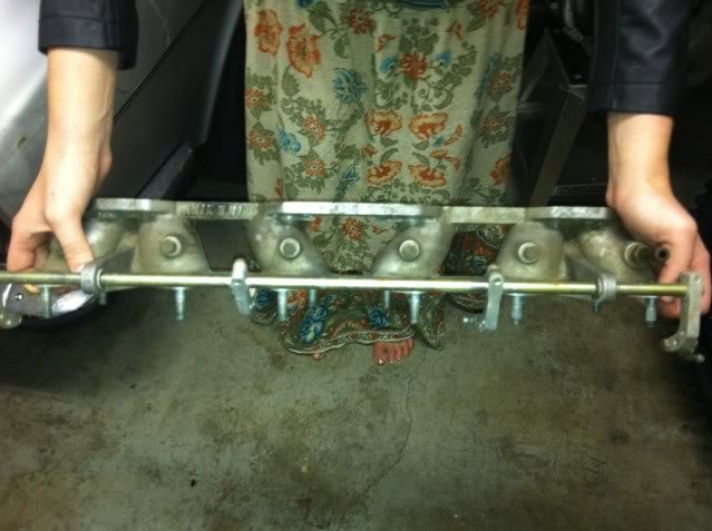

Short runner Mikuni mani - Hybridz loves it PMC hates it
Posted Image
Posted Image

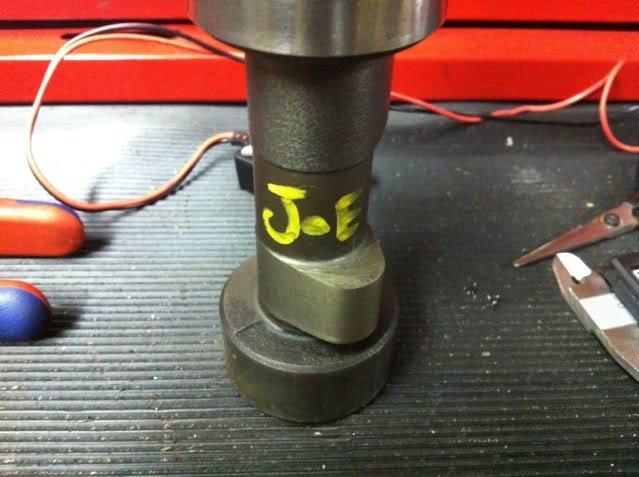

The chick from the black eyed pees wishes she she had lovely lady lumps this big and wide:

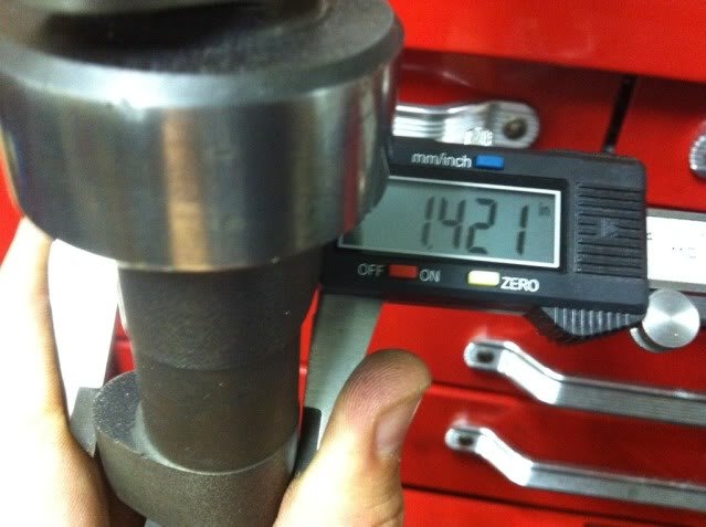

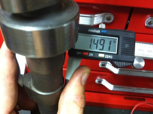

Americam - .555" lift 310/316 duration
Posted Image
Got fat lobes?
Posted Image
Posted Image

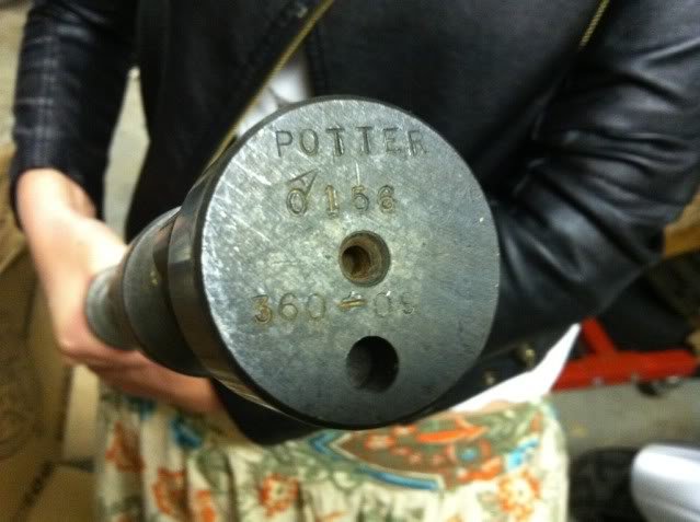

DLPE Cam - unknown (less lift than the other one) - "bigger than rally, smaller than all out circuit/drag cam":

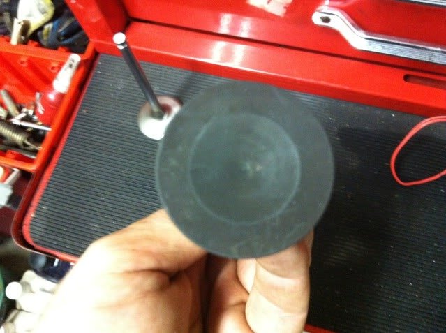

Inlets - 44mm DLPE hand swirl finished Nissan valves:
Posted Image
Posted Image
Posted Image

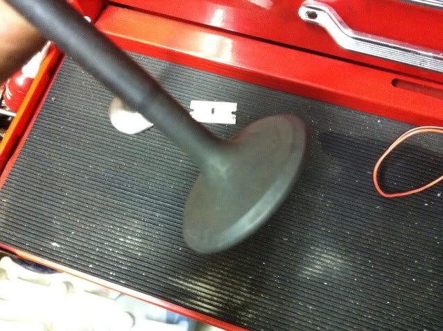

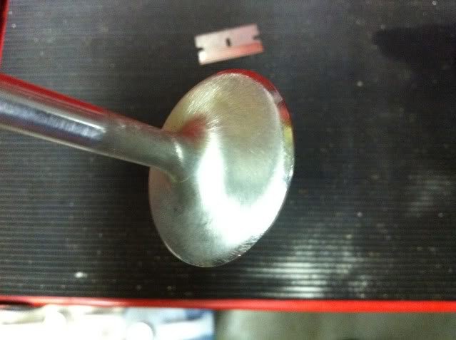

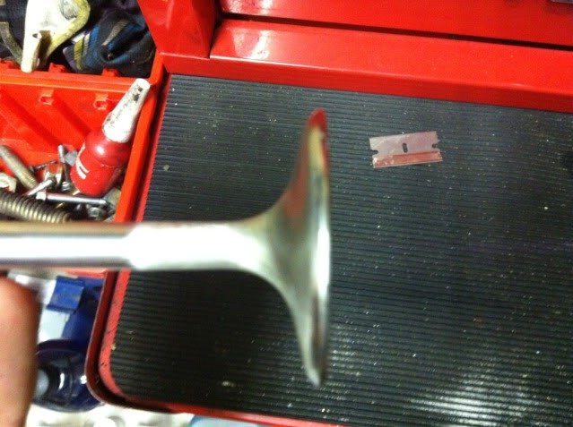

Exhauts - 38mm SI with "Black Knight" Coating **I have two spare sets of these for sale! PM me if you want some hardcore exhaust valves**
This model features an undercut stem in the head area. In addition to reducing the valve weight (which provides benefits in opening rate and RPM limits) the radius of the head is such that is significantly improves air/fuel flow. This model enjoys great success when used with stock heads, as well as modified versions. Many available with Black Knight coating. Fully swirl polished. Chromed stems and Stellite tips.
Ideal for tough racing applications of all kinds. Bonza

Is that you with the lovely lady lumps and the floral skirt?

nice the second cam is the bigger cam it has a smaller base circal so it is much bigger
pin hole in the port not so good will need to test it to see if it can be fixed, it may end up in the scrap :(
I would assume that Jake zeroed the vernier on the base circle Peter, the 14.xx is the lift?
#9 peter mc
peter mc
  • 1,573 posts
Posted 29 September 2011 - 10:25 AM
don't look at the vernier look at the Base circle. you don't mesher a cam with a vernier, the small circle means they have removed more to get more lift on the other side  ...  , and the ports on3/4 are bigger from the factory he may have hit water and stoped /i hope we can fix it for the potter name he was the man in the day

The info that Don Potter had with the head said that the head could be welded - there are two spots. Holes only showed up when the head had some dye treatment put on it. I was doing some reading on hybridz last night and apparently Potter was known for building Electromotive-beating L28ETs so i figure his cam and head should be a good place to start.

@Simon: No i didnt zero it - it was just for comparrison of lobe height.
@Handsandwhich: I was tossing up whether to lead you on with this one, but no that is my girlfriend. I thought you guys would prefer a female parts model.

:-*Found the Americam Specs i had saved away:
CAM LIFT IS 555 WITH 300 INTAKE DURATION 316 EXHAUST DURATION
CAM IS GROUND ON 111 DEGREE LOBE CENTER
BRAND NEW CUSTOM GROUND CAM
USES LASH CAP # 263

aren't ex.ports 3 and 4 bigger from factory??
#13 d3c0y
d3c0y
  • 2,950 posts
  • Location:Brisbane
  • Tagline:Forum Jerk
Posted 29 September 2011 - 12:17 PM
Apparently so, Pete mentioned that just before too.

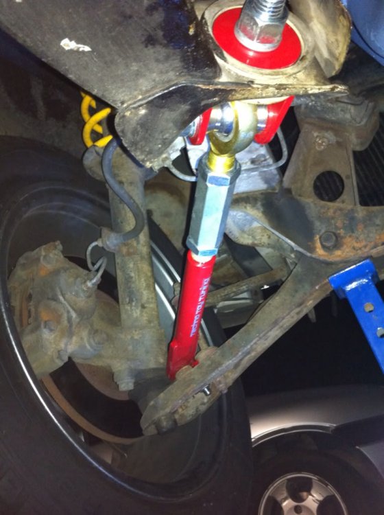

After 3 months on jack stands contemplating putting in some new Techno Toy Tuning T/C rods, Christmas hols gave me an excuse to finish what i started.
Posted Image
New shiny red bits in a sea of rusty body parts. I'm going to get it set to +6 degrees castor and 1/8th of an inch toe out.

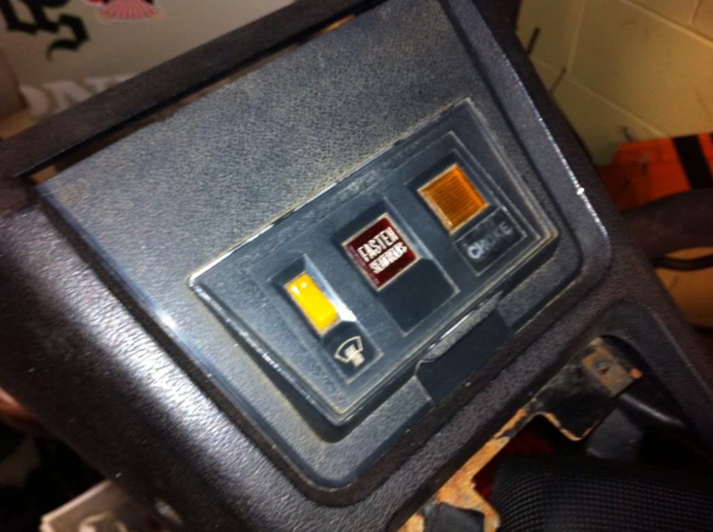

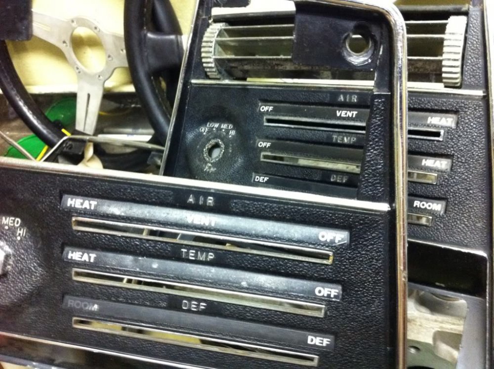

I also bought a few heater fascias from the states.
Got one in pretty mint condition but of course nothing is as easy as it should be...
Posted Image
For those who didn't notice all the controls are back to front on the US one.
The US one is on the left in the photo below. It's got an extra horn on the top, but i have no idea what it is for. Luckily it looks like a matter of swapping the push rod cables from the AU spec to the US one.
Posted Image

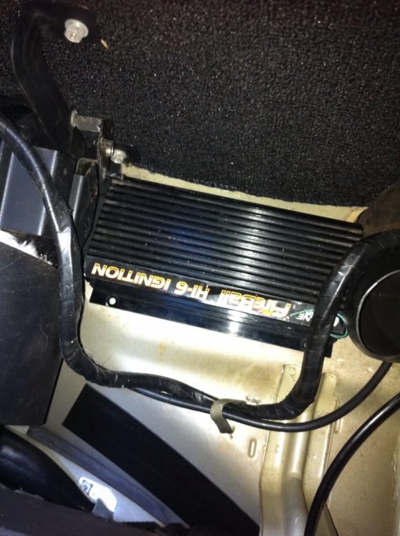

Another tidy up I have done is to move my CDI box which was sitting where the stereo would go (behind the heater control fascia) to under the dash, behind the glove box. It wedged in there and i used a large square of double-sided 3m Velcro in between to secure it properly. It's completely out of the way and out of the elements of the engine bay.
