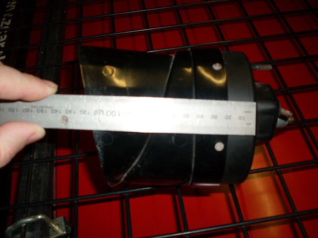

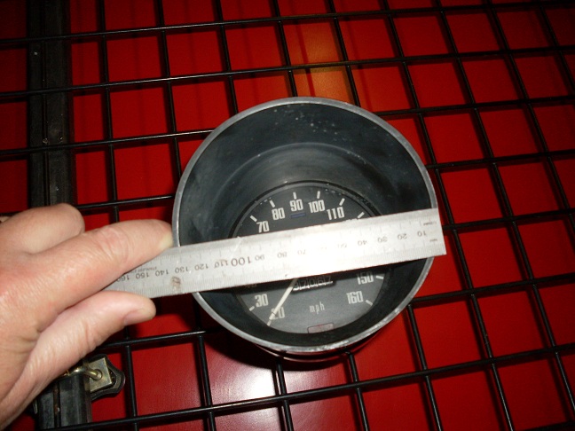

Here are some pictures of the standard gauges just in case it helps.

5" gauges work well to completely replace the speedo and tach, while 2 5/8" gauges work well in the trio. a 2 1/16" gauge fits well into the clock cup, when the clock itself is removed, but the ring is left in place.
The drawback to this usually is that you need to find a place for at least one gauge, if you want to replace all of the existing gauges with single units, and lose the clock. You will also have to find a way to have indicator, for signals, high beam and brake somewhere.
I did this for a while, with all Autometer gauges. I'm slowly going back to a more stock configuration as I swap out the Autometers for something else.
4" gauges seem to work well to replace the guts of the speedo and tach.

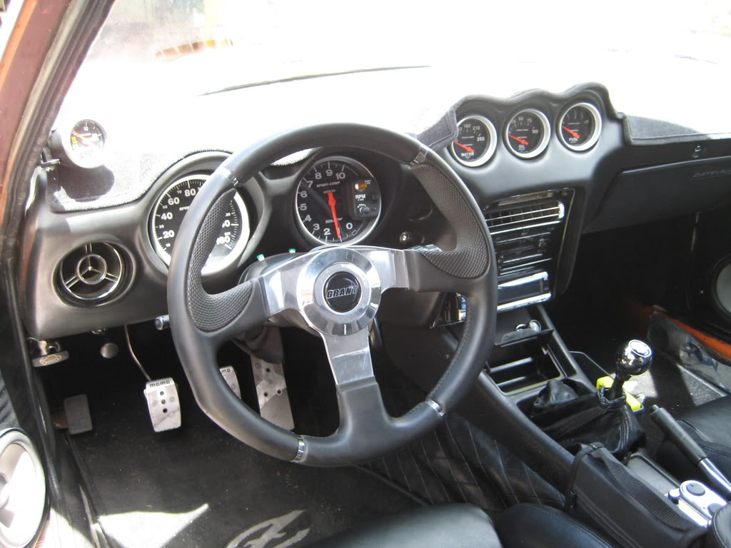

There are some pics and vids of the gauges I installed in my build thread in my signature below. And how I worked around the indicator issue.
