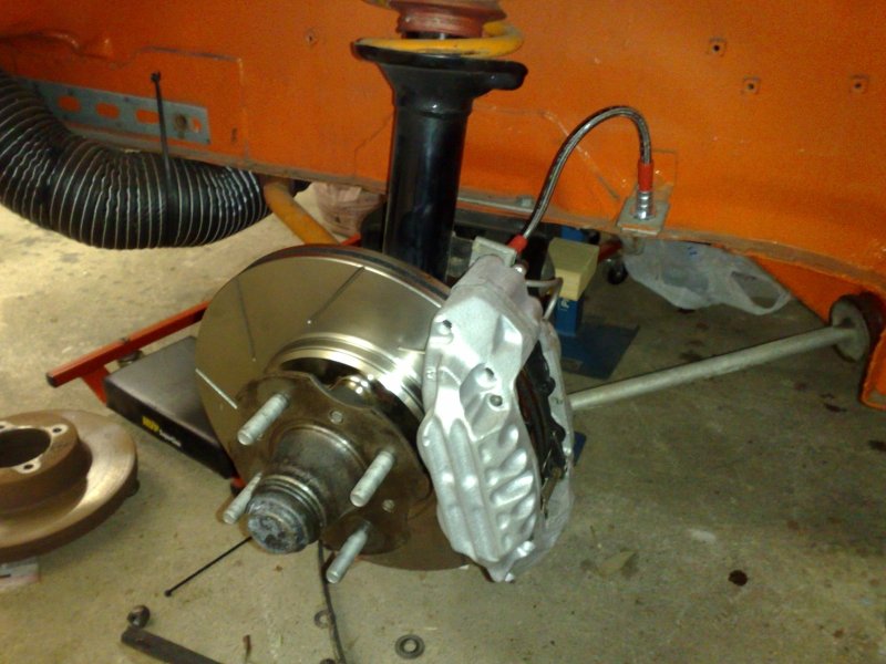

pics of calipers to compare turns out my +8's are the narrow ones so ill use the new ones with silvia disk

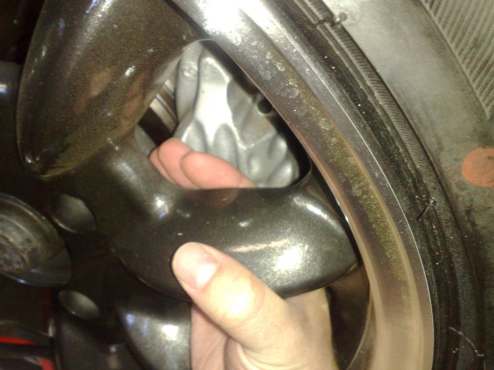

and to confirm that 513 16x8+0 will clear and this is without caliper bolt spacers that will make more room

Hey again the +8s that i have are for the solids the guy thats doing my disks had a +8 with the bigger gap they DO fit over the silvia disk but man its tight and so is the s12w that i have
ill break out the verniers when i can find them  :o but i think theres some factory variance because the "solid" calipers gap i have are WAY narrower by eye than the vented
also i now need to get the caliper moved out to clear the 280mm disk because i cant machine the outside down and dont want to waste the disks and the s12w is probabyl too big to make work on the street at this rate i should have put vt fronts on!!!
