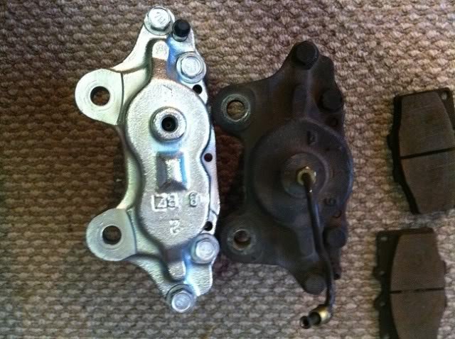

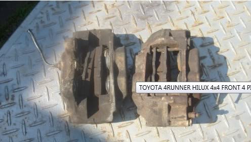

I'm about half way through this conversion.  I purchased a set of 1988 4Runner S12.8 calipers off ebay for $76.50.
Posted Image

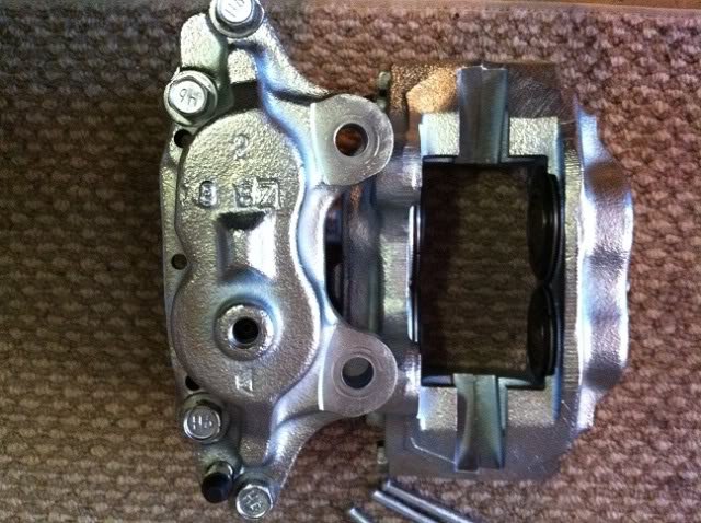

For my own safety and to make things a little more future proof I got them reconditioned.  I live on the Northside of Brisbane so I dropped them into "Stainless Steel Sleeving" at Brendale and for $132.00 each, they came back like this:
(I was most impressed)
Posted Image
Posted Image

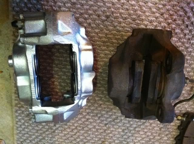

Comparison next to my original 71 Zed calipers:
Posted Image
Posted Image

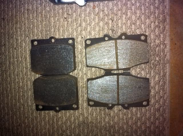

can you post a pic of the pads side by side, so i can see the surface area difference  :D

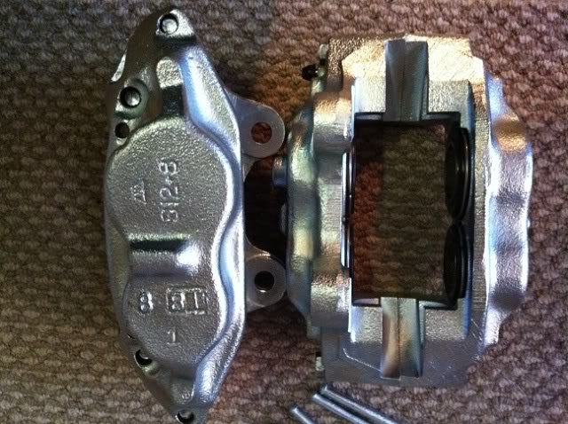

ive got a mate giving me a front diff from a 60 series landcruiser, which has the vented disc and caliper setup that i am going to put onto my 81 hilux. then i will be left with these same calipers to stick on the datsun :D hows that for recycling.

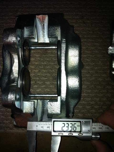

Here are the calipers side by side as requested and a pic of the caliper gap, which is 23mm.  This should suit the S13 rotors at 22mm nicely  :D.

I may be wrong but I was woried if 0.5mm each side is enough clearance, do they flex under heavy load? What if the disc warps? So i machined mine slightly larger. The RX7 pads will be deeper again than the hilux ones, if it's just for road use GSL rallysport have an A1R pad that will be more than up to the task.

From what I can find the original rotor that these calipers matched to was a vented 20mm.  In the USA some people match these rotors to an 1988 Toyta Cressida front vented rotor that is also a 20mm rotor.  I guess it will just be a case of finding a rotor to match or grinding the caliper gap to fit the rotor.

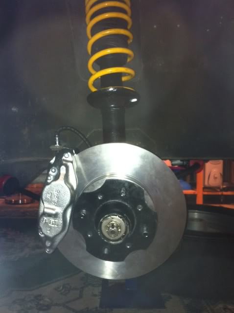

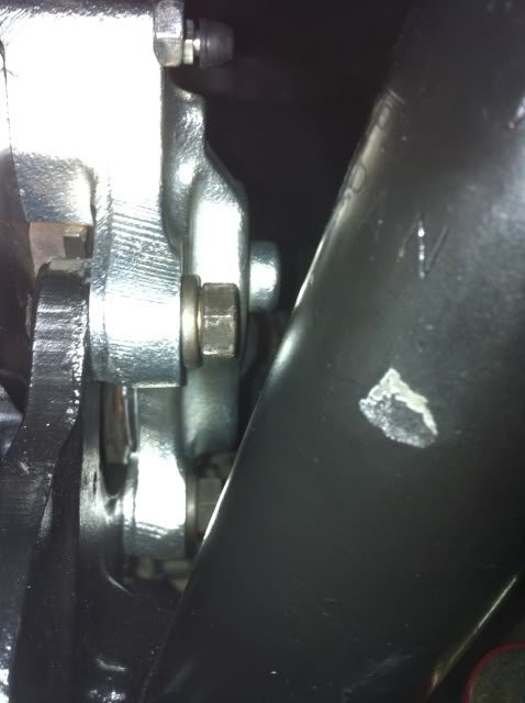

Posted 17 November 2011 - 06:04 PM

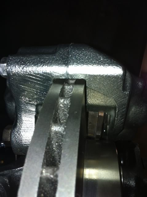

So I've had a bit of a tinker with some stainless washers to find if I use only 3 x 1mm washers between the hub and the rotor bolts it all shapes up pretty well.  I will however need to widen the gap in the caliper as it's only got about a bees packet either side.  See in photos.  What's the best way to widen that gap?  Probably only need 2.5mm either side.
Luke

#20 Riceburner
Riceburner
  • 3,266 posts
Posted 17 November 2011 - 08:24 PM
If I remember correctly I machined around 1.5mm from each side when my calipers were apart for rebuild. 3mm doesn't sound like enough spacing, just double check the disc centered in the caliper.
