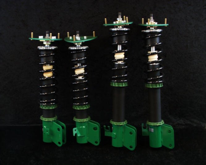

does anyone know if they make Tein coilovers for our cars? off the shelf stuff?
Posted Image
Cheers,
William.

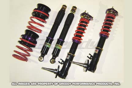

Oh since this has been restarted i might add...
Our front struts on the 240z is a similar design as the AE86.
I wish Greddy would release it for the Zeds as they are so similar.
Rears on the other hand are different as the AE86 has a separate design, solo spring and solo dampner design.
Also wondering, does anyone have measurements from top to bottom (height) of the front strut with the coil over setup?
