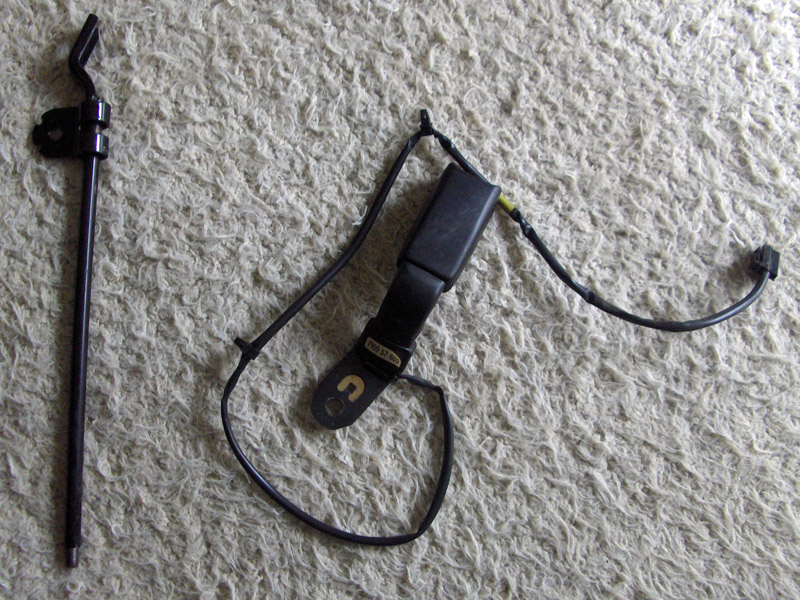

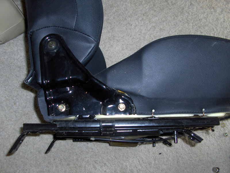

the rx7 rails come with an extra bar on them, to strengthen the seatbelt mount i assume, which can easily be removed along with the seatbelt, then all that needs to be done is to bend the rear mount down onto close to a 60degree angle to match the zed, where orginally its straight. i clampled where i wanted it to bend so not to put the force onto the rivits when doing this. then the only thing that needs to be done to the zed's body is to drill out the hole at the front of the rails an extra 1mm so the locating pin on the rx7 rails can slot in.
the drivers side one is slightly wider althoguh can still be made to bolt in just as easily. however mounting them like this makes them noticably to high and not centered by about 2cm, so i took it back out and grinded off the bits of the rx7 rail that stop it from sitting as low, which means i can't slide the seat back as far, but i double checked that this would suit me fine before hand (and it is only about 3 positions shorter than the stock rails let you slide back to anyway, but for some reason the rail is longer than it allows you to slide, if that makes sense), i dont have any pics of this, but now it sits alot closer to the same height as the stock seats, although i do not know if it was worth the couple of hours this took to do!

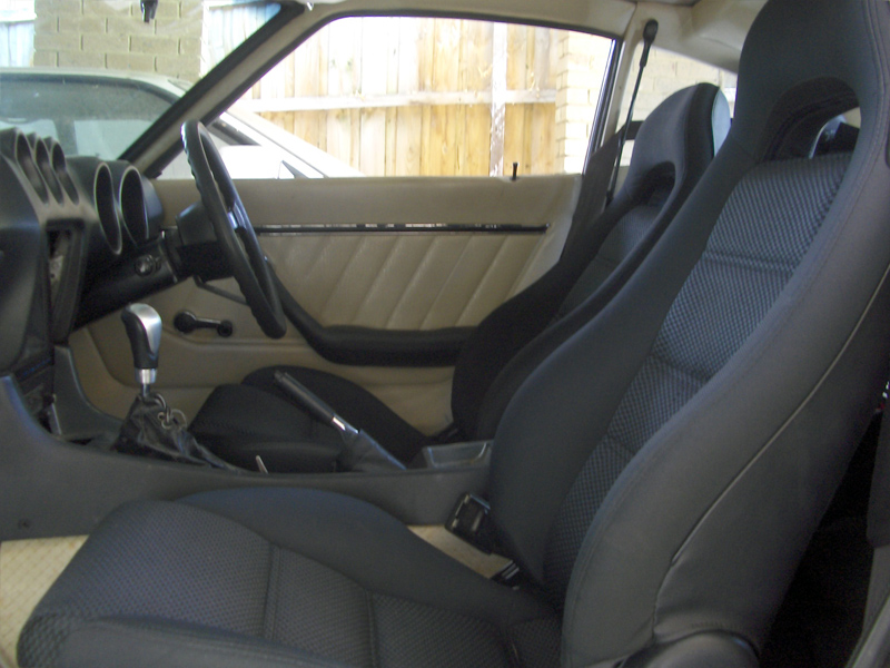

and a pic of them installed, you may just be able to tell the drivers seat is a bit lower, i may do the passenger side when i can be bothered, but with the drivers seat it was nearly at the stage where it was hard to get in and out due to the steering wheel gap
