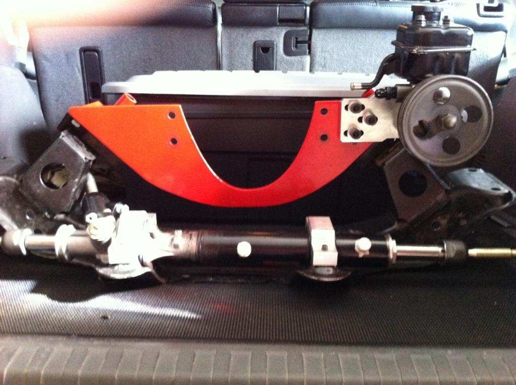

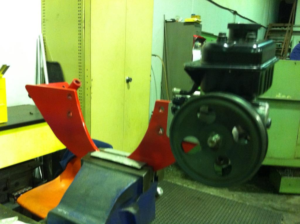

Just about all completed and ready to go back into the car. I have attached two photo's of the power steering pump mounted to my engine mount. Obviously this mount is for my V8 not an L26. This pump will sit really low in the engine bay. You will hardly see it which I like. Less clutter.
I will take a few more photo's this weekend when I do the trial fit up before putting on the oil lines and powder coat the cross member. Cheers
Oh and Dave we are thinking this rack has a progressive steering pump so we don't think I will need a restrictor in the oil line. We will just have to try it and see.

#13 jamo240
jamo240
  • 429 posts
  • Location:Melbourne
  • Tagline:New Member
Posted 04 August 2011 - 07:30 PM
Hi Craig
I had the fluid lines for my Subie rack/skyline pump setup made up by Enzed Bayswater. Jude knows all about them, and will crimp up what you want. I made mine up out of a combination of the R33 skyline parts and subaru parts. When I pulled the lines apart, I found that both cars had restrictors in the pressure line going from the pump to the rack. The restrictor is crimped to the end of a flexible steel pipe that is inside the rubber hose (it is actually crimped into the inside of the rigid pipe that bolts to the pump). The orifice diameter that the fluid flows through is about 2-3mm. It's easy to include it in your system. In my case, the ''other end'' of the flexible steel pipe was crimped into the rigid pipe that bolts onto the pump (via a banjo bolt), and hence I removed the rubber hose by removing the existing crimp (cutting off the factory crimp backshell) and pulling the old rubber hose off (thus leaving the flexible metal pipe in place on the rigid pipe with the orifice hanging off the far end), and then I put a new hose on of the desired length and then had Jude crimp the whole lot back together with new backshells so i ended up with a factory looking fluid hose with the factory orifice in place.
Jamo
#14 620Z
620Z
  • 1,710 posts
Posted 05 August 2011 - 09:31 AM
Hi Jamo, excellent info. Thanks. I will try and do the same then mate. As I want it same as factory. More pics to be put up later today. I have the whole lot in the back of my car this morning. Cheers
