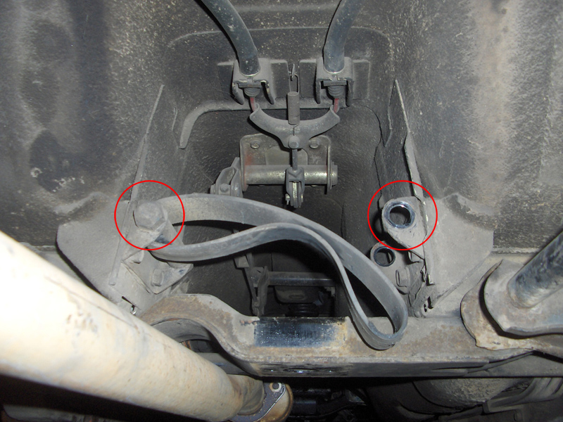

i found another mount which leaves all the top strap etc, but has a small loop of folded steel with a slot to allo a lil bit of give but give it a bit and would limit out (only about <10mm).
heres the pic:
oops i see its a small rubber/poly pad, bbut id like/prefer this to the other but only because it looks so clean etc. and leaves the stock strap in place.
need to make sure you have a good insulator on the cross member of course.
nato

Although I only run a R180, albeit welded, and different ratios, 4.1 or 4.4 or 4.8, depending on circuit or application, the old chain has worked well for a lot of years with no failures or bangs from the diff with a 6000rpm side step off the clutch for starts. I can't see much more abuse to the driveline than a race start :shock:

Oh well, my vote goes for the chain as well. It worked for the past 15 years in the rally car. Cheap easy mod.

hey gday, has anybody got any photos or diagrams of the chain setup ? im fairly new to independant bums and i have no idea what you mean or how its set up ? - thanks chris.
