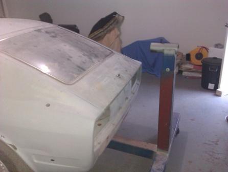

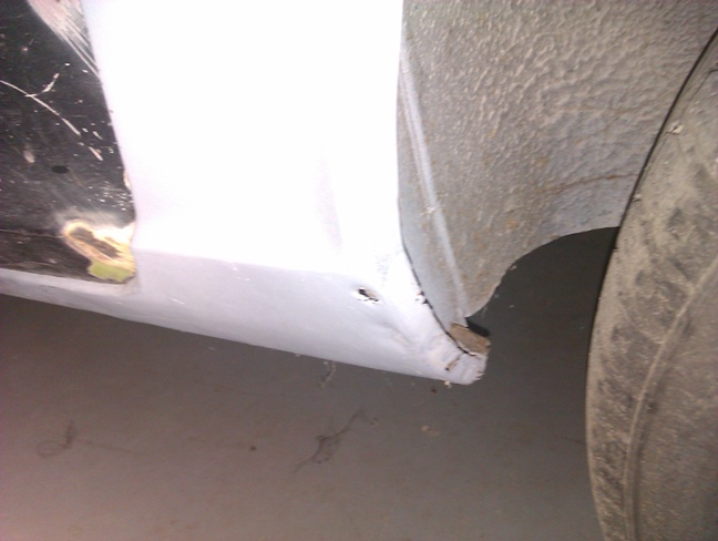

Okey Dokey,
so what needs doing?
The first thing to do is lift the shell onto the rotisorrie.
Some minor (for them that know what they are doing) repairs to the back right.
Two x doglegs, the bottom few inches of the front guards, new floors welded in and tow door skin replaced.
Sounds doable, eh?
Lurch is bring his Mig so with mine that means 2 Migs going (pending house fuses coping).  I've got a great compressor (thanks Rev), but no spray guns.
I'll need to get some etch primer (what brand?).  What else do I need to buy to get some of these body repairs done?  Please PM the list John & Rev.
I've got the door skins and will get the floors in the next week or so.  Lurch has offered to make my dogleg patches, if I ask nicley he might also make the replacement bits for the bottom of the front guards  ...  PLEeeeeeASE  :-[  :'(  ;D  8)

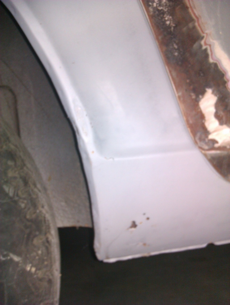

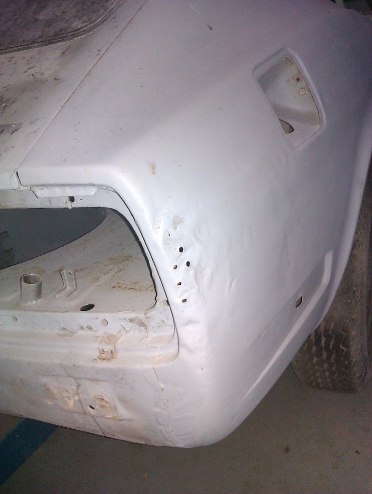

I know it doesn't look to bad.  I can hear the "You should see mine.  He's got nothing to worry about.  He's such a girl's blouse." etc
To that I simply reply, "Shut up Lurch."
I'm planning on having it all blasted before you all arrive, so there are no hidden surprises after you leave.

Simon,
That 1/4 don't look to bad, but its a double panel in that area I'm pretty sure it wont be that hard a task to get back plumb.
I will bring my spray guns, along with a moisture trap, as far as materials that isn't a problem, I can pick up a whole lot of panel prep consumeables and you can fix me up later, the big question is priming? regardless if you go acrylic or low bake down the track, I'm inclined to suggest EP as I'm sure REV will agree, if that's the case I can pick that up as well as the distributor and factory are across the road from each other in Sunshine 10 minutes from my place.
Guess that's the big decision you have to make, cost wise it 6 of 1 and half a dozen of the other.
Give me a call when you get a chance and we can discuss.
Also I put Kato David onto a bloke I know that I met up with a few weeks ago after about a 15 year lapse, he used to work with me at the Mercedes repair shop, he now runs a business called Restoblast using plastic media, he picks up from all over Australia and is very reasonable price wise, if you want to speak to him and get an idea on price, Ive seen some of his work and its exceptional.
His name is Johnny and number is 9971-5889, just tell him John O referred you.
John
