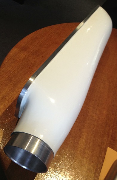

Depth is approx. 90mm at the front carby and 75mm at the rear leaving around 30mm clearance between the lid and the strut tower (on Zed)
I don't have the time to collate interest so if someone would like to take this on and collect deposits, once a $1000 is raised I'll get the mould underway (fully refundable if the deal falls over for what ever reason).
Backing plates will be blank to allow multi use applications, as I'll need to remove the entire induction system to take the airbox off the carbs, if/when enough interest is raised I'll start the ball rolling again and confirm pricing, hopefully the $400 each mark should still cover costs.
The benefits as stated previously are more mid range torque, far less noise and you can plumb in the crank case and rocker cover vents to comply with EPA regs (catch cans are not EPA friendly). The set up looks factory fitted and can be used with a 280z filter housing (from the US S30 with the injected L28 easy found on ebay) which bolts straight in front of the radiator and far superior to pod filters (again proven by dyno testing) .
Anyway guys I'm happy to go to the effort to get the air boxes made but l'll have to leave it up to one of you to champion the cause and collate interest and chase deposits.

Gav
The air box is fitted to my Triple 44 Mikuni's so yes it will definitley fit , and Webers as well...........the variable is the length of the intake manifold.
If you have a minimum 120mm between the carb throttle body and the strut tower it will fit
The plan was to make the airboxes with a solid back plate so it can be used for 40's, 44's 45's etc,  so it can be used on Dellorto's etc as well.
I can make a template for the holes so it will be easy to mark out the back plate for drilling to suite Mikuni 44's and Weber's will be very close.
For the period look, you can get them painted to a colour of choice rather than leave it in natural C/F as the finish would be clear gell coated and smooth.

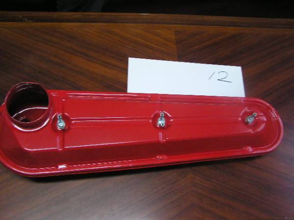

Here are the pics as shown on the auction

Well done !
Did you get the rubber 90 deg elbow also..........these are rarer still
Al.

Well done mike, I was very nearly your bidding competition though, I was waiting for some cash to come through but it didn't happen so I had to let it go. I think the seller actually started the bidding at 30,000 yen then bumped it to 39, maybe he was worried no one was going to bid ;)

Thanks for not bidding Mark  8)
No Alan it does not come with the 90 elbow so I will have to sort that out at some stage.
