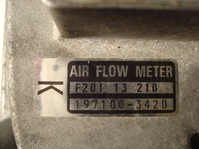

The AFM was from a Toyota, sorry didn't get the model, But it was a four cylinder and the AFM was attached to a air box, and I believe it was a 1999, silly bugger I am, but I was more exited to find the part. but I will go back to Imlachs this Saturday and have a look, ( cause i feel guilty ) but there were at least six there that i saw, $30, not a bad investment in my books.
All were labelled with an AIr Flow Meter sticker and a model number etc.
I have taken photos of the label and the whole inside of the unit and will post them on in the next couple of days..when I learn how to do it on here..

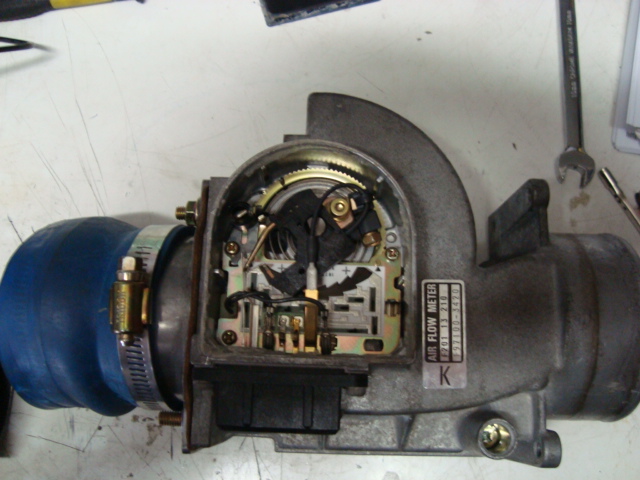

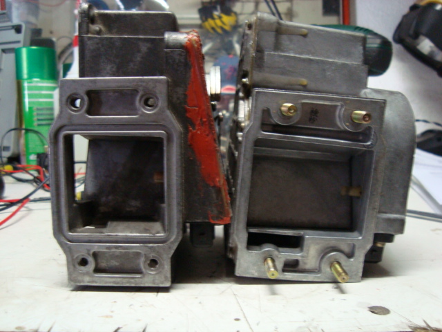

here are the pics of the Toyota AFM,  all is still going really well, took it for another drive yesterday and I am still very happy..
Like I mentioned, no need to modify anything just pop it in and away you go..only thing I did was tighten the spring three teeth..
alan

finally got to the wreckers today, i got my AFM off a 99 Toyota Camry, (4 cylinder, east west motor)
just make sure you get the same shape as what i got photos above,, the square shaped plastic covered AFM are MAP versions..and wont work..
Good luck

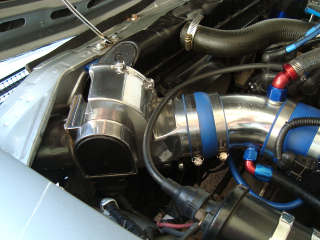

Got mine on Saturday. Modified it over the weekend and it is now in the car. I haven't tried it yet.
A couple of additional notes:
The end closer to the air filter on the Toyota item does not have anything to attach the air intake hose. Luckily the bolt pattern matches the adaptor from the original AFM. Be careful though as there is the potential for a hair line gap out to the atmosphere. I used silicone to seal mine. Because this item is from the original AFM it fits in the same place as the old one (no need for any adaption). This adaptor has a restriction in the middle to reduce the flow area down to match the small flap area of the original AFM. Because the Toyota AFM has a larger flap area the restriction on the adaptor is not suitable. I filed mine down to open it up to match the flap area of the Toyota AFM.
The end closer to the throttle body on the Toyota is 90mm diameter. You will need an adaptor to down size it to match the fitting between the AFM and Throttle body. My piece here was home made to match my aftermarket throttle body. I was able to get the adaptor from Supercheap. It was a tight fit but I was able to make it work.
Sorry I forgot to take photos and now its in I am not taking it out because it took some effort to squeeze it in.
