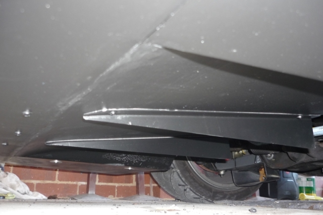

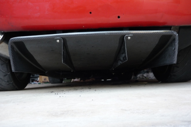

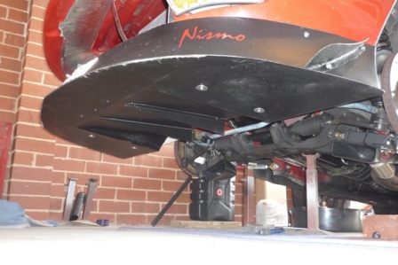

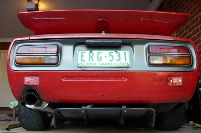

I have been busy adding some aero bits to the Zed,
Rear diffuser is now on and looking pretty good if I say so myself.
The front diffuser has been improved by removing the step at the entry and adding aero fences.
Now it's just a matter of getting on the track and trying it out.
cheers,
Sinisha

Got some pics of the front? That rear diffuser should work well providing air is prevented from flowing above it, from the pic I'm guessing the fuel tank has got in the way a bit.

How did the car feel at PI?  Did the diffuser feel like it made much difference?

Can't really say how much difference it made at the Island as I haven't raced there for 8 years!!
Have to say, what an awesome track!
But, I can say that at Sandown I have dropped about a second a lap.
I think it is mostly due to better rear grip.

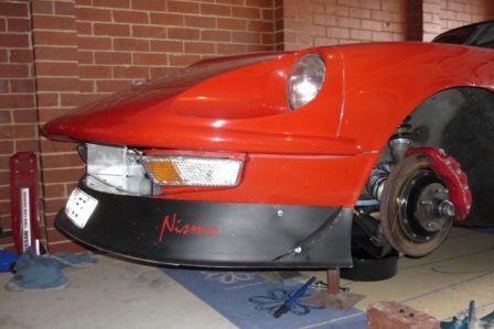

260DET, I have attached a few pics of the front diffuser, this has made a BIG difference to the front grip on my car.
cheers,
Sinisha

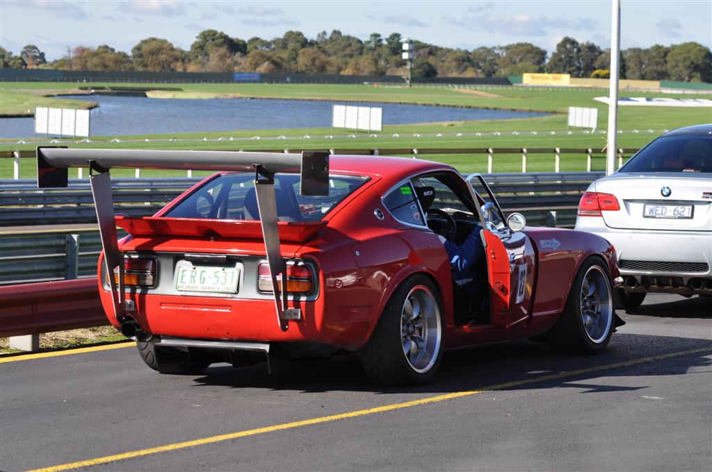

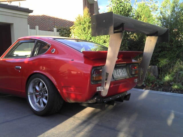

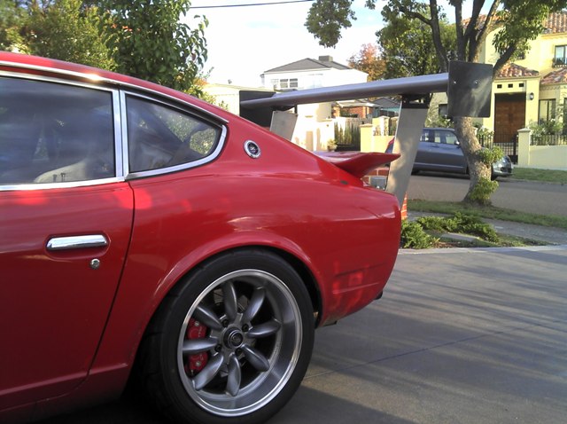

Here are some pics of the new wing, this is the first attempt with mounting height, will lower it a bit after Sandown.
Ran out of time to get the support blades right, looks a tad bigger in the pics compared to real life (looks like I have gone a bit "time attack" on the Zed)

Good thinking to mount to the bumper mounting points.  What sort of wing is it that you've used?
#15 Gordo
Gordo
  • 1,118 posts
  • Location:Lillydale
  • Tagline:Racing member.
Posted 28 April 2012 - 10:47 AM
OMG, it's not as big as it looks, it's bigger! If you are chasing rear end grip you just got it. You might need to put a stiffer springs in the rear because your gonna need it. I think you need to give the car a bit more rake.  ie. lower the front and raise the rear. Will be interesting to see the feed back on this one. Good luck in your quest for over all traction. Personally I think more rear end rubber would help. But 340 KW is a lot of grunt at the back wheels.

Some more aero mods.....
With the wing working so well I need to balance the aero better, so I have fitted a splitter on the front.
There will be some vertical air fences in front of the tyre to try and get some stagnation on that part of the splitter as well.
In the photo you can see a mock up for fitting purposes.
Looking forward to the MSCA sprint at Sandown to see how it will go.
P.S. I have ticked the passenger session.  ;)
cheers,
Sinisha
