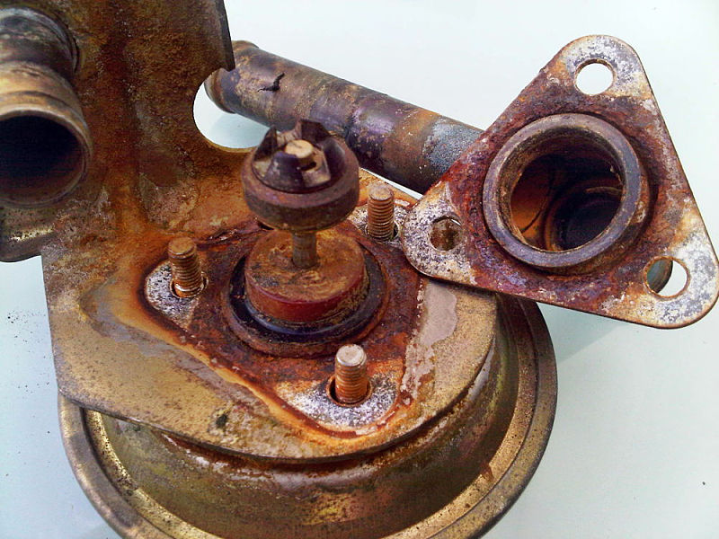

But today's big winner was a factory vacuum operated Heater C0CK Valve used in the air-con version, I was about to put in the recycle bin until the price of a replacement $250.00 + got the better of me, and which I repaired for less than a $5.00 !
Here are a few pic's, I will document the strip down and rebuild process tomorrow.

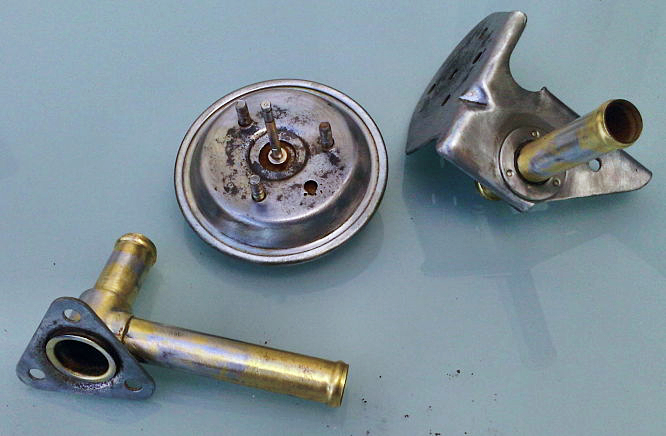

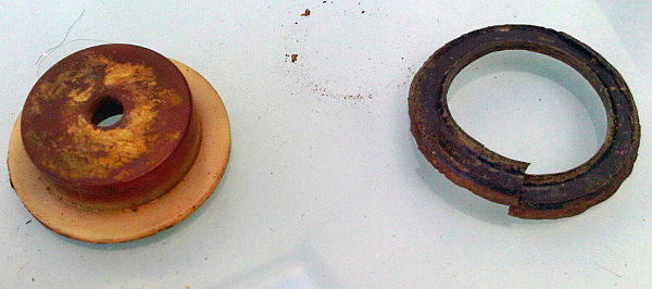

OK, so from the pics above you can see that the valve was in a real mess, and the prospect of forking out $250.00+ for a replacement or retro fitting something else just didn't appeal to me.
So I decided to strip it down and see what had failed and what could be done to refurbish it.
The main components were intact and still very functional, the main diaphram and shaft were in good operating order, the base valve plug its inner washer and "O"ring were dine as were the main head plug and stainless clips, however what had failed was a cheap plastic factory "O" ring which sat above the base plug and which sealed the waterway when in the open under vacuum position, this meant that coolant was allowed to seep through the back and therefore escape ending up on the inner cabin floor and also rusting away the diaphram and associated brackets.
This is a picture of the culprit on the right of the shot.

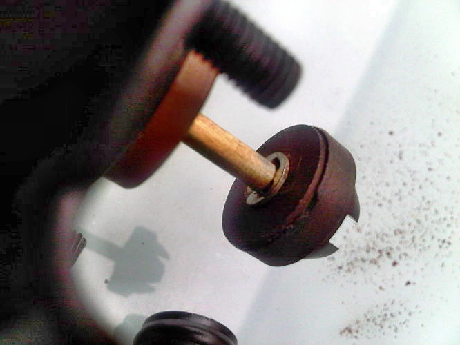

On the reverse side of the base are 2 components, a rubber seal which insulates the shaft from seepage and also a locking washer, these were both reusable.

These are the before and after shots of the valve assy after I had cleaned them up, the rusting was negligable and the pitting would not effect the function of the unit once completed.

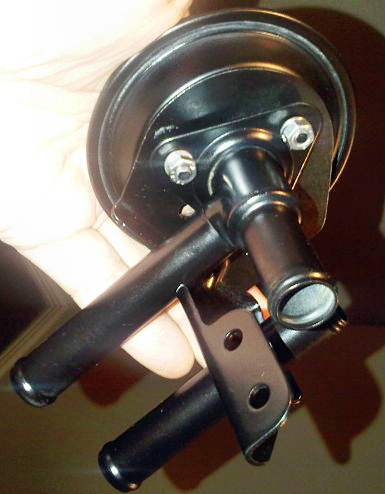

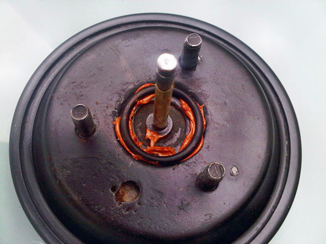

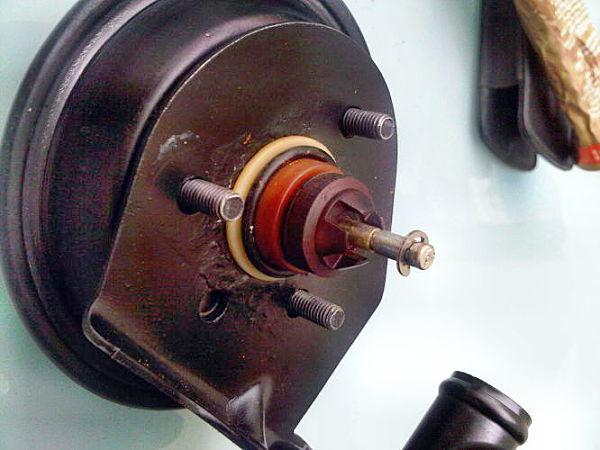

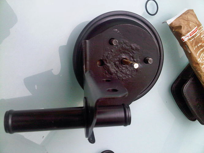

Once I had undercoated the components and enameled them black, re-assy was as follows, I set a rubber "O" ring in place at the base using some engine gasket silicon.
The following shows the re-assy process. in the last of the 3 pics you can see that I have re-fitted the base plug with it's internal components and upper copper washer, around the top of the base you will also note a new rubber "O" ring, this was the original failure point, the "O" ring closes against the seat of the feed tube, when the valve is in either the open or closed position this does the job of sealing the assy, once this goes you end up with a swimming pool in the cabin.

Final assy of the valve involves reinsertion of the retaining clips, first the main valve stop plug is put back into place and the upper clip secured, after this the copper washer is raised into position and the secondary clip applied, once this is completed, the main feeder is replaced and secured in place by 3 spring washers and nuts, I replaced these with stainless for longevity.

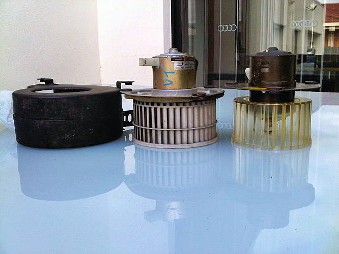

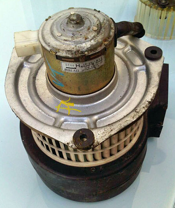

Fan Upgrade #1
OK, so went down to my local Holden wrecker today, and the news is great.

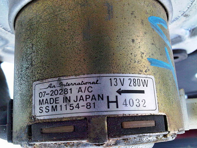

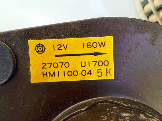

I compared my fan assy with a VT Commodore unit, this is the sealed chamber type, there is also an open chamber type, and I was 80% correct, the dimensions of the squirrel cage as far as depth are almost exact, slightly smaller, the width is about 20mm wider, and the mounting bracket just fits the outer circumference of the Zed chamber, the inlet to the chamber is going to have to be increased accordingly but this isn't a big task.
The unit from the Zed is rated at 160W (Standard is 120W however this is the Air-con version with the stronger motor), the VT item at 280W, with the increased squirrel cage size which has more than enough room inside the Zed housing and the increase in motor strength I think this is a goer and will start the conversion tomorrow.
If this works, everyone doing the conversion owes me a drink.
I will do a step by step tutorial in this thread as I go along.
John

OK, couldn't help myself, I just had to see what the alignment would be like with the motor sitting in the housing, so I took off the squirrel cage and bolted the motor using one of the ZED mounting holes as a reference, it centered up beautifully as can be seen in the pic, I then reversed the assy and lined up the removed squirrel cage with the motor shaft to see where it would sit in the housing, once again spot on for room as per the photo's below.
There is a slight problem, lets see who can pick up on it ?
And if you have don't post just keep it to yourself as I have a solution and will show it in the rest of the tutorial as I modify.
John
