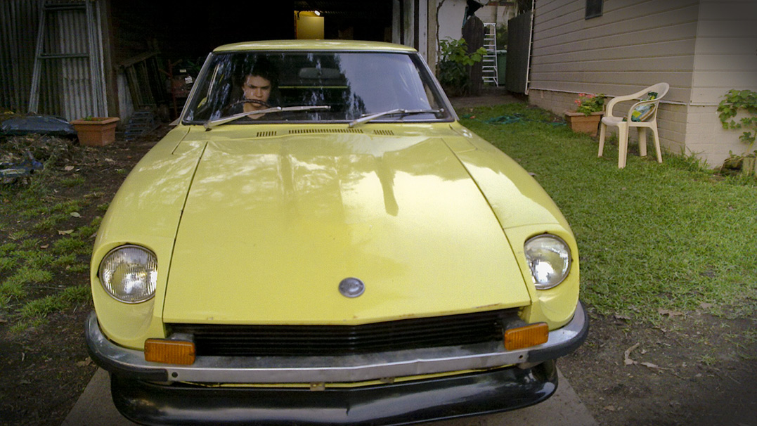

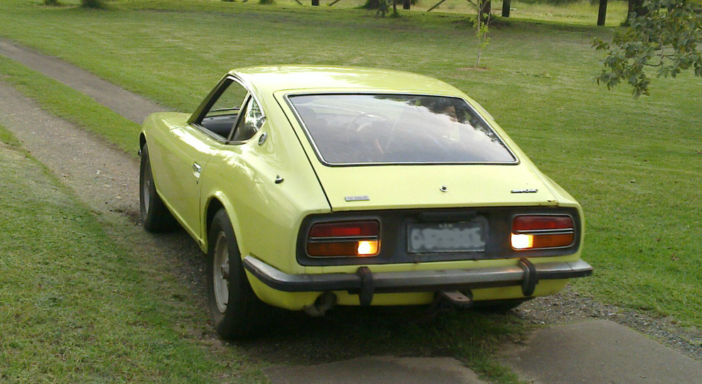

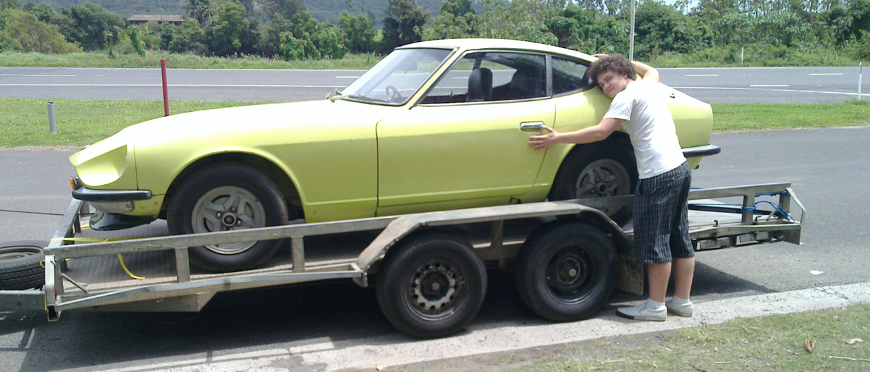

Lukas Posted March 10, 2011 Share Posted March 10, 2011 Hello everyone, I was going to start with a little bit of history on how i got into Z cars but I think i've covered that already in my 2 "I'm new here" posts so instead I'll start with when I got my 240z. After about 1 1/2 years of looking for an s30-series Z, I finally found a nice lime-green 240z for sale at a reasonable price. It was about an 8 hour drive just to get there, but we hired a car trailer and went anyway. To begin with we were a little hesitant as there was a reasonable amount of rust, but we decided it was nothing un-fixable. The interior was actually in pretty good condition apart from the seats, it ran but wasn't registered, automatic transmission worked albiet a little clunkily, no cracked glass or anything like that... So we paid for it and went on our merry way . What We've Done So Far After that we had a little bit of re-organizing the shed to do so we could fit it in (Dad also has a z31 2+0 waiting to be restored. We're sortof in a race to see who can get theirs finished first). We've started stripping it down now, front exterior is fully off but the engine is still in for the moment. Not sure if we will attempt to recondition it or just take it to a mechanic at this stage. Interior is fully out except for the dash and the centre console. Luckily the rust we've found isn't so bad. We've found that it's been resprayed in the past and there are several bits where rust has been "repaired" (Some parts dodgier than others). The only bog we've found so far is in the hatch and sill panel. otherwise it's rusty in both floor pans, back LH fender section, a little bit along the front windscreen RH corner which is concerning but hopefully only minor, battery tray, and another section towards the front of the engine bay but i'm unsure of what to call them (the front of the under-fender section?). Plans for the Future Not really sure to be honest. Aesthetically, I'm undecided on the color and on whether to get flares or not, I want to get some super wide wheels (Looking like good ol' wats at this point), definitely keeping the interior stock, and probably getting fender mirrors. Mechanically, not really much of a speed freak so keeping the l24 or going l28, refreshing the suspension but keeping it original, refresh brakes, etc etc. After reading that I suppose it sounds relatively boring, but things may change as the build progresses. Definitely won't be turning it into a track/drift car though! Questions I'm going to have a lot of these over the course of the resto but for now... 1. What do you guys do with the interior vinyl pieces during restoration to keep them safe? I've given them a quick clean with armorall, making sure to fully dry them afterwards, and now i'm thinking maybe it would be a good idea to cling-wrap them to keep any dust away from them. I'm just scared cling-wrapping them will deprive them of oxygen or something like that? I tried searching the net but couldn't find any info on this. 2. Does anyone know where to get rust repair panels for these cars? I've tried contacting the local rare-spares distributor and I was told it would be a couple of months before they could get me a LH floor pan..? 3. I've found i need to move the auto shifter back to take the center console out. Probably a stupid question but is it ok to change gear while the car is on stands? I've attached a couple of pics. Congratulations to anyone who actually read the full post! Quote Link to comment Share on other sites More sharing options...
reverendzed Posted March 10, 2011 Share Posted March 10, 2011 Hey Luke, Great write up. Your Vinyl pieces are just best stored in one of those cheap plastic white containers worth about $10 from Supa Cheap. Floor Pan you should check on ebay or get a panel shop to make you one up, Lurch who is a 'Mod' on the forum may also be able to give you some advice. Lastly yes it's fine to shift the Auto selector whilst it's on stands, while you're at it why don't you shift the whole auto out and drop in a 5 speed manual whilst you're at it!(much more fun). You will get heaps of great advice on this forum and don't forget to contribute, you may learn some stuff in your rebuild that can help us all. Cheers, Rev. Quote Link to comment Share on other sites More sharing options...
Ledge Posted March 10, 2011 Share Posted March 10, 2011 HI Luke Don't change the colour , Lime looks sweet. But I'm biased Regards Paul Quote Link to comment Share on other sites More sharing options...
Brabham Posted March 10, 2011 Share Posted March 10, 2011 Hi Luke, nice looking zed there. All Z Parts at Hornsby do zed panels which I believe are the closest to factory of the main suppliers. My advice would be to steer away from flares and fender mirrors, wherever you drill holes in your steel it may start rusting. Whereabouts are you in Sydney? Also make sure you label everything when you pull it apart and put all your fasteners in zip lock bags etc. Good luck with the resto Quote Link to comment Share on other sites More sharing options...
FuzzyDropbear Posted March 10, 2011 Share Posted March 10, 2011 ...After reading that I suppose it sounds relatively boring, ... Hi Luke, I don't think you'd find anyone on here that thinks any project featuring a Z is boring Best of luck with it, the competition with your dad sounds like a great way to keep you both motivated, friendly competition never hurts. Any idea on what you're going to do with the colour? I quite like the lime! Quote Link to comment Share on other sites More sharing options...
lightmaster240z Posted March 10, 2011 Share Posted March 10, 2011 Hi in answer to question 2 yes they are out of stock with rare spars but they told me that they were only a couple of week away? 3no problems moving it back and forward because there is no other way Bruce Quote Link to comment Share on other sites More sharing options...
Moderators Zedman240® Posted March 10, 2011 Moderators Share Posted March 10, 2011 Welcome Luke... Great to see another zed resto; they are never boring! I'm with Paul..keep the Lime! Quote Link to comment Share on other sites More sharing options...
Brabham Posted March 10, 2011 Share Posted March 10, 2011 +1 for the lime Quote Link to comment Share on other sites More sharing options...
Sirpent Posted March 10, 2011 Share Posted March 10, 2011 Hey lukas... Great intro, welcome, and that pic with you and the car "A boy and his toy" thats a keeper buddy, look back on it in years to come. All the very best with your build. Cheers John +1 Karma Quote Link to comment Share on other sites More sharing options...
Bruce Posted March 10, 2011 Share Posted March 10, 2011 Hi Luke, great write up so far, keep the progress reports coming. From the pics it looks like a pretty solid original car? while you're at it why don't you shift the whole auto out and drop in a 5 speed manual whilst you're at it!(much more fun). +1 +1 for the lime +2 all the best with it Bruce Quote Link to comment Share on other sites More sharing options...

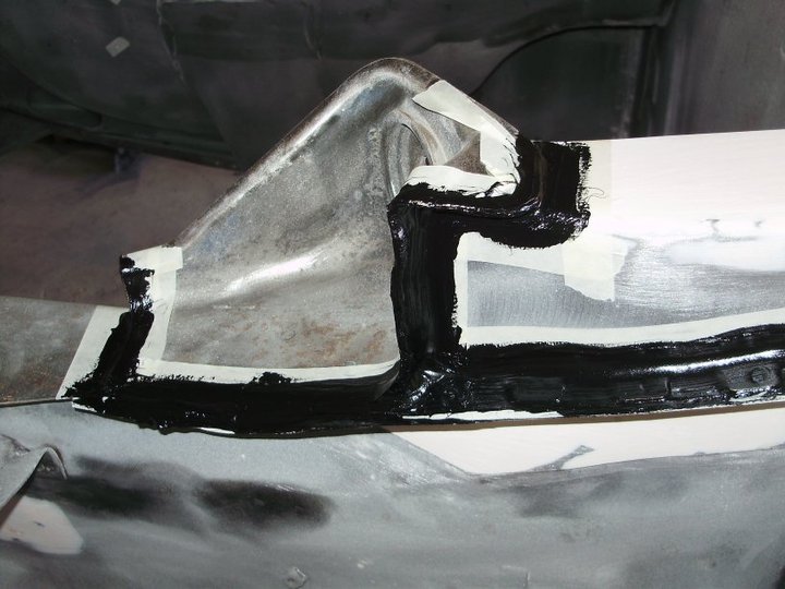

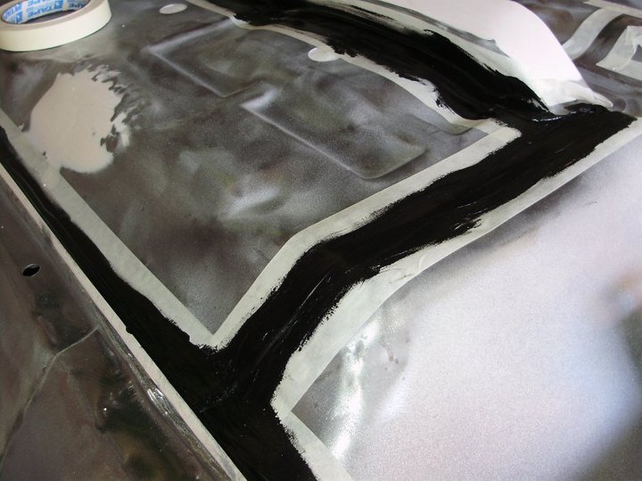

Lukas Posted October 14, 2011 Author Share Posted October 14, 2011 (edited) Hi again everyone, long time no post.Due to life in general I haven't been able to get all that much done on the zed over the past few months. I have managed to do the following: Bought LH/RH floor pans. Cut the LH floor pan out and also repaired the LH dogleg. It isn't fully welded in yet simply because we were unsure of how to seal the metal underneath. What would be better, cavity wax or something like por-15? And is it possible to seal the back of the outer panel before putting it on, or should we put a hose in there after its welded and spray some por-15? Stripped out the front suspension and have started to refresh some of the components. Haven't thrown any money at it yet, mostly just cleaning gunk of everything and recoating with por-15 or KBS where I can. I have been thinking of what I'd like to purchase though and will probably ask your opinions before it comes time to buy. (And yes dad did a dodgey job with the sandblaster at his work ) Most recently I've started stripping away all the under body seal from the front RH fender. I'm starting the think this wasn't such a good idea. It's been 99% rust free and now I'm worried whether i'm going to be able to seal it as well as the factory did? It's 99% stripped, it's just taking forever to get the last of the gunk out of seam lines and the like. Does anyone have any idea on how to get it out other than hard work? What I'm starting to realize is that even though I might look at, for example, the suspension and think "Holy shiver this is so complicated, I'm screwed", once I actually have a read and then take a crack at dismantling/fixing it, it turns out to not be so hard. It's encouraging.And, yes, of course I am putting a manual in it .Any questions, critiques, tips & comments are appreciated.Luke. Edited March 17, 2016 by Lukas Quote Link to comment Share on other sites More sharing options...
FLEXZED Posted October 14, 2011 Share Posted October 14, 2011 hey Luke well done mate, the work is looking good, we are all here if you need any help Where in nsw are you from Loui Quote Link to comment Share on other sites More sharing options...
jamo240 Posted October 15, 2011 Share Posted October 15, 2011 Hey Luke Regarding stripping body sealer, a wire brush in an angle grinder (125mm in a 5"grinder) does a fine job. You are wise beyond your years to question removing all the factory coatings and rust protection. While the early Z's had some characteristic rust areas (some of which you are now repairing), other areas lasted quite well, so it doesn't make much sense to remove the finishes that provided the protection. In the area you are now working (fender wall area), you can undercoat with primer, then spray a black body sealer over that (can be very smooth finish if you do it well), and then paint either body color if you like, or leave it black. The provides fair protection going forward. Cheers Jamo Quote Link to comment Share on other sites More sharing options...
Sirpent Posted October 15, 2011 Share Posted October 15, 2011 Nice work Lukas With the seams that you have removed the corking sealer from, simplist way to re-seal the joins is to use masking tape 2cm's either side of the join, then take a tube of Urethane and run a thick bead over the center join, after which you use a strong bristle brush and spread the urethane evenly across the joins. Do no more than a meter at a time, and remove the tape slowly bit by bit before the skin dries. afterwards etch prime the lot then go viral if you like with a stone guard finish or primer followed by color coat. As you will see in the pics of mine, you can barely see the seal lines under the finish I applied Cheers John Quote Link to comment Share on other sites More sharing options...

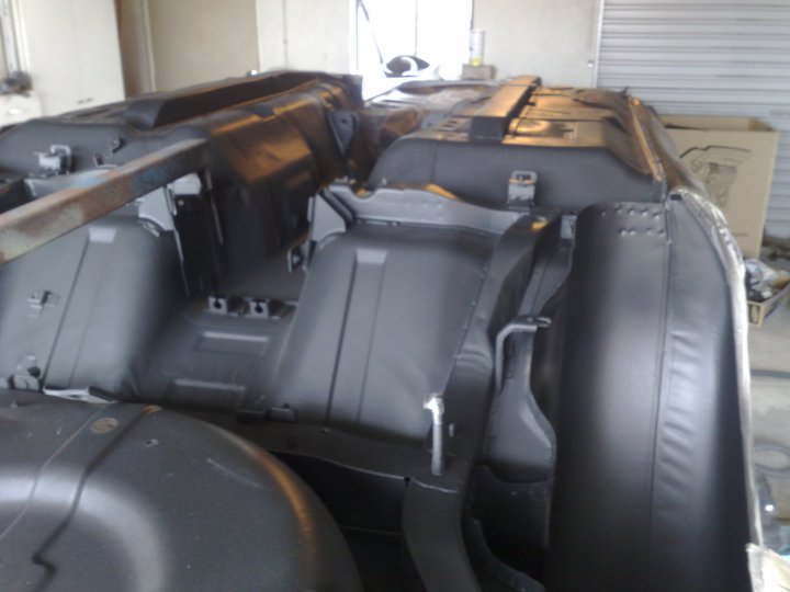

Lukas Posted June 4, 2016 Author Share Posted June 4, 2016 This is a visual follow-up post to my last. I'll let pictures do most of the talking (Though I'm lax with the picture taking as well!) Cleaned up all the suspension parts. I did all of this with a grinder... went back to bare metal. I used two different products for the final coat, but I forget the names, I think one was Rustoleum somethingorother and the other was Eastwoods... ?? One went on shiny and metallic with a slight bumpiness. The other (my preference) went on matte black with a finer, but still bumpy, texture. It was SUPER sticky for about 24 hours but seems to have dried nice and tough. I really like the finish. In hindsight, I would NOT do this with a grinder again. Sandblasting would have saved me so much time, and probably not cost much more than all the wire brushes I had to buy , not to mention do a better job. I don't have a full set of pictures but we also put new wheel bearings in, new tie rod ends, ball joints etc etc. These cleaned up parts are now packed away awaiting reassembly. Awaiting the Koni yellows and king springs Built the rotisserie from 2 engine stands. Seems to work pretty well! THENNNN..... I got a motorbike and I did a bit of work on it... As I bought it. Was in pretty rough shape. Blinkers were practically invisible in the day, speedo didn't work properly, frame not welded up properly, tank was plasti-dipped, lots of overspray. But overall I liked the style... So I made some cover plates to hide exposed wires, Dad welded the frame up, integrated the brake light better, new blinkers, grips, took the plasti dip off (was an ugly red stripe I had to get rid off underneath...), new quality speedo and tacho, yada yada: Back to the Z. With the car on a rotisserie we were able to continue finishing off the underside. Installed new floorpans and chassis rails. The chassis rails were from rarespares (came with the floor pans), bought about 4 years ago : Before spraying the stone guard I tried a technique suggested to me by a painter friend at work. I made a thread about it here and there were divided opinions but I thought I'd give it a shot. Essentially we sprayed fish oil in all panels, particularly crevices, followed by thicker Tectyl or Fergusons Knock-Out Rust, in the crevices. The plan was to let this harden well and truly before applying the stone guard... Unfortunately, I was off to Malaysia a few days afterwards and, being impatient, I wanted to see it finished. Which meant we had some problems... Namely cracking/splitting, which was to be expected as the fish oil had not hardened much at all in a day or two. I flew off to Malaysia and in a few weeks time Dad went over it again. No cracking this time, but you can still see where previous layers split. Only time will tell if this works or not. The plan is it won't see rainy days anyway, so hopefully a moot point! You can also see I have brought the stoneguard up partially into the engine bay. I saw a 510 coupe with the entire engine bay done in stone guard and didn't mind it. I think these areas can be susceptible to brake fluid leaking and generally rusting due to that? Hopefully this provides a little more protection. I would have liked a more lumpy texture to match the original stuff we decided could stay (no rust or flaking). Hard to work on it being in another country but Dad finds time where he can - he does all the welding anyway! Bonus Story: There was a super-pimped red 280zx 2+2 parked across from a friends place in Malaysia. I tried to talk to the owner but he wasn't home. It had huge wheels/flares, big exhaust, small bullet-style mirrors, paint looked schmick, super dark tint (common over here). A ferrari was parked next to it but all my attention was on the Z Luke gav240z and Sirpent 2 Quote Link to comment Share on other sites More sharing options...
