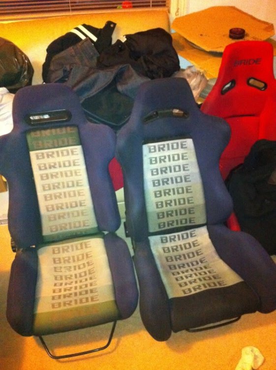

Posted 26 June 2011 - 05:47 PM
my newest acquisition.  8)
left - not sure which bride model
right - bride ergo 1
came with genuine bride ae86 rails.
any advice. would it be easier to mod the 86 rails? or unbolt and use the stock seat rails?
Posted Image
