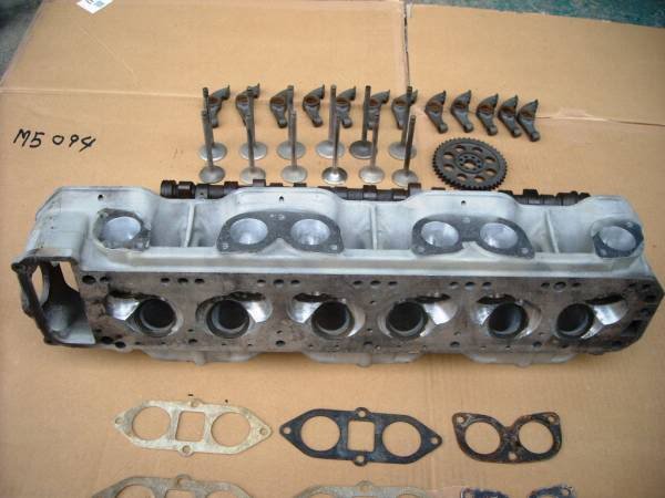

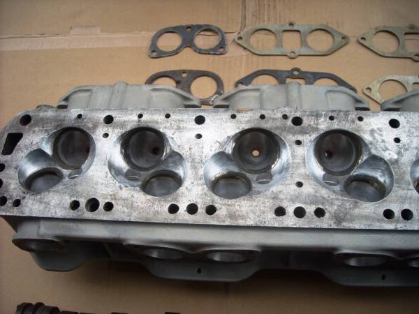

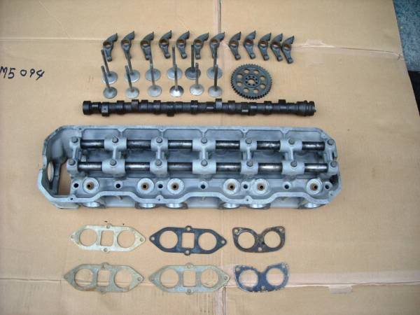

I found some pics of a real LY online - If you click the image you will redirect to the source - now if I could just my hands on one and see if kiwi-cylinder heads could remake a few.......(dreams are free - would have to get permission from Nissan I would guess as it is there IP after all)
How would you go with the TC24-B1 Twin-cam crossflow head made by O.S.Giken ?
One question I have on this is is it the same head as the LY ?

I don't get how that sprocket could fit that setup....is there only one for two cams?......or is there two? and then how would thefit next to each other.......wowser!!

The LY head was a 2 valve SOHC crossflow head.
#36 NZeder
NZeder
  • 2,292 posts
  • Location:Auckland, NZ
Posted 18 March 2011 - 06:13 PM
LY = Nissan 1970's (and early 70's at that) SOHC, 2 valves per cylinder Cross Flow FIA approved
TC24-B1 = OS Giken 1980's DOHC, 4 valves per cylinder cross flow - non FIA approved - I believe 12 made in the first batch, some more made later from different alloy = did not last. Currently 6 more getting reproduced with some improvements/modifications to the design of cam towers and like.
If you are going to remake a head an LY 100% replica would be the way to go as you can use this in classic racing/HTP/FIA group 4 or 5 replica.
