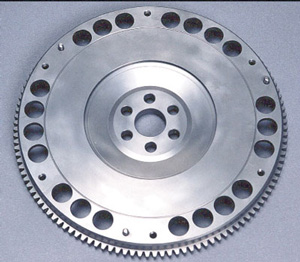

After some advice on flywheels for my new engine (L28 87.5mm pistons, heavily ported P90 with 74deg works cam) it'll be on track most of the time with little street driving. I currently have two, a stock one from SWM which has been lightened a tiny bit and I'm actually unsure of the weight but it was bloody heavy fitting it under the car  :o so say 10kg's approx. Also have another new super LIGHT flywheel 4.3kg's  ;D which I would like to put on to make the L28 more revvy.
What will be the bad side effects with the light flywheel?
I'm anticipating some riding of the clutch when it's driven on the street occaisionally.... It should rev bloody quick though, right?

My flywheel used with a Tilton 7" twin plate setup very light and very usable on the street, the best thing is the pedal is very light unlike many heavy duty setups.

:o Wowsers Ricky  :o
#8 BobsYourUncle
BobsYourUncle
  • 339 posts
  • Location:Adelaide, SA
Posted 25 February 2011 - 07:20 PM
:o Wowsers Ricky  :o
My thoughts exactly! There's not much flywheel left there...

I use exactly the one in the pic for memory its only about 8 pounds, is light tho, and does effect your idle, a high comp motor simply wants to shut down every time a compression stroke takes place, and i only run a 74 cam, at idle the motor is wanting to stop and run backwards which also creates a chattering noise in the gearbox unless you hold your foot on the clutch , oh be carefull because the engine will rev faster and higher over reving and destoying clutches is high

That flywheel looks crazy Ricky, what sort of weight is it?
It's guna be a bit more quirky to drive, will take a bit of getting used to by the sounds of things.
Did you bump up the idle speed a bit Daniel to stop it trying to stall?

small twin plates like the one above have small diameter and there weigh is close to the center line of the crank so they have less spinning mass than a single plate that has the same weight. that's why we try and take weight from the out side of the flywheel .it can take a bit more idle speed but it not a problem you can drive around it . my motor has 3.5 kg out of the crank and a super light twin plate with low comp and a cam that makes the 74works cam look like a girl and it idles at 1050

The flywheel weighs 3.5kg and the clutch weighs 3.4kg so almost 7kg all up, I use the rally disks which are thicker and don’t mind being slipped that is until they are hot then it’s very aggressive.
I have done 3 seasons on this setup and it has no measureable wear on the disks, the flywheel was CNC’ed from billet 4340 steel and the original ring gear tig welded onto a lip machined in to fingers.
The engine is happy to idle around 800 but is easy to stall as there is little momentum, when racing I always make my starts with plenty of rev's up rather than risk a stall.
