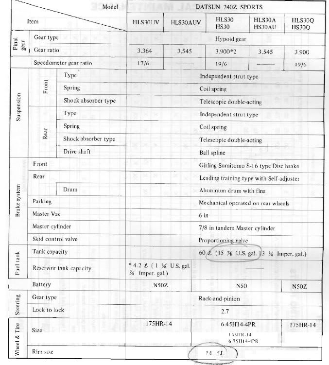

Most Z entrants do run with 7 inch rims as the scrtineers don't normally pick this up (ie they assume original wheel size was 5 inch - but I do run 6.5 myslef to comply).
Interesting, just dug up the Nissan service manuals for the 1972 S30 and it says that the wheels were 14 x 5 J in all variants / markets.  This contradicts the haynes manual and wiki and is I would think a more reputable source.  Means that my 7" wheels should be OK after all.
Roger

Looks like I'll have to update my rims......... Makes you wonder then where all the other references get the 4.5in rim size from - the earlier models must have come with 4.5 in? I agree however that if you are ever questioned at scrutineering they won't be able to argue against the Nissan manual!
