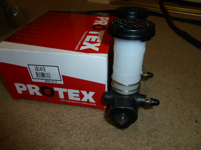

I thought I saw a pic of a JB1419 master on the forum (maybe yours Gareth?) and the bleed nipple was on the outside near the strut towers but the one I just bought has them on the other side?

#17 benny
benny
  • 1,733 posts
Posted 12 February 2011 - 05:37 PM
hey mossy IIRC gongz? bought one from the U.S recently hence the bleeds are opposite!!
#18 mossy
mossy
  • 1,777 posts
  • Location:Melbourne
Posted 12 February 2011 - 06:17 PM
Ah ok thanks Benny, that must mean my one if for an Aus model.

bleed nipples on my JB1419 are on the LH (inside) also.
