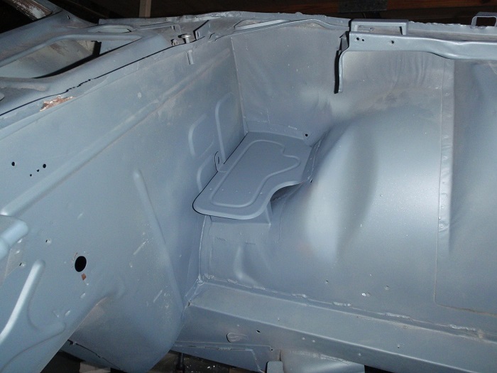

On to the floor, following on from the battery firewal area.  The floor was generally not in too bad condition, especially toward the seat mounts.  But the front of the floor had rust holes in it.  Also the repair at the end of the frame rail was again poorly executed and showing signs of rust.  So out it all came.
New floor went in along with the Bad Dog rails (which hopefully won't rust now, given a lovely coating of POR15 on the inside).  Anyhow, finished that on the weekend.  Again, not as pristine as I hoped, but it needed some beating to get into place and align with the seat rails.

When doing the battery firewall area I had to remake the battery tray.  The original one was about 85% rusted away to nothing, and so previous body works had simply tacked on a flat piece of sheet.  My intent here was to remake a battery tray similar to the original.  Again, I'm no panel expert, so after a few failed attempts I gave up and ended up with the one below.  Realising that you'd never be able to paint underneath (since the tray was solid), I gave it a customary treatment of POR15 and seam sealer.  So hopefully there will never be any problems here (at least for a number of years!).

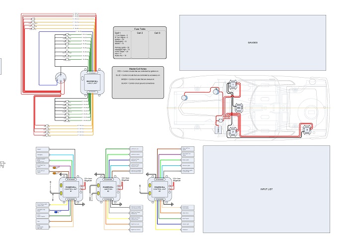

great work skipz... love the professional wiring diagrams etc... (resolution is unforunately lost in .jpg format)... I am looking forward to hearing how this all went together for you...

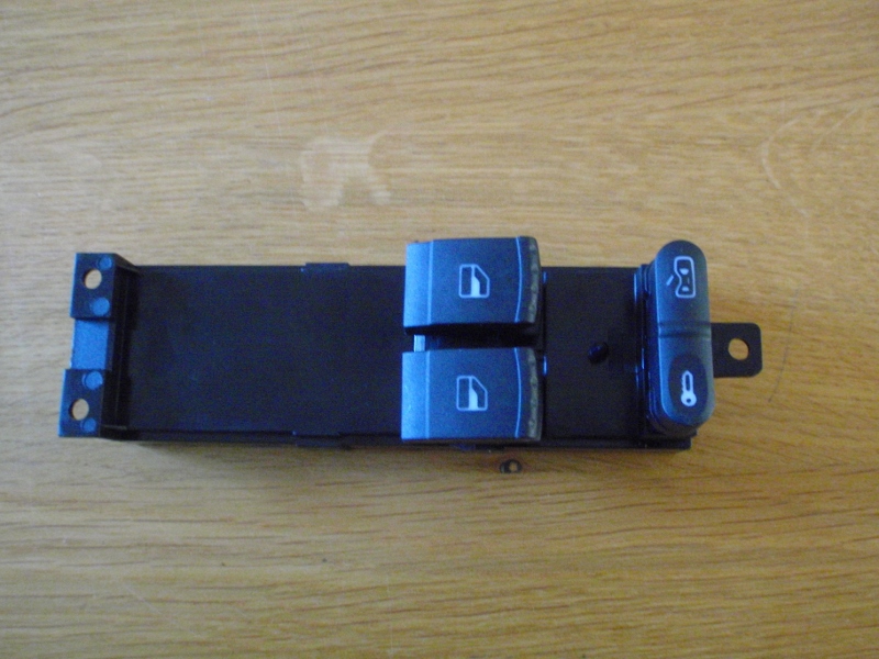

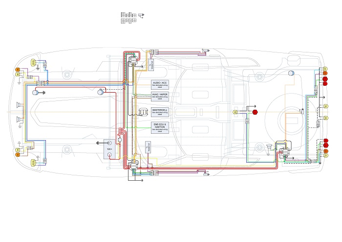

Quick update - I've just placed an order for the ISIS system.  Jay was good to deal with and most of what I was after could be achieved.  So some of the features are:
+ ISIS provides security via the remote key fob.  Doors will lock, windows will go up and ignition and EMS is locked once security is activated.
+ power windows have the option of express down (i.e. one push full down).
+ power door locks, and power window control with current limiting
+ Interior foot well likes come slowly fade once doors are closed = theatre dimming ooOOoo
+ Recirc / Fresh Air actuator control tied in with the vintage air system
+ low battery cut out switch with automatic monitoring (I'll always be able to start the car if the battery gets worn down by lights etc)
+ in cabin piezo siren if security is on and doors or trunk opens.  (i.e. deafen thief if they try anything)
+ the key fob can (potentially) control any of it.  I'll be able to put up/down the windows remotely, turn the headlights on, honk the horn etc etc, all remotely.  toys!
Wiring diagrams are still being refined, but here's a link for anyone interested. [size=78%]https://drive.google...dit?usp=sharing[/size]

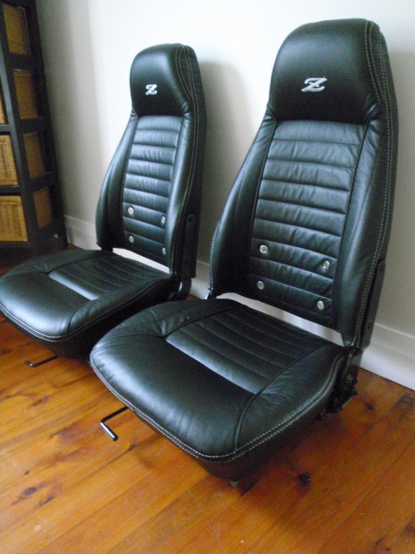

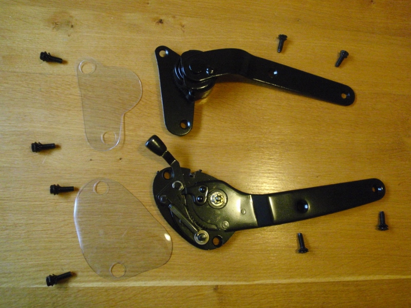

Seats have been recovered with new foam and leather.  As usual, all parts completely stripped down, wire brushed and painted.

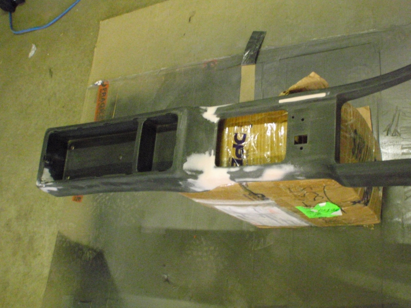

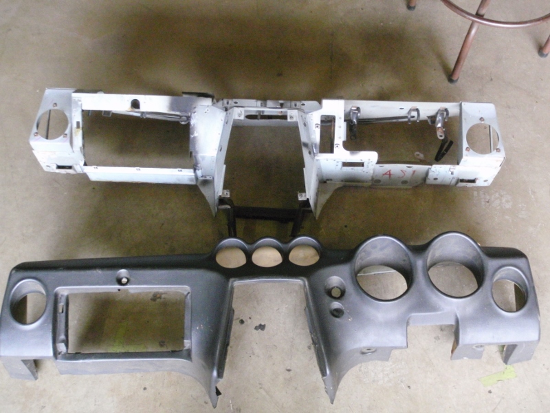

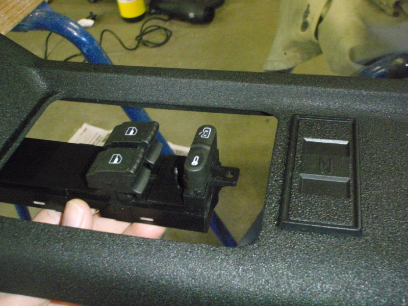

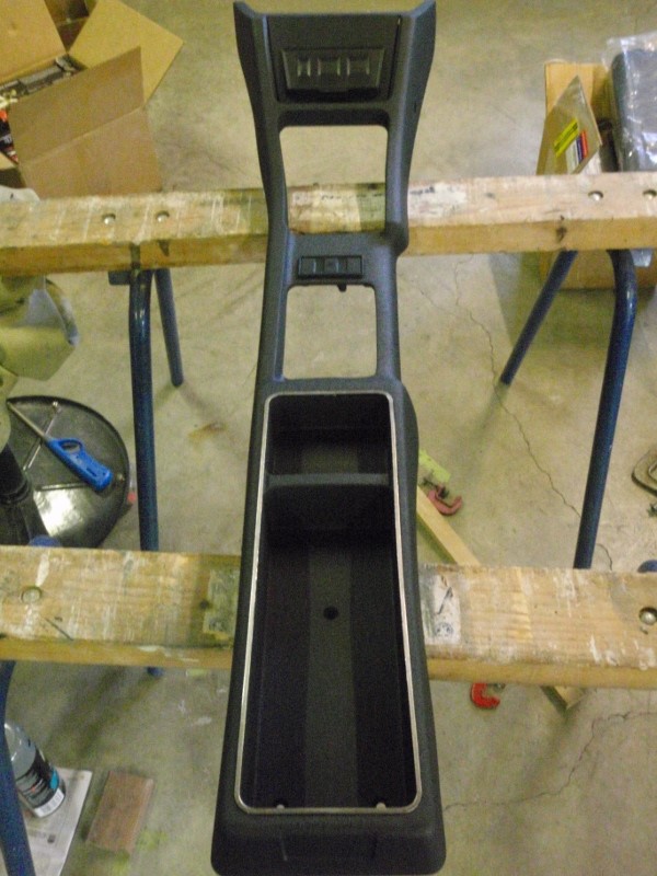

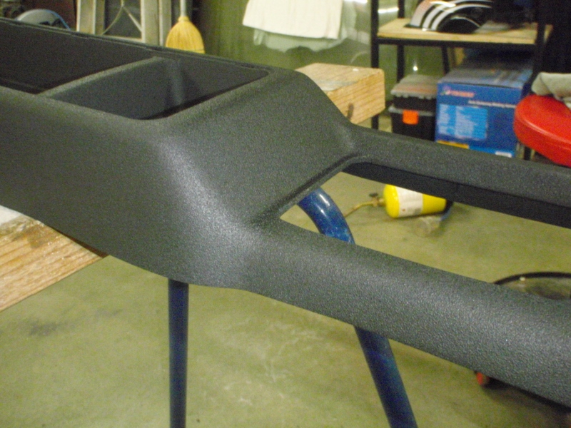

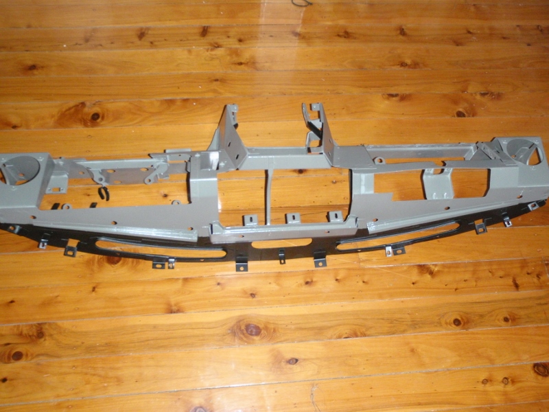

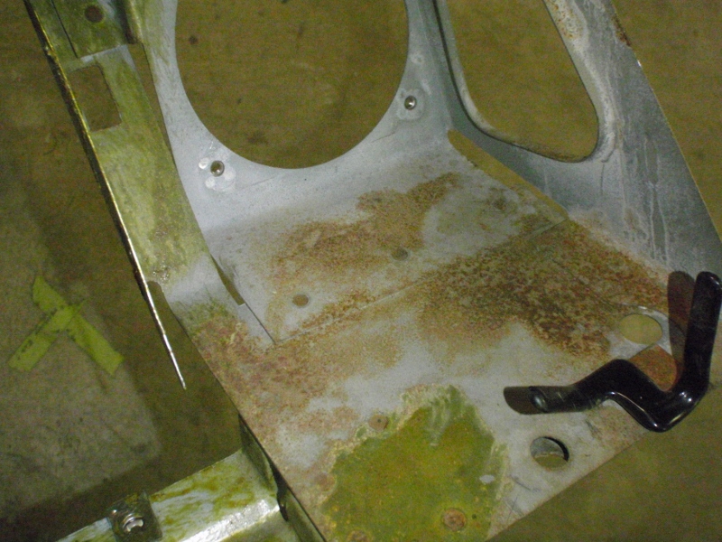

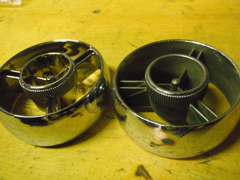

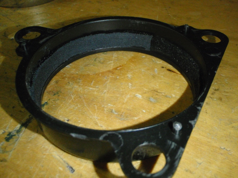

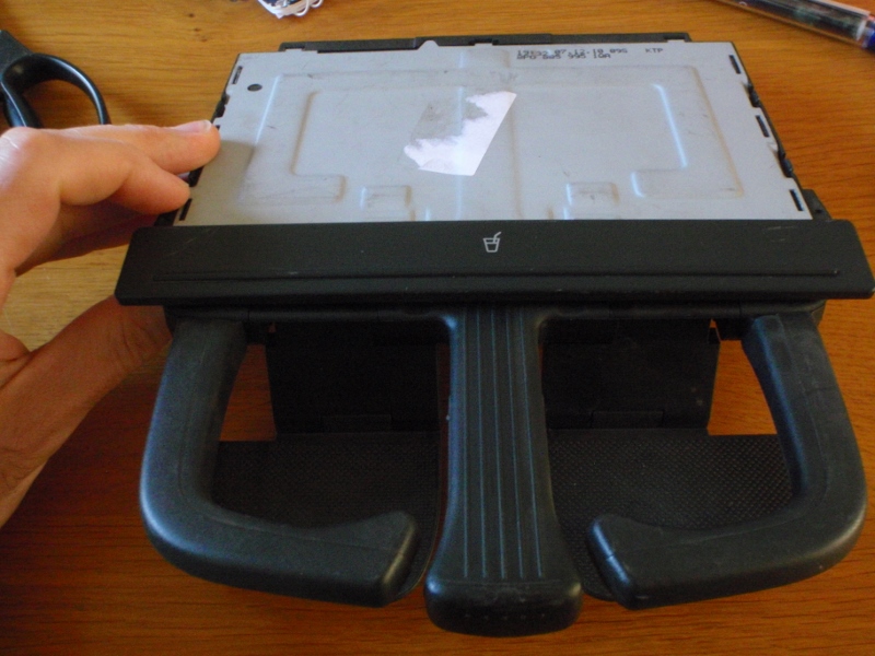

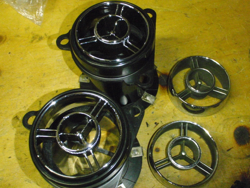

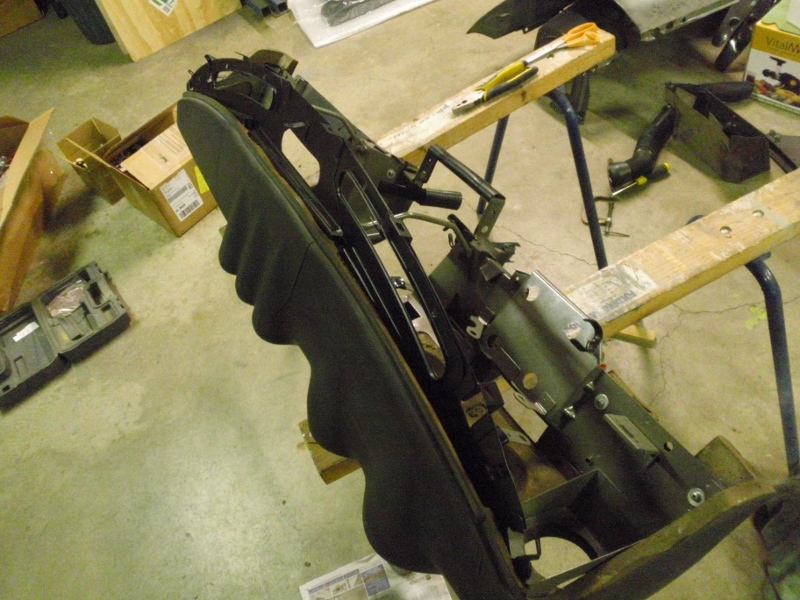

Since the seats are done I've started on the dash tear down and rebuild.  Thought I'd post some pics of the dash end vent redo - the install of the z store's end vent reproduction pieces.  I tried to clean up the originals but they just would not get back their luster. You can separate the housings holding the end vents by gently prying them apart - I used a steel rule and light persuasion.  The outer cases are held in with three plastic welds.  You end up cracking those at the weld but retain the posts that align the two pieces together.  I was surprised at how good the original inner felt looked after removing 40 years of dust.  However, putting in the new end vents, they were a little loose.  So I glued in a small sliver of really thin t-shirt material.  Tightened those vents right up - perhaps a bit tight, but much better than having them loose and not holding position.

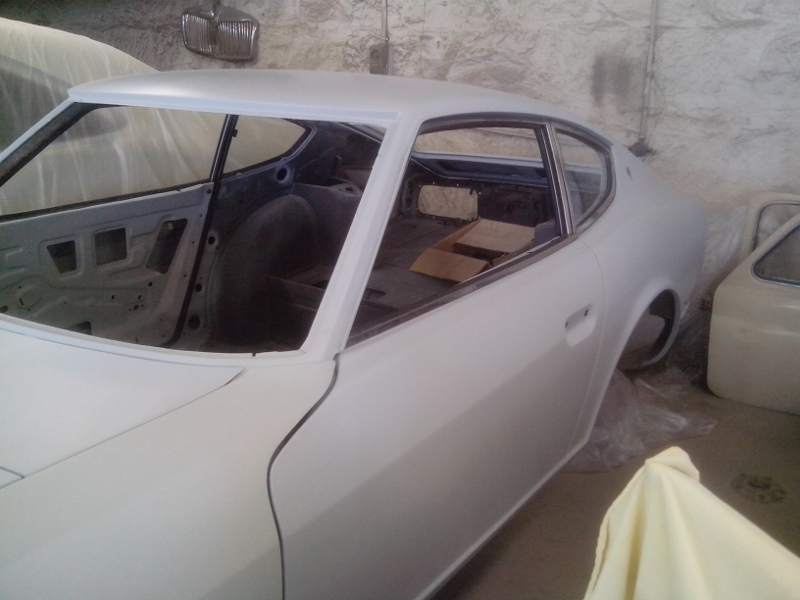

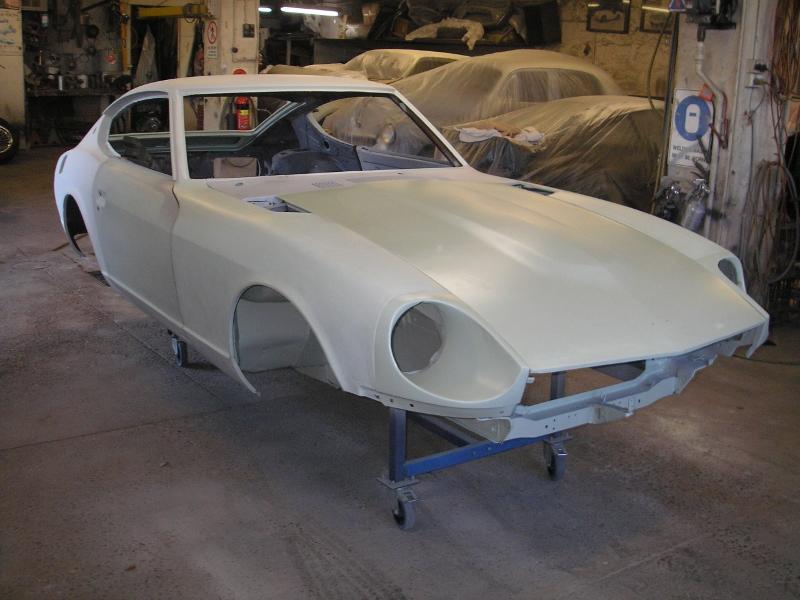

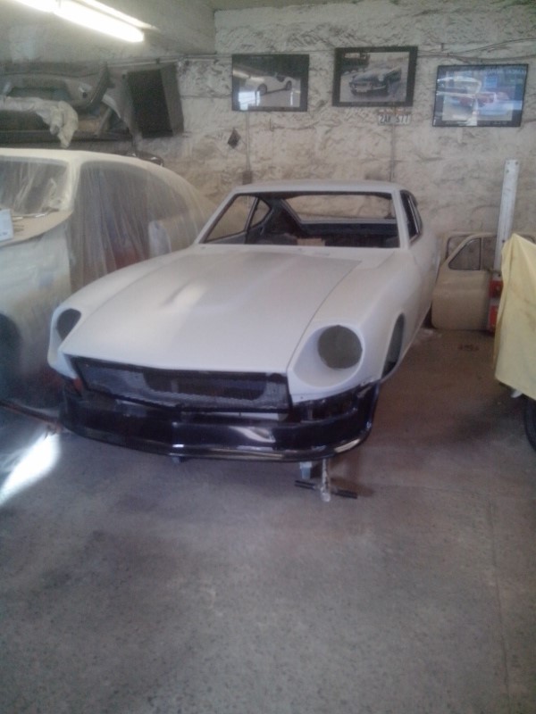

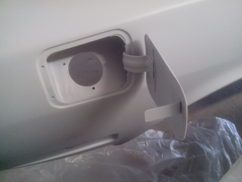

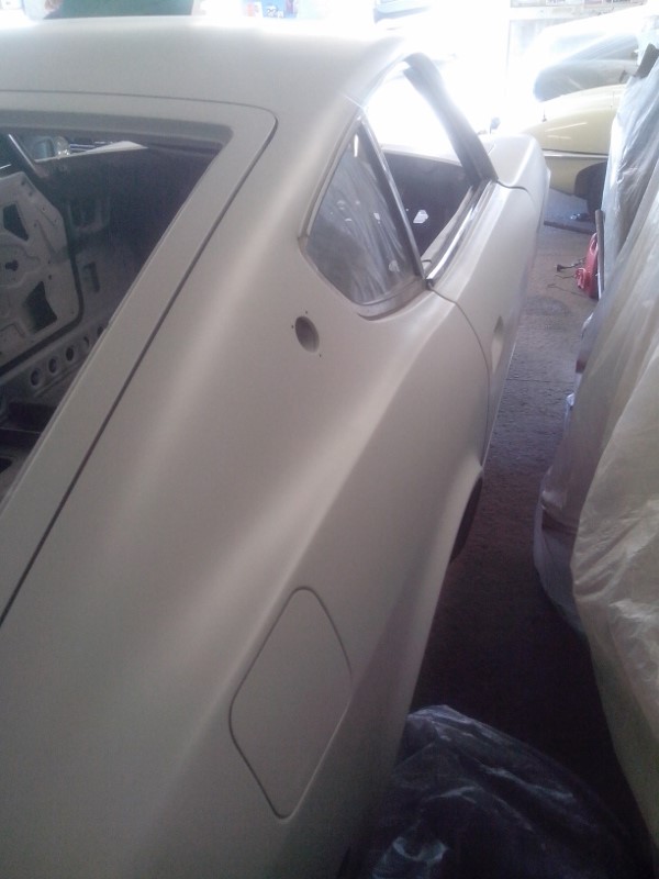

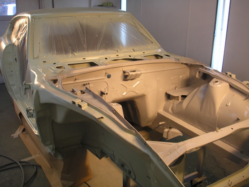

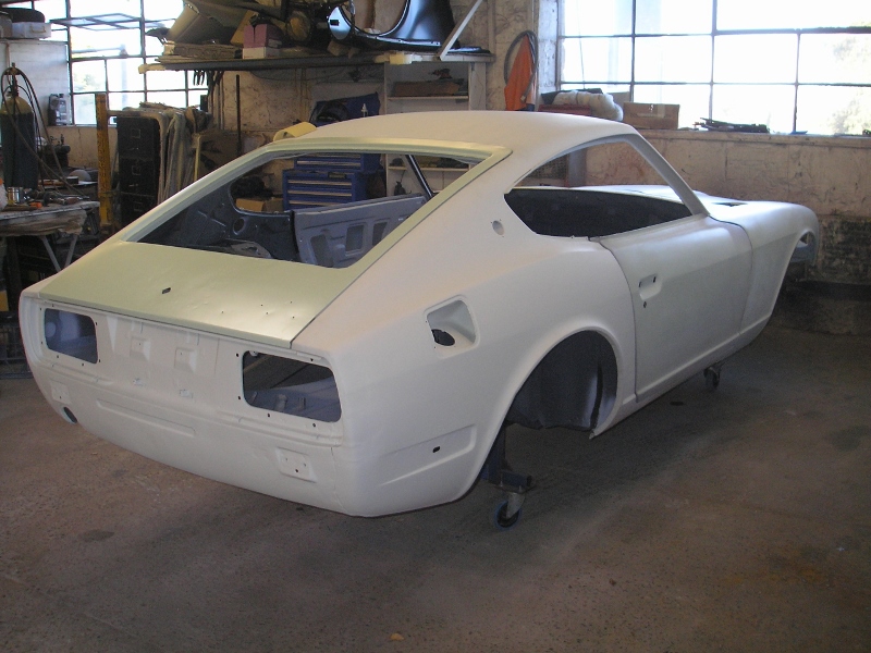

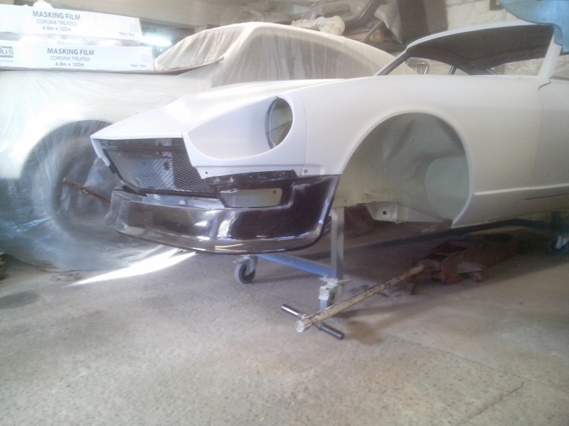

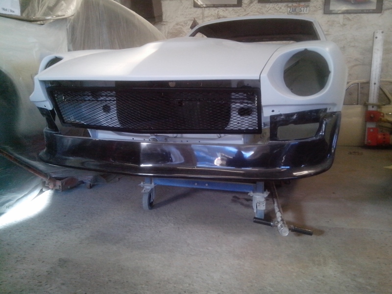

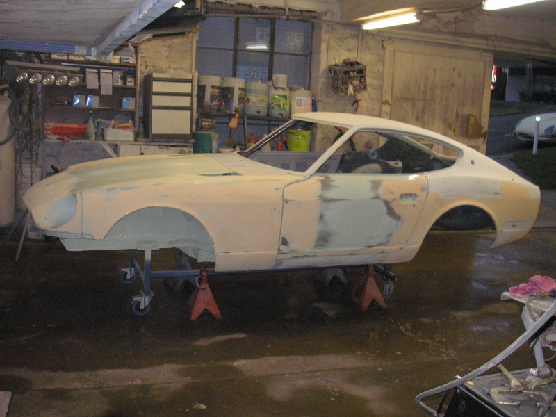

I went to see Nat today and check on body progress.  Things are really progressing quickly.  All panels are in, primed and smoothing is underway.  We also mock fitted the flares.  I like the look yet am quite torn as to cutting the guards.  We discussed ways to neatly put the flares on, and what alternate options (e.g. metal flares) would be.  I've still yet to make a decision on whether or not to put on the flares.

I guess if you change your mind on flares you can always put standard guards back in. There is reproduction rear wheel arch panels and fronts can be changed easily. Just paint then so depends on how easy your colour will be to match.
#39 skipz
skipz
  • 114 posts
  • Location:Sydney
Posted 08 June 2014 - 10:51 AM

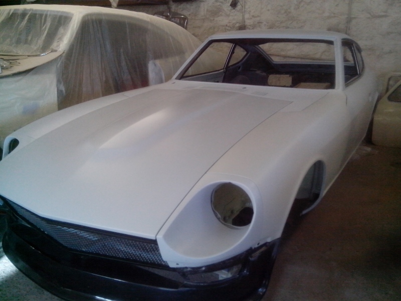

Yeah its six of one, half a dozen the other really.  Its an emotive decision you justify one way or the other.
A) Flares on now - additional $ for where Nat is currently.  Potentially wish to go back to original at a later date.  Bit of cutting, welding, and paint to re-graft the original arches.
B) Flares later - no additional $ now.  Get to run the car with original flares, potentially desire flares later.  Bit of cutting, welding and paint to put the flares on.  Probably an easier graft job than the alternate option.
B) is the safer and cheaper long term option (i.e. you don't spend twice). The width of the wheels with flares is not necessary for what I'm doing - But A) gives the look.
The car will likely end up looking like either one of these two.  I'll undoubtedly debate this with myself for a bit longer... :-\
