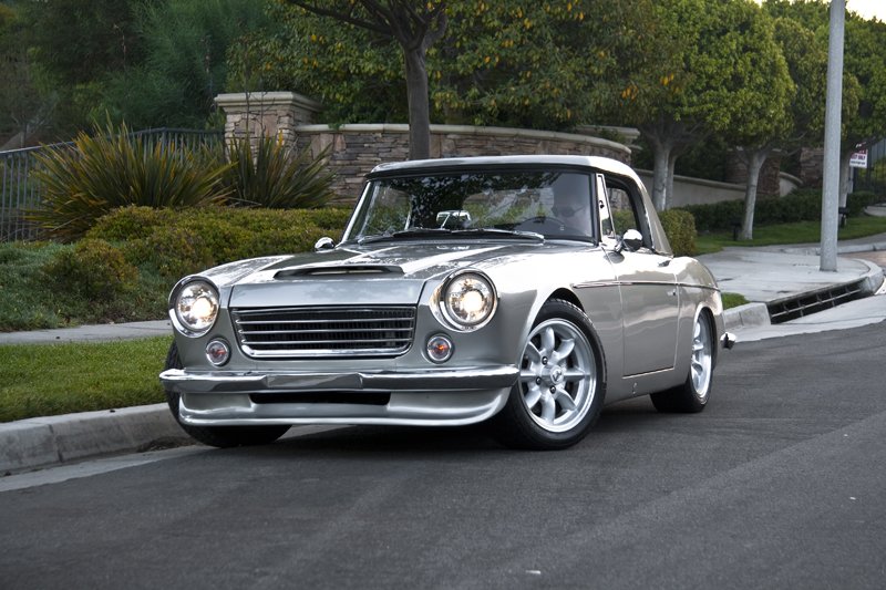

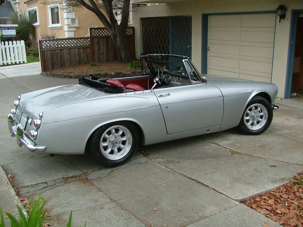

I've always wanted a silver one though :) here are some cool examples I found on the web.
http://bringatrailer...atsun-roadster/
http://bringatrailer...-2000-roadster/
Posted Image
Posted Image
Posted Image
Posted Image
Posted Image

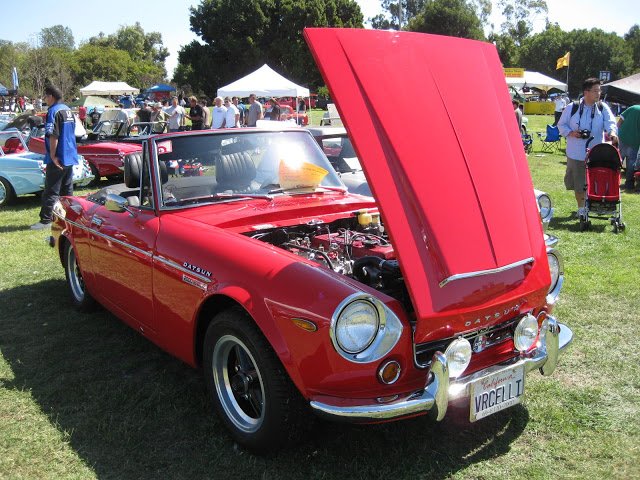

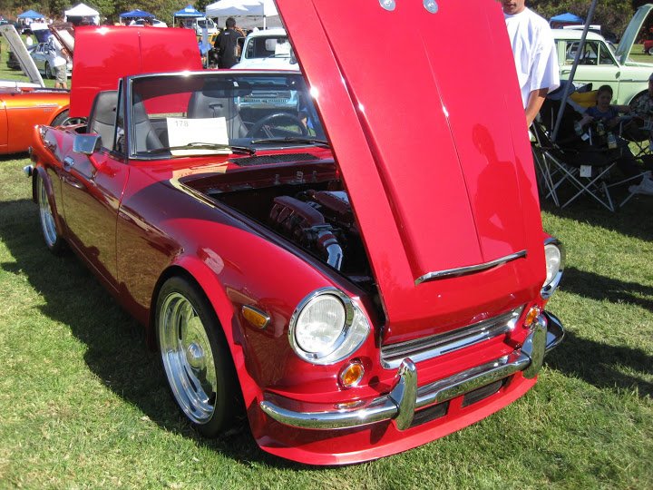

Posted 17 October 2010 - 12:45 AM
I don't usually like the Roadsters, but this one has definatly caught my eye...
Posted Image

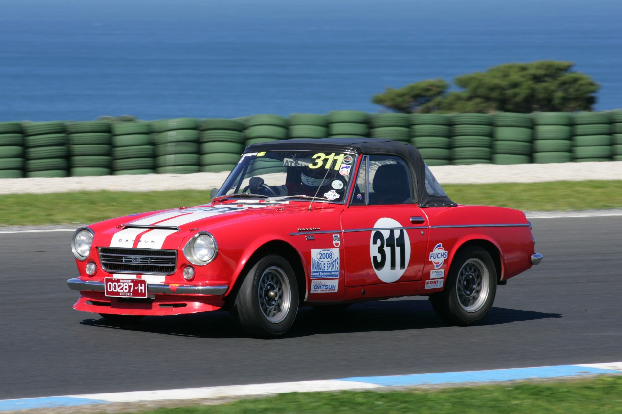

Gav
I have owned and raced my 2000 for the past 13 years.
A few basics
As with 240s, Roaders are prone to rust so check the sills and floors and firewall.
Brakes work well (when rebuilt correctly) although un boosted............be careful of boosters added as these upset bias and reduce peddle feel.
As the guys have said the body is bolted to a ladder frame chassis so its engine and gearbox out in one unit via the bonnet .
Bodies are liable to cracking across the boot lid corners and the transmission tunnel up through the scuttle due to body flex, boot floors also crack due to the weight of the fuel tank...............so check these areas.
Pre 69 models had a worm and peg steering box with worms gears subject to wear.................so check vague steering if it is an early 2000 or a 1600.69-70 models have recirc ball steering so not as direct but not as prone to wear. Drag links and idle boxes do also wear so check for steering play.
A healthy 1600 R series engine will turn arpound 75- 80 rwkw and a good 2000 approx 95 -100 rwkw so performance is very different (go for a 2000 if you can find one)
The only shared components between a Sports 2000 and a 240z are the locks, door handles and the flange type gear box (in a shorter housing) and the rear brake drums.
The U series engine is similar to the H Engine (Urvan and forlifts) however the cylinder head is where the power is made, U series engine components can be very costly and hard to find  (water pumps, pistons, timing gear including tensions chains and spockets etc
Body panels here is Oz are very scarce and expensive, particularly grills and bumpers (2000 grills sell for $400+ USD)
I do not believe they sold Roadsters in the UK/Ireland so I can only assume any over there are Jap or US imports
Any further questions let me know
Alan

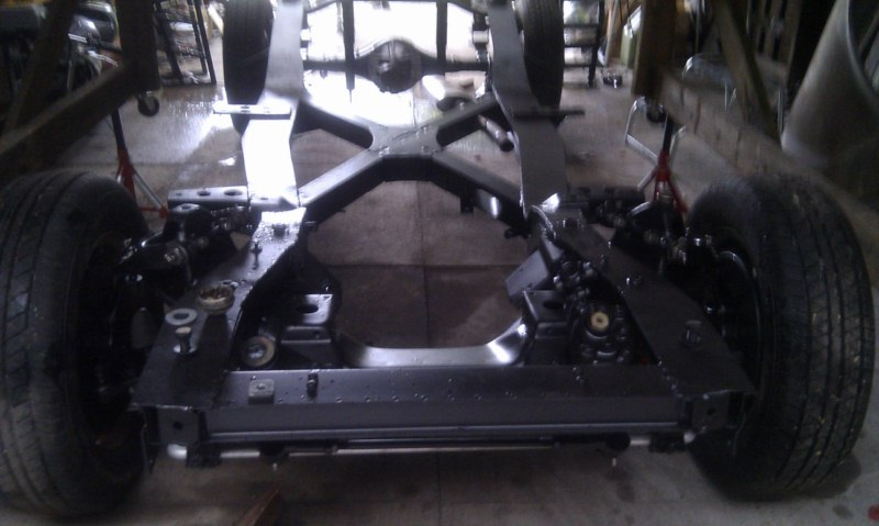

Go for it Gavin, i have a -66 1600 roadster, if there's anything you like to know about roadsters, shoot me a mail.
The silver roadster, belong to Eddie Wu, SR20 powered, let me see if i can dig up some more and post it here.
The goal i'm aiming for with my build is on the first photo below, the other photo is my frame at this stage.
Chris
