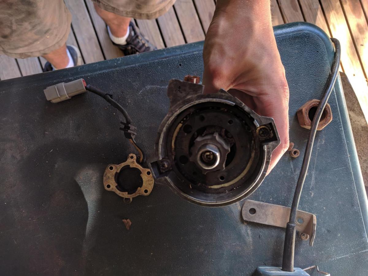

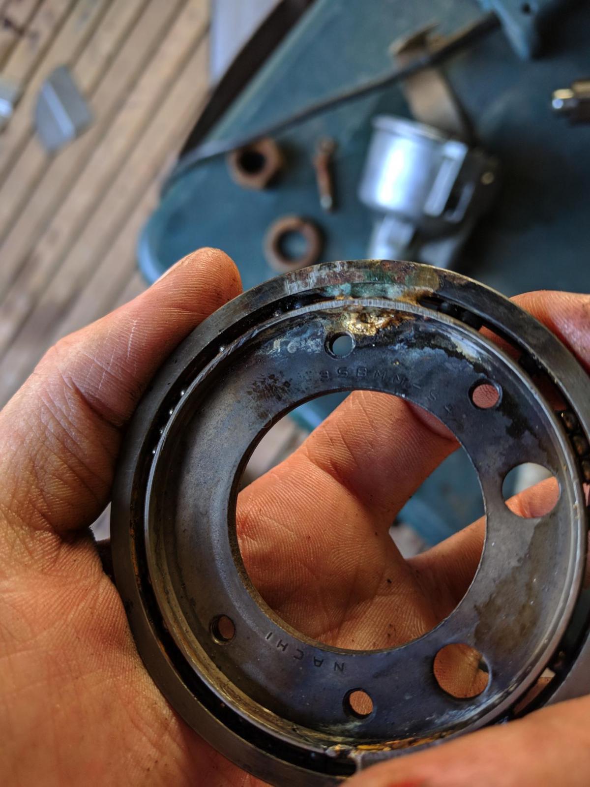

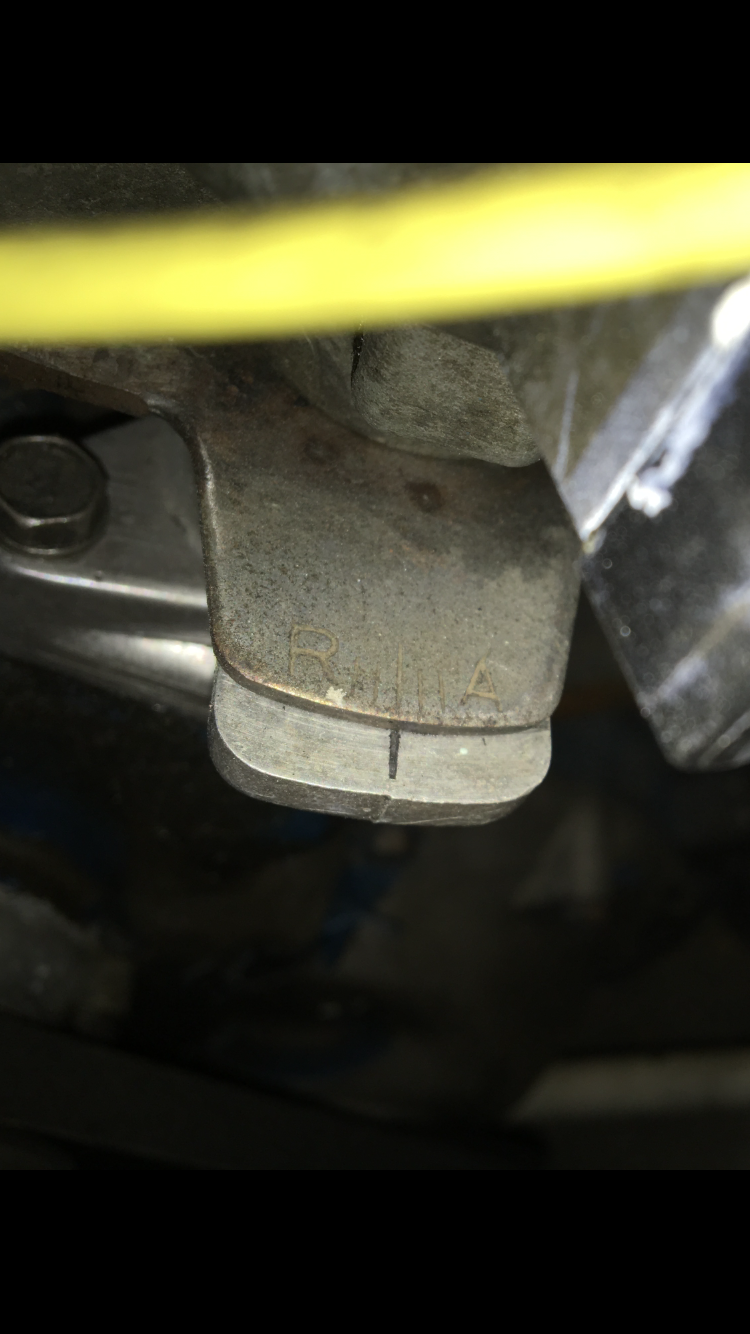

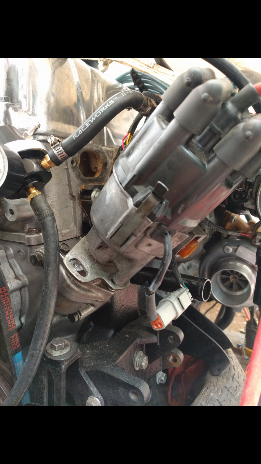

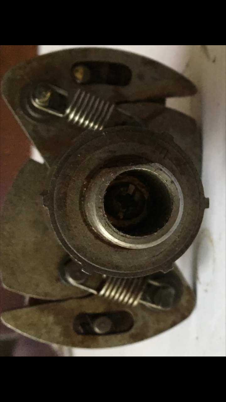

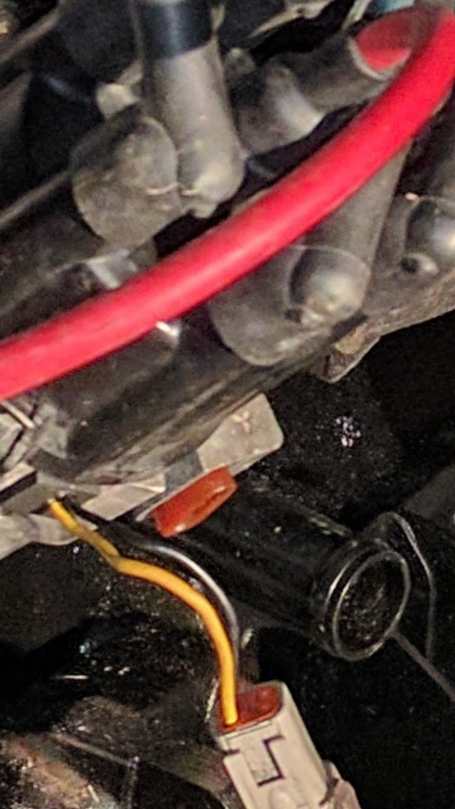

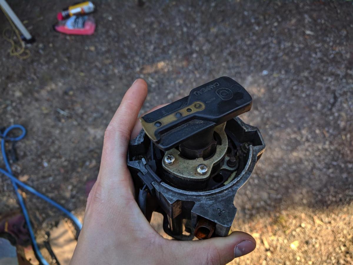

Just some photos of the Mitsubishi distributor pulled apart for those who have one or interested in them compared with the "usual" models.

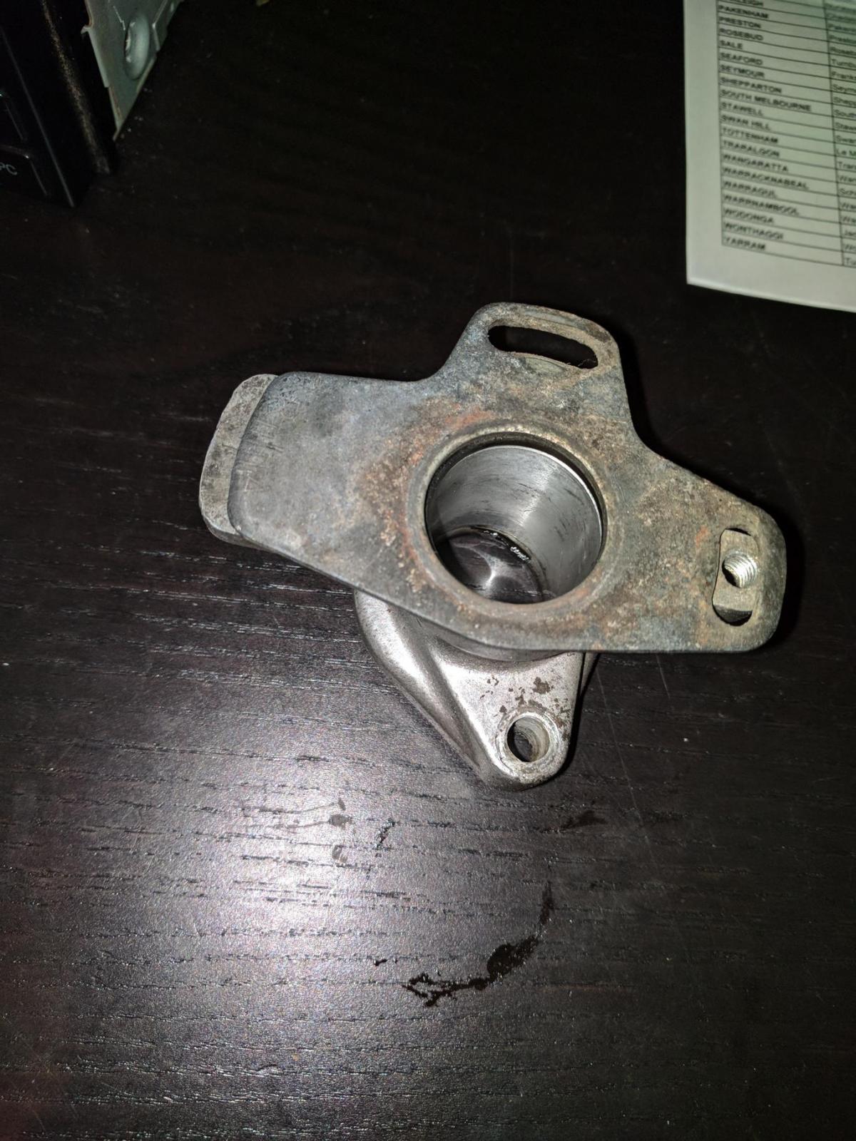

Hi Roady,
I'm fitting it for the first time and I haven't been able to find where 0 degrees is as the base plate has been re-drilled to enable this distributor to mount.  (I have ordered a timing light but it hasn't arrived) The mechanical advance has been disabled on it and the timing is controlled through the custom ECU. I'm also unsure if the positioning of the hall effect sensor inside the unit is correct as it is able to be moved around since the mechanical advance was removed.
The model of this one is:
T4T80172 C4
22100 Y4111
Here is a photo of the Mitsubishi distributor with the adjustment plate and base that it came with (the hole on the right has been re-drilled to allow it to mount to the base.
This is the base and adjustment plate that was fitted to the motor originally with a d609-56a distributor
As you can see the two bases are the same whereas the adjustment plates are different. I reckon that the person originally using this distributor didn't get the base with it so they used a standard l26 base. I also believe that to get it to mount correctly and have the timing set properly they would have had the oil pump shaft turned in a different orientation than normal. Not sure though?

Very interesting. I'll have a proper look at mine today for you. I'm sure you saw earlier in this post what the inside of mine looked like. I'll get back to you re- the base plate but from memory mine looks just like the second one you posted, where a marker points to the advance adjustment
