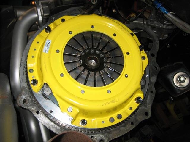

Posted Image
Yeah the whole assembly (yellow bit in the picture) so from the flywheel to 'fingers' on the pressure plate.
Should clarify that it is the whole pressure plate that is thicker, not sure about the actual clutch disc. I'll modify the previous posts so it's a bit more accurate.
