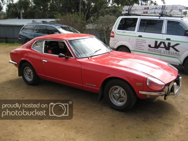

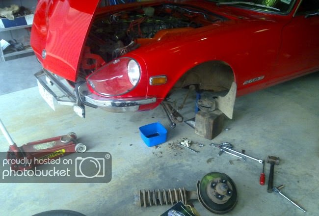

C.A.R. Posted August 21, 2010 Share Posted August 21, 2010 Most people who attended the Workshop day at my place would have noticed this 2+2 arrive mid morning: Peter is a work colluge of my brother's & has been after a project car for a little while now, & after trawling the net, like so many, loved the styling of the Zeds. He asked my Brother if he knew anyhing about them, to whit my little bro said: "Mate, my older Bro is a Zed nut! Just ask him!". After a quick yack with me, Peter was on the hunt... This particular 2+2 was on CarSales for months with very little interest & being close enough to home, all 3 of us went down one night to inspect it. I gave the 'two thumbs up' & Pete laid down a deposit. He picked it up a week later - the morning of the Workshop. Pete then took it in for a RW inspection a week later - which it failed - but only for silly shiver that the numptys at Kmart Auto decided to pick on... (We'll be using another RW inspector now, BTW). Anyway, a few new bushes, rubbers and hoses have been fitted, & I'm now just fixing up the minor rust in the rear 1/4 panel & spare wheel well. Tankfully the horrible spotlights & front bumper have been removed, replaced with an original unit (Thanks Dimitri!). Replaceing all the bushes & rubbers in the front end: More photos when the weather improves... Quote Link to comment Share on other sites More sharing options...

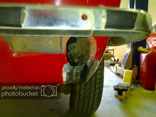

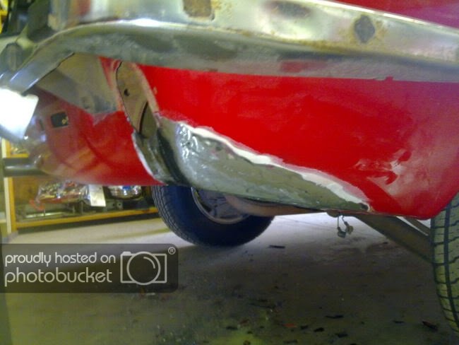

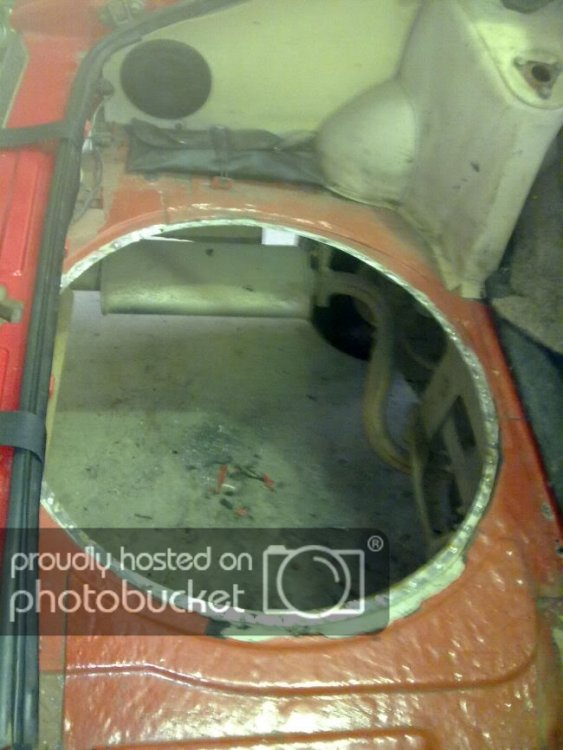

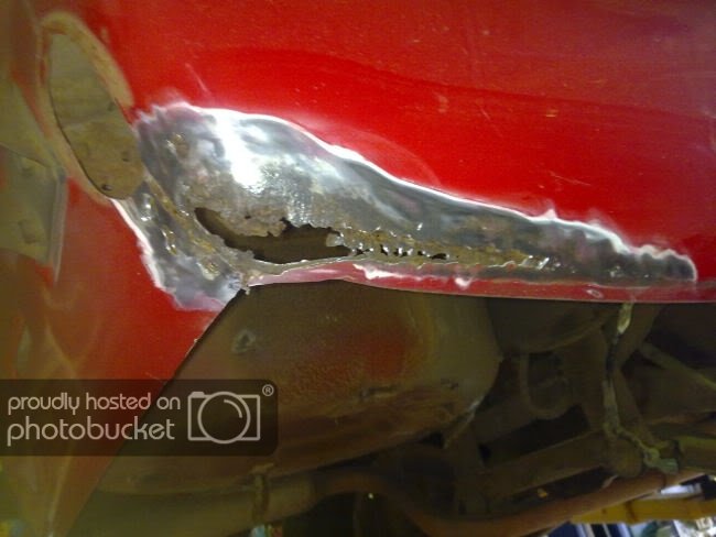

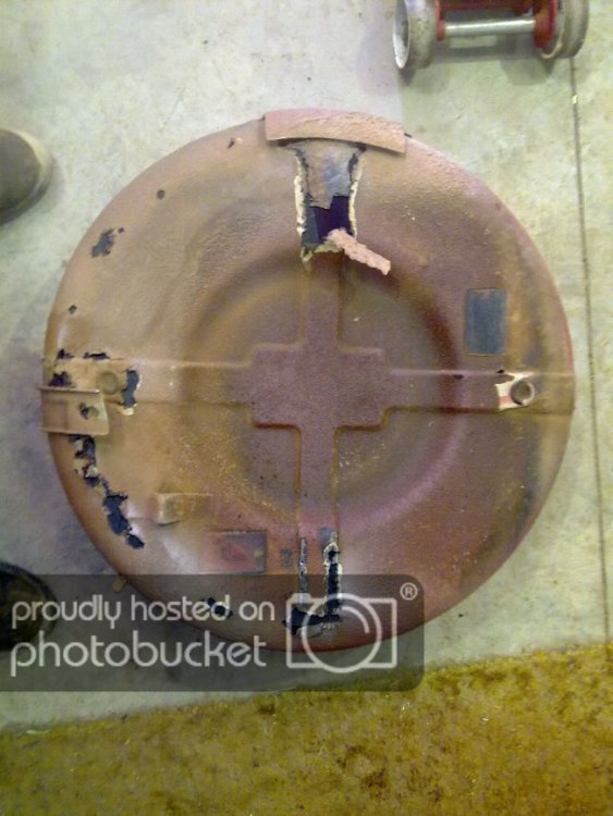

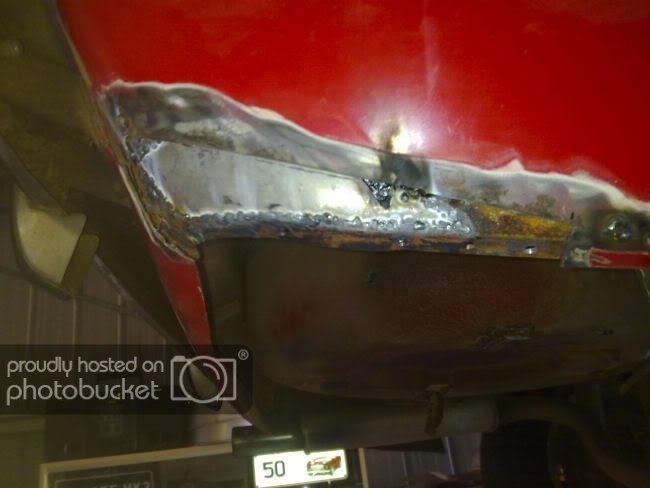

C.A.R. Posted August 27, 2010 Author Share Posted August 27, 2010 Cheers guys Well we are half way though the rust repairs. The RHS rear 1/4 was gone (outer & inner), so I hand formed some new panels & replaced them both. Inner panel welded into place: And the fiinished outer: (About 4hrs hand beating the new rear outer replacement panel! ) Next up I found the spare wheel well was badly bodged with Fibre Glass around the bottom, so seeing as I have a good 'well' in the spare parts car I decided it was more econonically viable to unpick the old w/well & weld in the good 2nd hand one. So I set Peter to work & he drilled out the old w/well: Hopefully I'll get the new w/well welded in next week... Stay tuned Quote Link to comment Share on other sites More sharing options...
