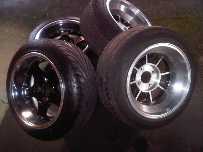

Posted 13 September 2010 - 07:52 PM
not the greatest fotos to see the stretch but sort of gives you an idea
Posted Image
Posted Image

#15 620Z
620Z
  • 1,710 posts
Posted 14 September 2010 - 10:04 AM
That photo ofg the tyre on the over sized rim looks shite house. Why the hell would you do that?
#16 aidannn
aidannn
  • 141 posts
  • Location:Sydney
  • Tagline:New Member
Posted 14 September 2010 - 01:45 PM
if youre talking about the 175 on the 10" then > to assist in fitment of the wheels.
if youre talking about mine then i bought them like that.
