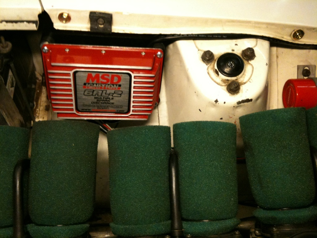

I ran the NEW PROCOMP 6A / CSI - CDI IGNITION ( 6AL) I brought of eaby for $150 with a 280zx dissy and triple webers, was perfect..
http://cgi.ebay.com....0#ht_3411wt_930
Posted Image

After 3 years it's still working perfect, Never had a problem with it..
I don't get what your trying to say, shouldn't it be mounted there, It's never missed a beat.
But the Zed's gone now to it's new owner and still going strong.
