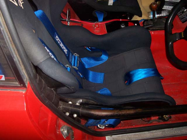

I have just ordered a pair of Cobra Daytona 2 recline-able seats for my 260Z. They are light as a feather, comfy, good support and look good too.
$699 each for nylon or $899 for Black Rock finish (more durable) from Revolution Racegear.
Not sure about fitment in a car with a roll cage though.

Hey Roberto, Recliners are no good for me as they aren't FIA approved, for a road car tho, they look fantastic!
