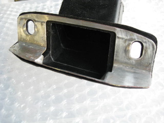

Folks, sorry for late photos but here they are of original re-inforcing plate and factory adjustment shims for the hatch hinges. If you have some re-inforcing plates and want to use them chances are they'll be bent and twisted so carefully straighten them back to original shape ensuing that the narrow bottom section provides just enough pressure on the bottom lip of the hinge boot to push it against the opening in the body shell. With a coating of sealant as well, moisture can't get past

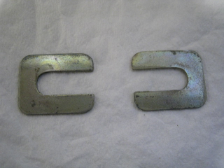

The factory shims were fitted in between the re-inforcing plate and the hinge, metal to metal both sides, that's important. They would have been made in different thicknesses to get the hatch door gaps around the door to comply with the factory specs and to get the door catch to freely lock. So if your door is not fitting right, it probably needs those shims, should be easy to knock some up after you calculate the adjustment required, then select some steel the same thickness
